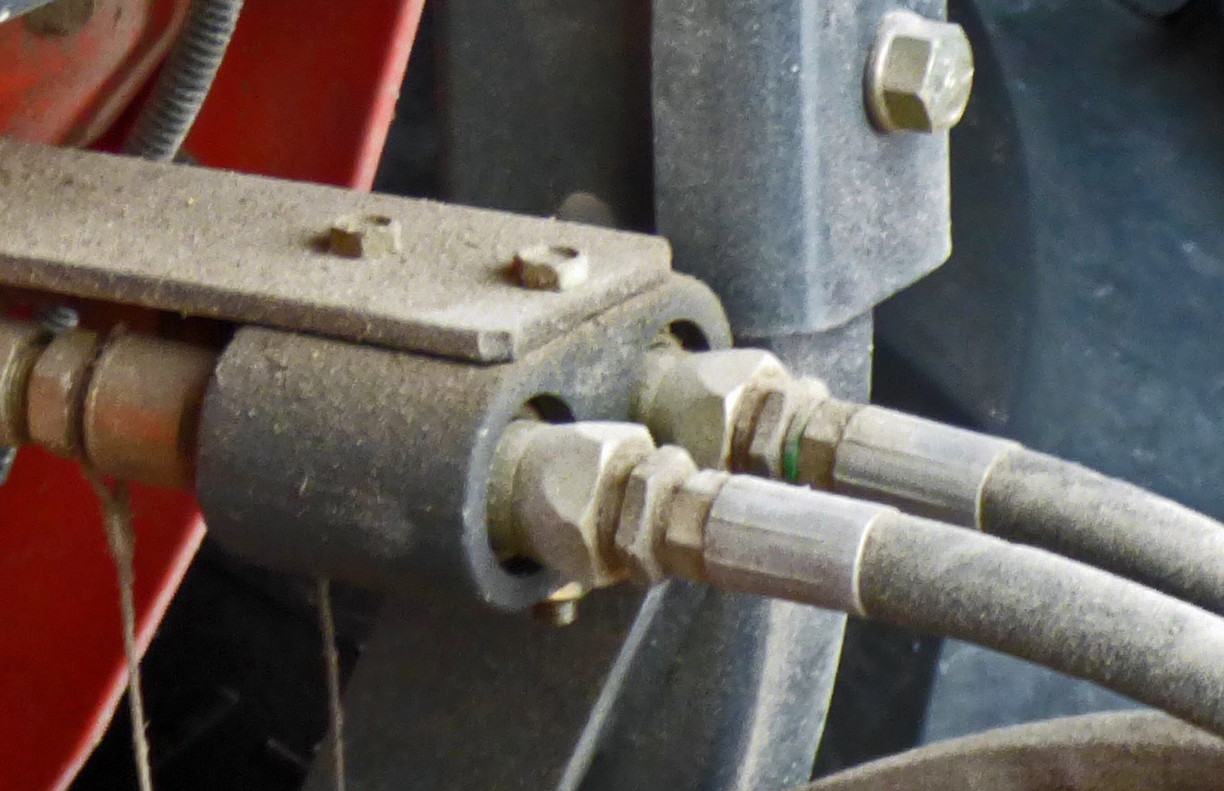

After 30 minutes of using my new EA grapple on my MX5800, I learned the importance of more diligence in hose protection, routing, and security.
Is there a consensus standard on hose protection? I see lots of wraps on Amazon. Are they created equal? Is a nylon sheath under the spiral wrap helpful?What diameter do I even need for twin 3/8” hoses? I assume I’ll want to wrap them together. Thanks for any advice!

Hose got pushed over behind the bottom of the loader end, so that when I tilted, it pinched the hose against the frame. With my frustration, I admittedly did a bad job of assessing the scene. Gonna try a nylon sleeve with HDPE spiral wrap and some zip ties.

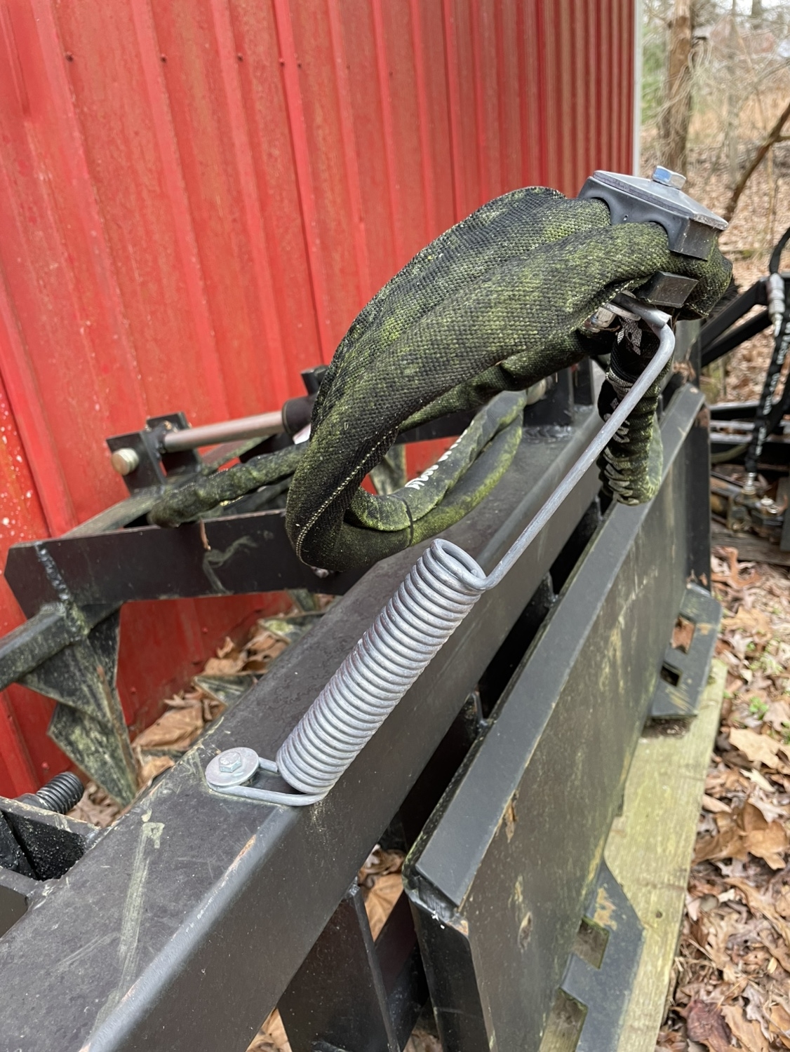

I engineered a spring that attaches to the hoses, and pulls them out of harms way, but still allows for the attachment to be used freely.
Also pay attention to your hose length. Hoses that are too long for what's needed only self destruct if too much slack is placing areas of the hoses in the way of what harms them.
I put that spring system on my grapple and on my Intimidator puller. Has saved me thousands of dollars worth of new hoses.
Later, I'll try and get some photos.

If your hoses have nothing on them, I highly recommend getting protective hose sleeves to put on them all. Besides the abrasion resistance, they protect the hoses from UV light, which is the second biggest danger to hydraulic hoses, in my opinion. I removed each hose on my Kubota and put this sleeve on them. Once you have them protected, you just have to zip tie, or make metal brackets to hold the hoses out of the way while still allowed them necessary slack when using the implements. I made some channel (didn't have the right width on hand), cut into 1.5" pieces, then drilled a hole in the channel and the loader arm to hold my hoses in place. Bolt is in the center, between the hoses.
If you have a situation where you must have a lot of slack, the spring idea for the hoses, like Rockinbbar mentioned, is a good one.

When my son built a grapple and a tree puller for our skid steer he ordered springs that were designed to hold hoses in a safe position and still allow the necessary movement needed for operation.

The problems I have are mostly from getting the hoses caught on something. I've had good luck using bungees to hold the hoses out of the way. I also swapped out the flat face couplers with Pioneer couplers like these, that pull apart when too much strain is applied.
If a hose gets caught, the bungees give until the strain pulls the coupler apart. Not perfect but it works for what I do.
