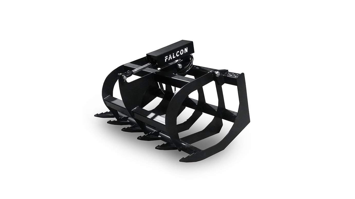

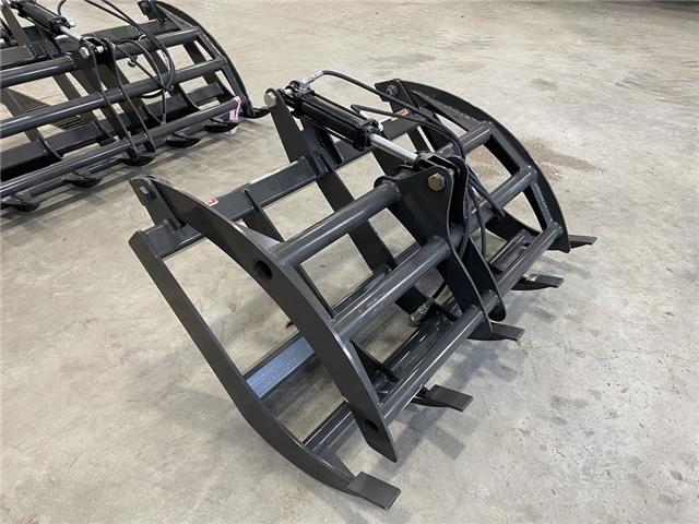

I have a Kubota L2501 and am looking into these 2 grapples. The Falcon is 1/4' 50 grade steel and the CID is 3/8" 50 grade. Most others that I have looked at are 3/8" A36 which is a weaker steel and they are also heavier. The only thing that I can see that I'm not sure about is these don't look like they have greaseable pins.

Other than the construction details, the falcon is a better all purpose design than the other one which would be better suited for racking roots but very little carrying capacity. Grease zerks are mandatory and I can't imagine that both don't have them at all the moving parts. I wouldn't get too hung up on the steel type or thickness considering the size and weight of the tractor. No "cut" on your tractor intended. I have a 84" grapple constructed of 3/8 that's either on a 5 ton 115 hp skid steer or my m9540 and I've been working it hard for 15+ years, I've tweaked one of the "lids" but that was just plain abuse on my part.

I agree with Rusty. For my purposes I would greatly prefer the Falcon. The CID is much to flat to hold much and won't surround the load as it clamps down like the Falcon will.

I have a cid grapple like your photo and am saving pennies for a replacement. It's less than a year old but the short comings mentioned in earlier post are spot on. It's held up to my 3901 just fine but doesn't grab as well as I want.

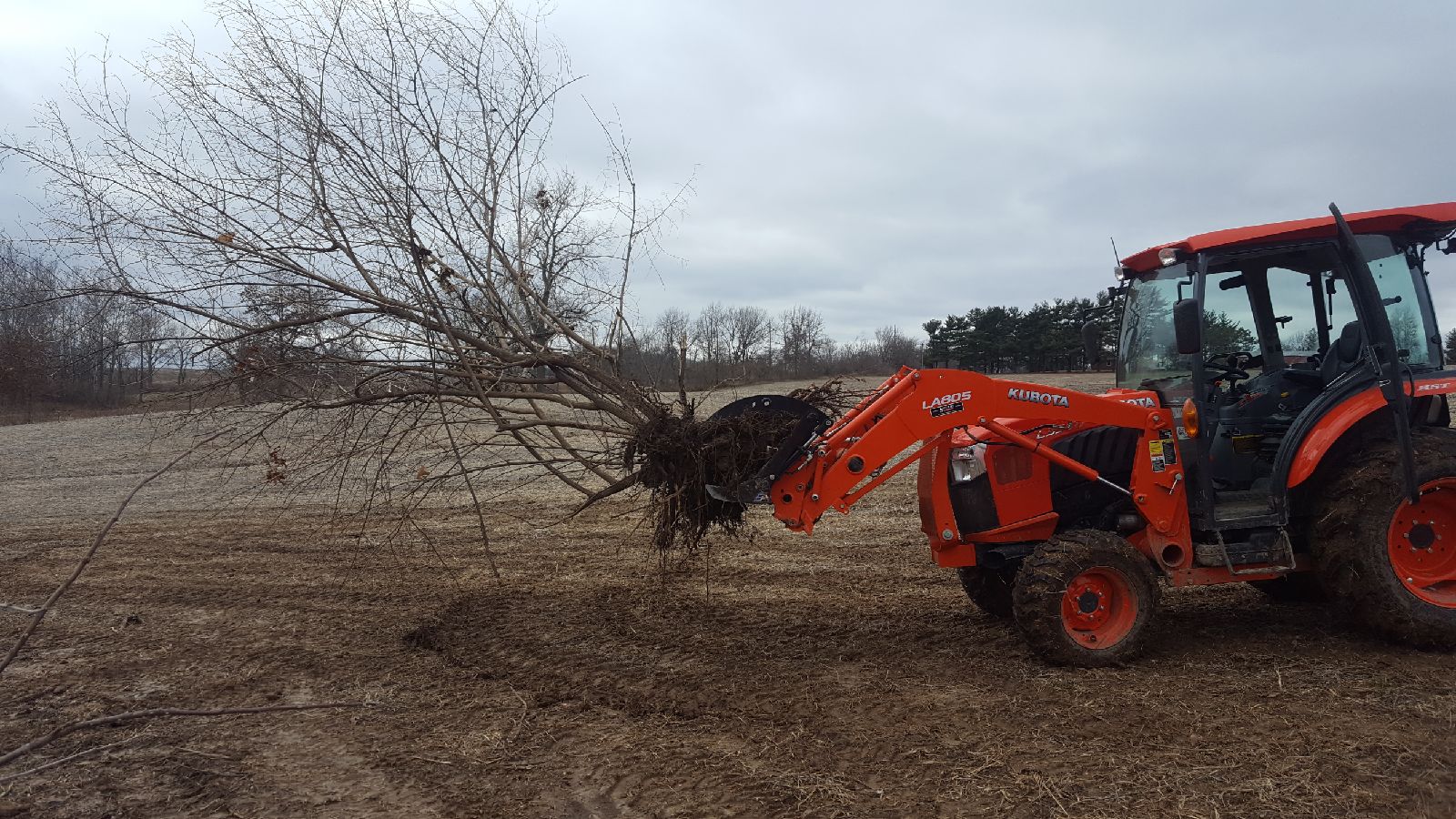

I prefer the clamshell type of grapple. I have found that it allows to get in and get the roots out and at the same time, I have been able to carry decent size loads.
/ Grapple Help #8

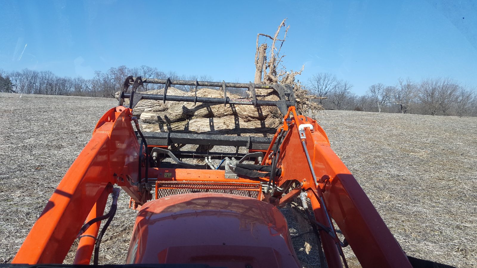

If you can, go check them out in person. I'd get the lightest grapple possible for your machine otherwise you lose too much lifting capacity. I've got the root rake style which is better for ground engagement but it isn't practical for grabbing large log loads or for doing firewood. I have to keep the grapple about 6 feet off the ground when I'm hand loading the grapple or logs just fall off. Check out BRMyers pics and where he is holding the load to see what I mean. My machine will lift the weight but the root rake is like trying to grab large bundles of sticks with tweezers.
When I'm doing firewood I keep wishing I bought the L style grapple.

Does anyone know of a lighter L shaped grapple than that falcon? I think the weight on it is around 275 lbs.

Yeah the MTL uses A36 steel at 3/8". The Falcon is 1/4" grade 50 which is stronger and lighter but probably comparable to the 3/8" A36. I'm only 40 and do about 3 cords a year plus any property cleanup but want something that will holdup. I only have around 1200 lbs lift at the pins so need to keep it light weight.

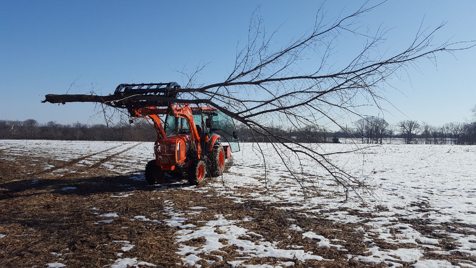

Most of my "property cleanup" is cutting trees and branches. For branch piles, it helps if your grapple has the ability to grab a big arm full of debris. We make neat piles by hand as we are cutting trees so when we burn the next brush pile, I can keep feeding it with the grapple. If we have a wind or ice storm, I may have 40 big grapple piles to feed the fire. It has been the best work-saver attachment I have. Mine is a Bobcat general purpose bucket with the Bobcat grapple attachment. It is not the best design for any one job but it does work good for a variety of different jobs. I have thought of cutting back the sides of the bucket to give it more room for logs but so far it is fine. If I had a sawzall close by, I would have cut it.:dance1:

Compact Tractor 48"-54"-6" HD Root Grapple Hydraulic - quick attach — MTL Attachments
This is a smaller version (48") of the 60" MTL I have and weighs 350 lbs. Seems it would be a good fit and likely handle 98% of your needs. Only you know how often you will need to move logs heavier than 750 lbs.
