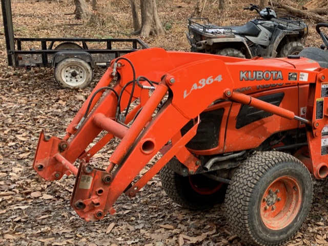

I would like the longer lower tines or teeth. what is a well made unit? i have the front loader QA - I think from a b3200? i have forks for really heavy stuff so for this i would prefer not too heavy or expensive. i will post a pic of the loader connections - i dont know what it is called IMG_0143 (002).jpg

I am surprised no one commented on your loader connector :confused:.
It is for sure not SSQA. It is the Kubota proprietary coupler, Here is an old thread about it: https://www.tractorbynet.com/forums/kubota-buying-pricing/198139-la364-loader-quick-coupler.html
Right. That for sure is the pin on coupler and no SSQA attachment is going to work there. Several years ago I had a B3030 and I added a Washburn skid steer adapter from hayspear.com. It worked but it reduced loader lift capacity due to the added weight and the fact that it also placed the load further out from the lift arms.
I believe the B3030 and 2920 are pretty much the same tractor except for a small horsepower difference. And the lift capacity isn't that great to begin with, much less after decreasing it with an SSQA adapter.

You just need to buy a pin on attachment for for what the quick attachment adaptor is for.
I made an adaptor for my B2620, I thought there was a slight difference between the LA364 and the LA504 that was used on the B3200, but its been a while so I could be mistaken. I remember Kubota didn't officially offer an adaptor for the LA364 at the time I made mine.
As for grapple, I would look at the everything attachments, they have a low enough weight that you won't lose kill your material capacity but are still strong enough that you won't bend them up. They also offer them in pin on for the Kubota loaders.

Is Kubota's pin on QA a proprietary thing or universal skid steer? Universal skid steer is going to make it much easier to find QA attachments.

Its proprietary, just uses stock pin locations on the bucket and just changes the top connection to a hook (also you don't have to remove greasy pivot pins).
The ssqa has more options, but honestly unless you change loader attachments pretty regularly or have some pretty lightweight ssqa implements there's not much benefit of changing over to a ssqa on this size tractor.
