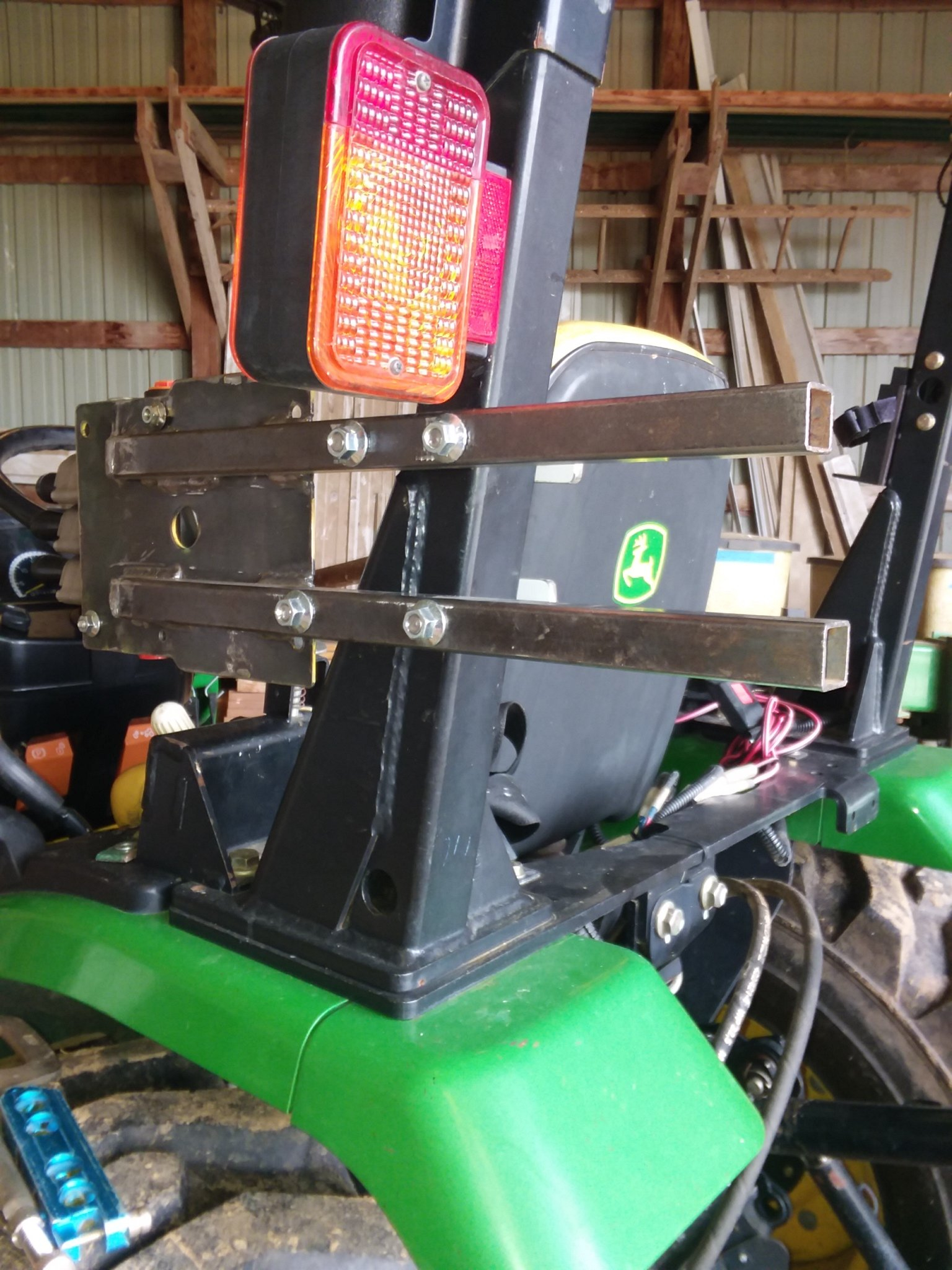

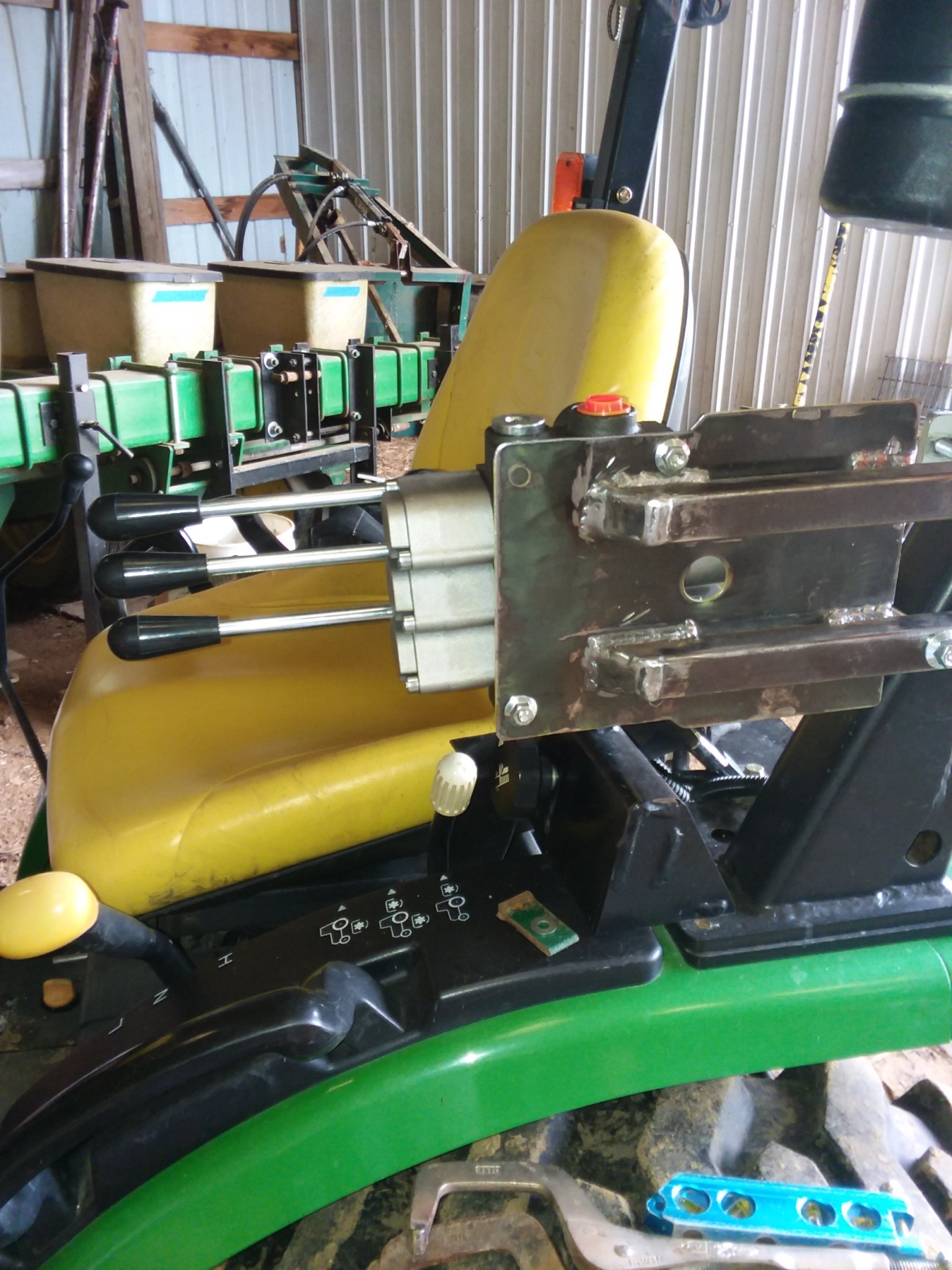

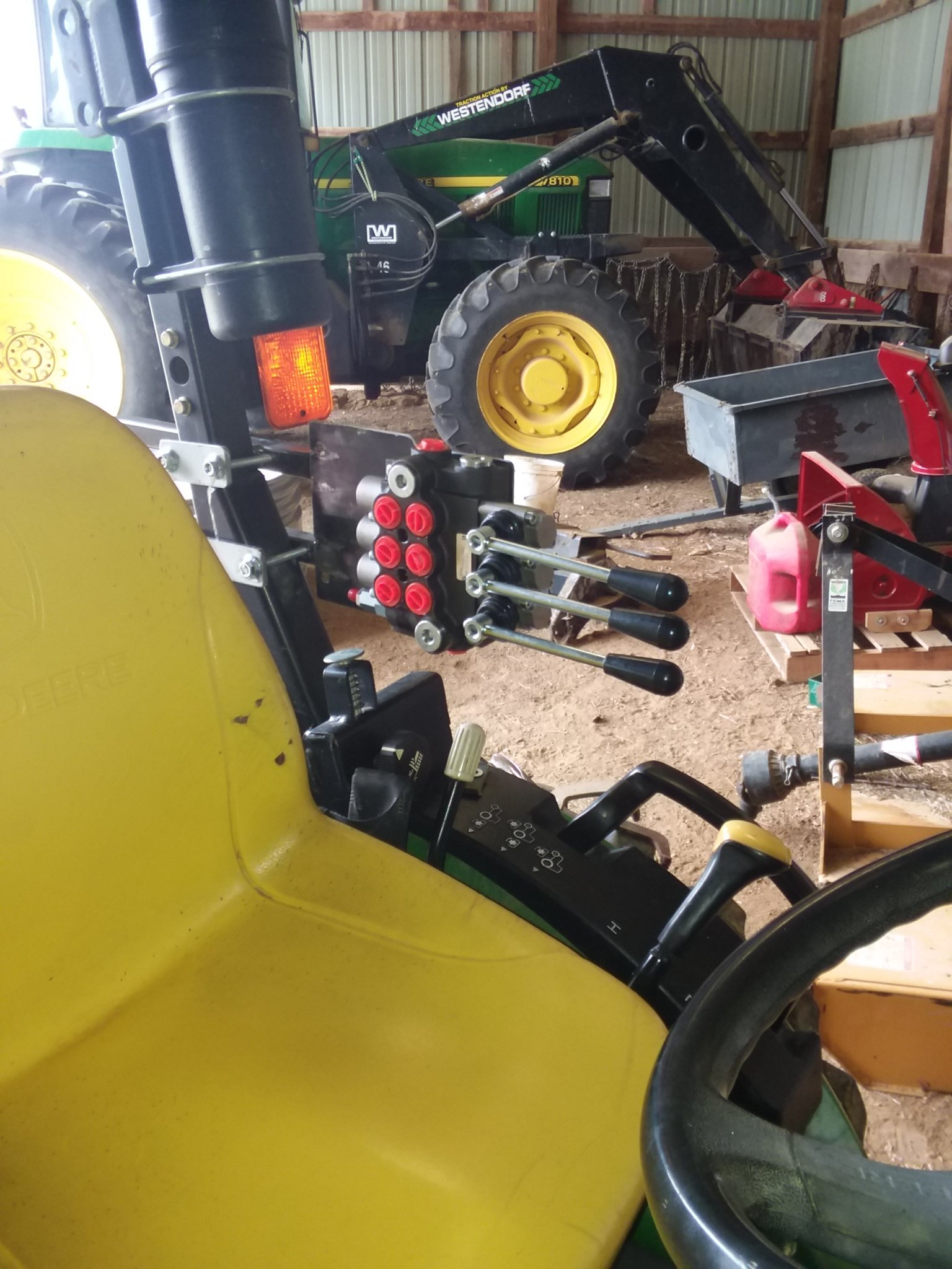

Well I have finally got around to building the bracket for the 3 spool valve I bought. Here are some pictures of the mock up.
My plan from the original idea has changed so I will have to get some other fittings, when the plumbing starts.

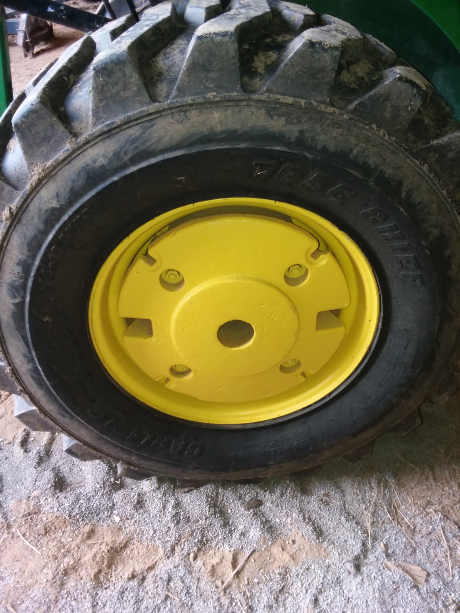

I also took a picture of the 100lb weight that I spoke of earlier. Finger pinching, #!#!#! U get the drift. 🍺

I've never seen a weight for the front like that. Tell us about it.
Also, I like your grapple project, wish i had one sometimes.
/ Grapple for JD 2720 #12
I think those wheel weights are on the rear tires - bigtiller. Take a close look at the first picture posted. You can see them clapped on the rear tires.
/ Grapple for JD 2720 #13
Oh yeah, I see it now. Thanks oosik
#14
Bigtiller, the weights are off a old JD combine . There right around 100lbs each and make a big difference for stability with the FEL. I will have to remove the right rear from my 2720 to get access to the hydraulic block.
