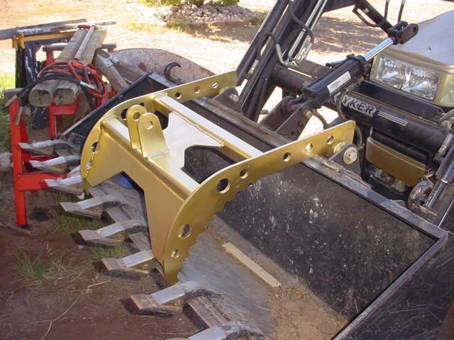

I think I should be able to end this thread by the end of this weekend. It has been a long process, but I think I will be happy with the outcome. I'm going to try to finish up the welding tonight.

DTD,
Man, that is looking really NICE!!!
What is the total width, at the outer grapple teeth?
And what is the width of your bucket?
Just trying to see what kind of "grab" you will have, in relation to your overall bucket width.
Looking reeeeal good!!

Skunk,
The overall width of tooth to tooth is about 42" +/-. The barcket on the bucket is 46" and the bucket itself is 73". So about 15" from tooth to end of bucket.
I was at TSC and they have what looks to be the best paint selection. I figure an implement paint prime and I think match the wheel wells using JD yellow (is that is such a color).
Very ready for the grapple. I just piled up my 27th project for it.

/ Grapple Design #130
Nice job. I really like the wider than average grapple arm and the moderate underbite.
Now we need you to get out of your shop and snag some "grapple in action" photos.:)
