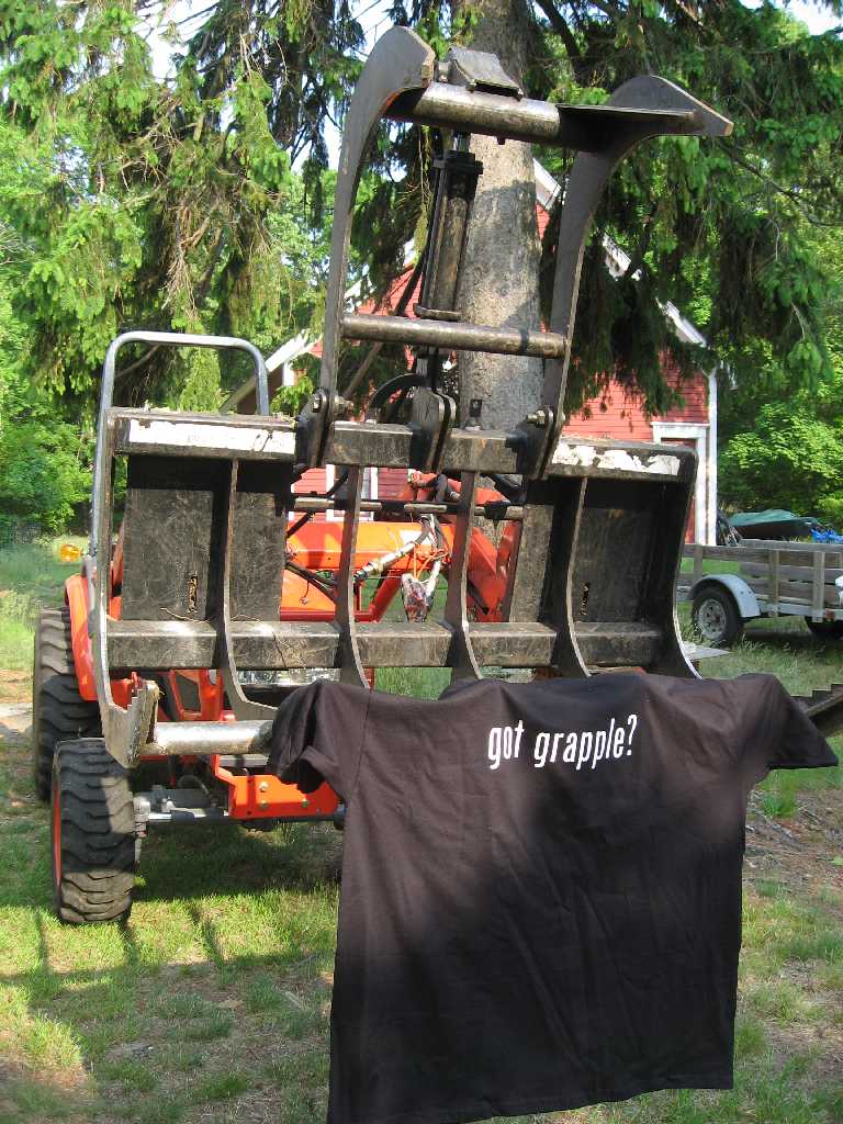

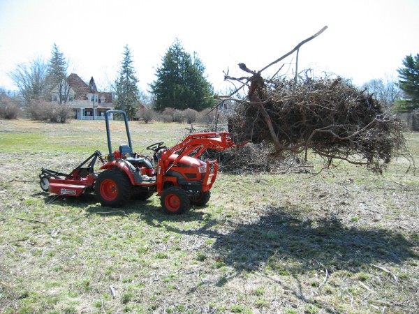

OK I did all the calculations. Looks like my grapple will add 225 lbs +/- to my FEL. The specs say she is good for 1175 lbs at full lift capacity. Lets say she ends up being 250 lbs, that leave 925 lbs left. Seems ok to me. What do you guys think?
   / Grapple Design #113

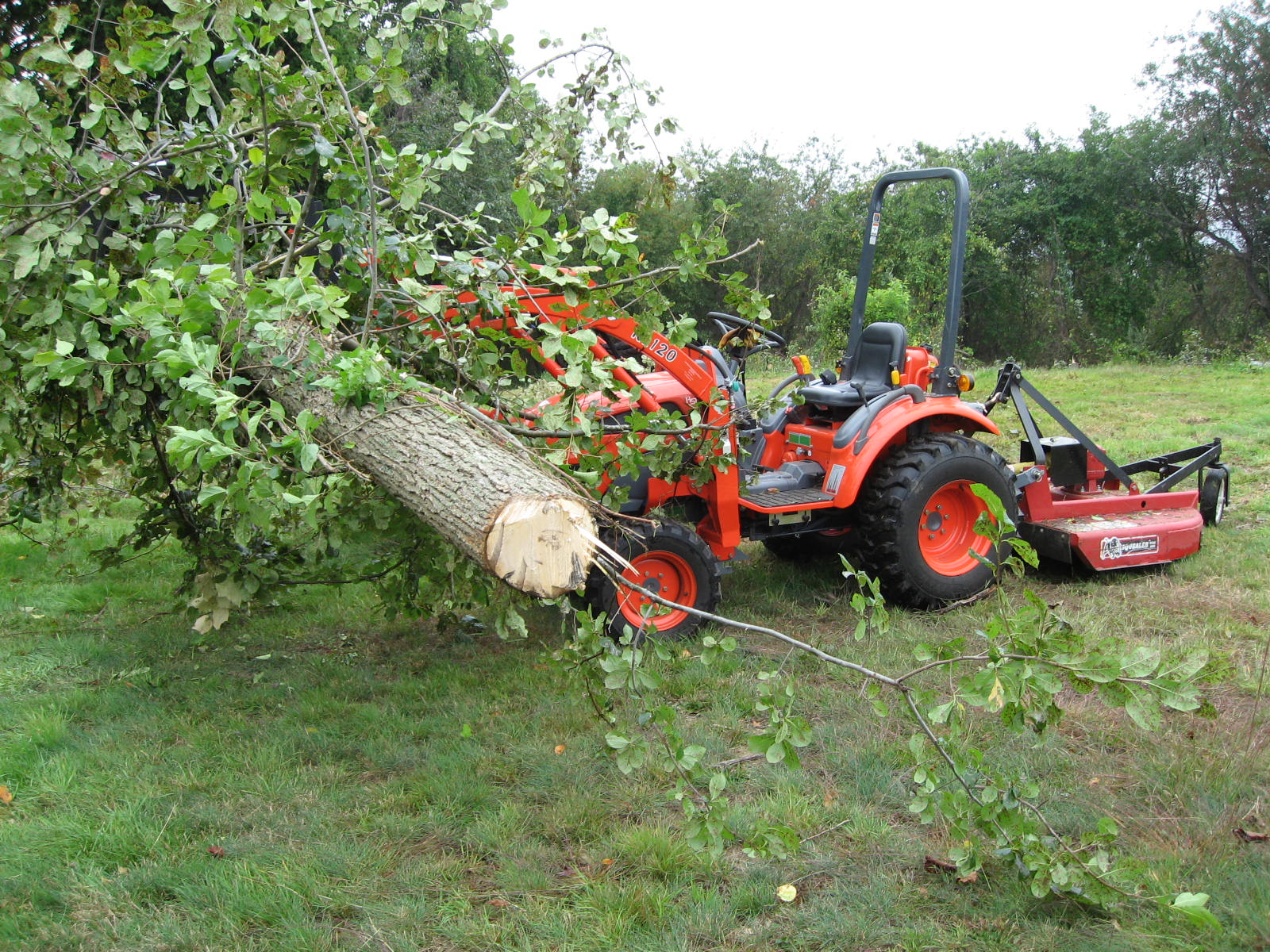

Except for picking up stumps or whole trees, it is pretty hard to get more than 1000lbs of material into a grapple. My CK20 has a lift capacity at pivot pins of 1070lbs and I have a 280lb grapple on it. I can lift ANY amount of brush I can cram into the thing. I often have the grapple so overloaded I almost have to get off the tractor to see where I am going and I routinely stop, raise the grapple higher so I can peek underneath, and then lower and keep going. Point being that 900lbs of capacity is plenty to be useful.
Bigger stumps can weigh more than 900lbs and in theory you could try to load too many logs (I can lift one 15" x 16-18 foot log with limbs attached).
Bottom line is that you'll be fine with that residual net lift capacity.

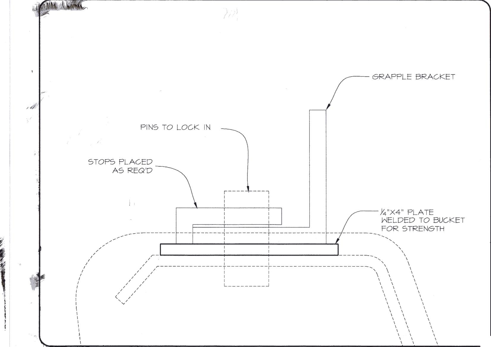

Ok, the metal is all cut up. All the weld chamfers are done, the arms should be welded up for this weekend. We bored a hole in the arm to except a stainless pipe at the bucket connection. I got the idea from the gugliois thread. I think this should aid in stability of the arm, and wear better than just a hole alone in the arm. Perfect spot for another zerk as well.
We have decided to try something alittle different as far as the mounting of the the grapple at the fel. We will create a slid of sorts that the bracket will slip into. Then We will pin the grapple bracket in place to the fel. My stepdad came up with this. At first I was worried about slop, but I think this would be an exclent way to slip on and slip off the fel by myself.
Take a peek at this sketch and chime in!

   / Grapple Design #116
dtd24, I have to hand it to you on your grapple build, I just read all 115 post and looked at all pictures, I have learned heaps and I am building a rake/grapple and no design yet? :D I have my teeth cut and just sitting on floor rusting away
Keep up all the great work
Jim
