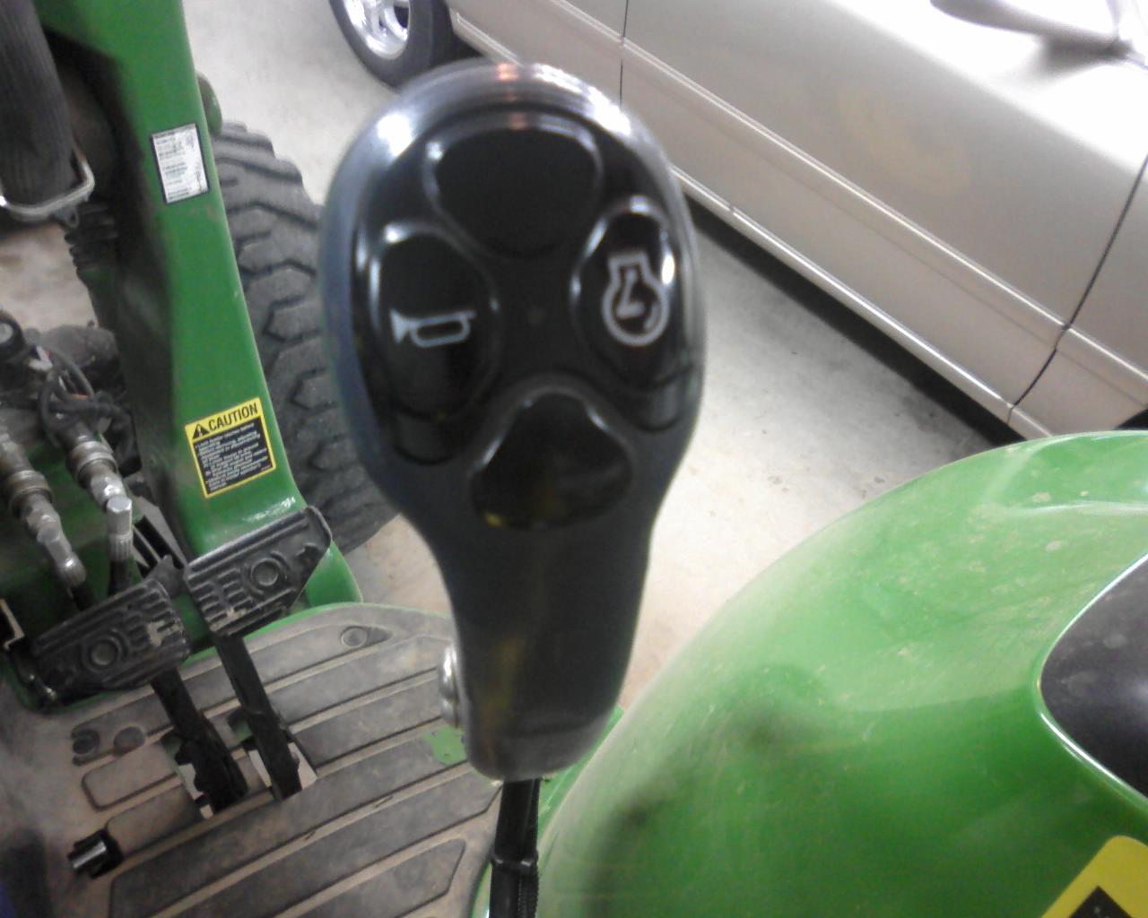

The knob was from a takeuchi mini excavator which I modified to fit the tractor
Nice, but one thing the OP wrote:
I AM not a mechanic...so you gonna have guide me here
That statement kind of precludes him from doing a custom install like you (and myself) have done, that is why I am steering him to JD parts.

Where did you get that handle for $70? I paid $175.00 for mine!
That looks like the OEM John Deere joystick handle. Yes?

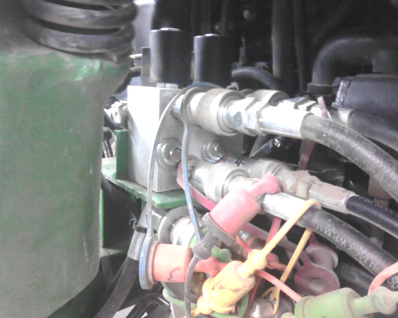

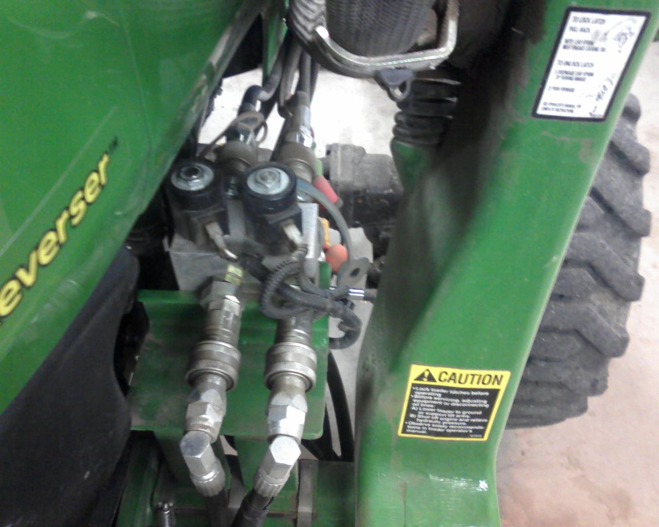

You need the 3rd scv installed and the hardline kit that runs to the end of the loader arms.
Look into JD number BW15260 '3rd SCV Kit'. The part bundle has everything you need to hook into the rear remotes on the 4320 and use the 3rd SCV control to operate the grapple function. I used this on my 4720 with ANBO grapple - easy to install and cheap compared to a true 3rd function e-over-hydraulic solution. The grapple control isn't on the loader joystick, but the SCV lever is close enough to shift your hand between joystick & grapple lever without too much thought or effort. Bundle cost was $351 delivered to my WI JD dealer.
/ Grapple bucket? #27
I have that Frontier grapple on my 4520 with the Deere 3rd scv mod.....works great and do not know what I would do without it!
