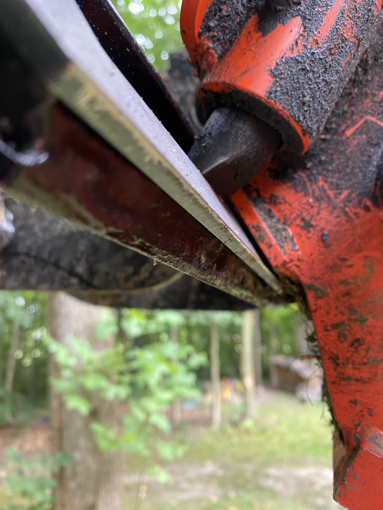

Having that much grease on the chamfered pin OD probably doesn't help. And between the chamfer itself and where that chamfer contacts the rectangular hole in the attachment. I've got a similar problem to deal with but I think it's the chamfered pin telescoping up against its compression spring. Guys with tight levers may need plenty of lube.

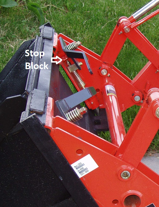

----------------------------- I've got a similar problem to deal with but I think it's the chamfered pin telescoping up against its compression spring. ----------------------------
Can you add something like this to keep the latch pin from moving up when latched over center?

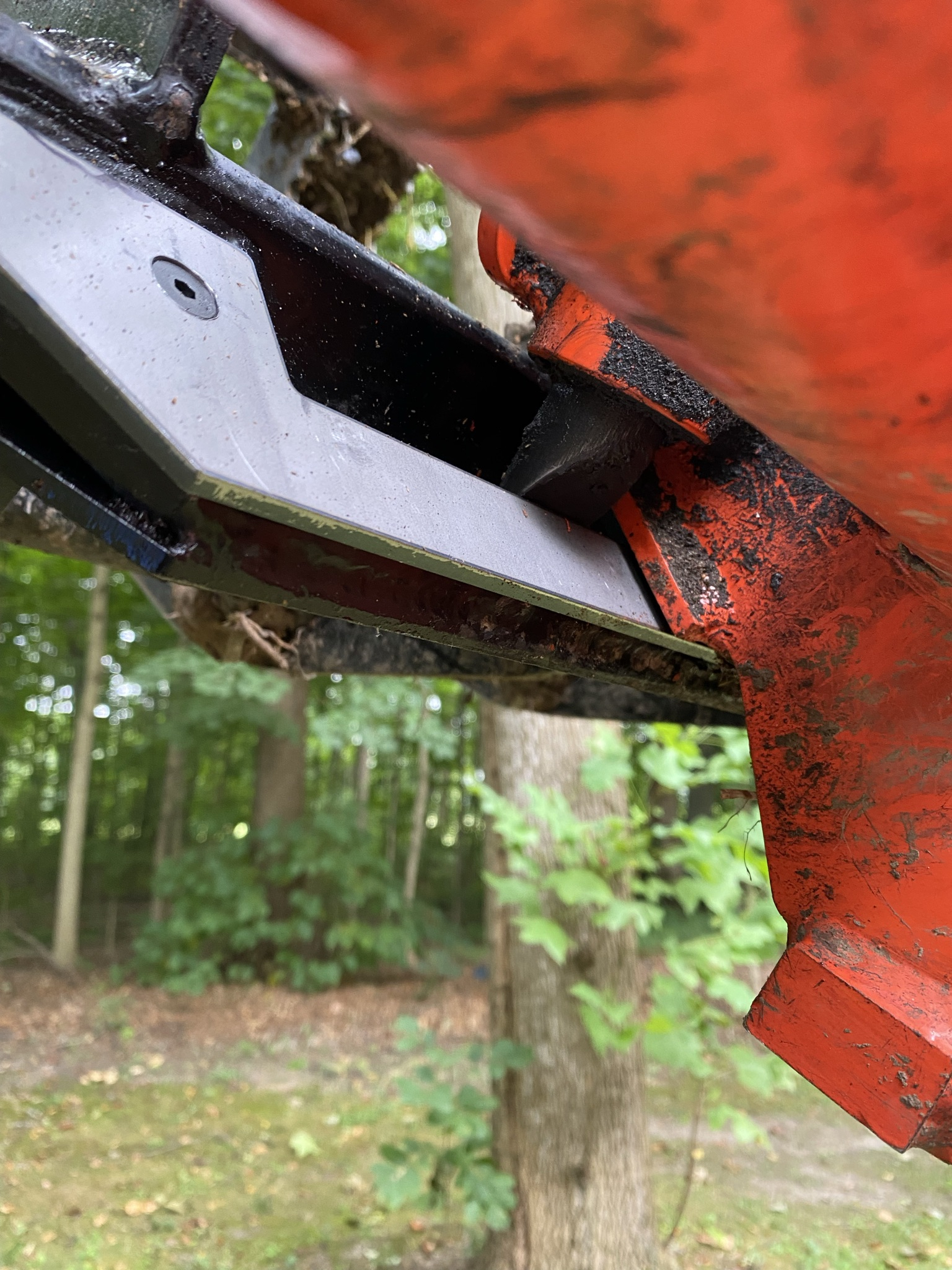

Smoke with manufacture and they are sending a shims for bottom of QA. It will be up to me to weld…they did credit my card $ to allow for me to hire a welder. All in all not unreasonable.
I expect this will resolve my problems.

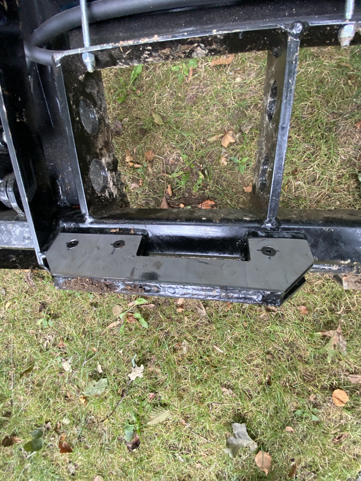

The first photo that shows the OP's locking pin seems like the pin doesn't extend far enough to lock in. All the other pics from other posters show the pin extending further.
   / Grapple became unattached. #39
The first photo that shows the OP's locking pin seems like the pin doesn't extend far enough to lock in. -------------------------------------
It looks that way because the bottom plate is too low, there is a gap between it and the QA.
The shims will fill the gap and contact the pins.
#40

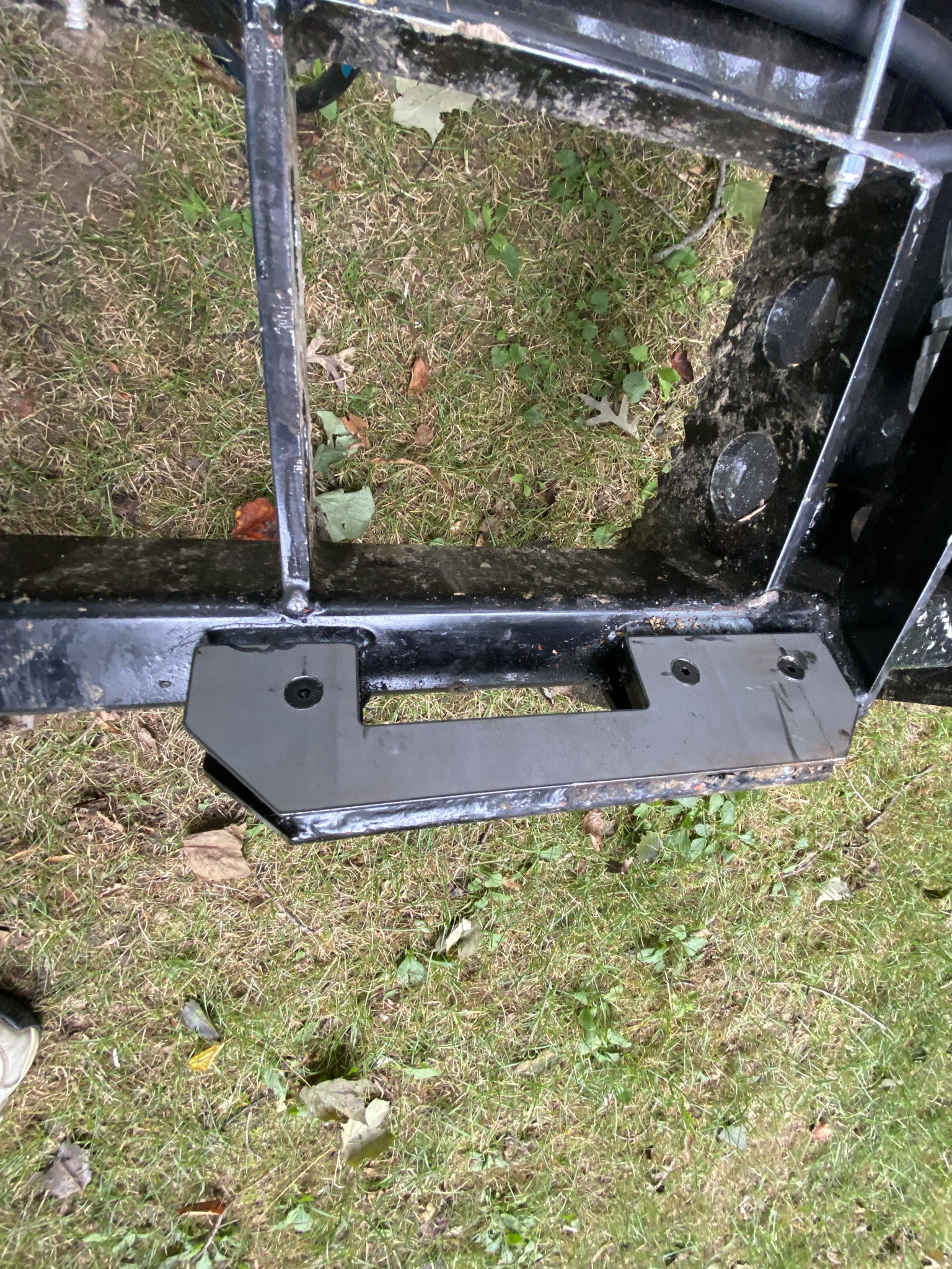

Installed shims provided by EA. They where laser cut and required trimming and grinding to allow for welds already on grapple, expected. I drilled and counter sunk grade 8 bolts tapping grapple frame.
Over all I am pleased with results, however there is still a gap at plate, right side is 1/8th inch and left is 1/16th inch. Also notable is that spring tension…it is now present where previously it was not but is not as much as my other quick attach implements.
EA only had 3/16 shims, they sent 4 so I could stack, but this will not fit. Considering asking for 1/4 and 5/16 shims, or 1/8 shims (2 on left and 1 on right with existing 3/16 shim). This should increase spring tension and eliminate gaps.
Thanks for industry standards on quick attach mount, very helpful. This supports my gap measurements perfectly.
Appreciate all the suggestions and observations.
