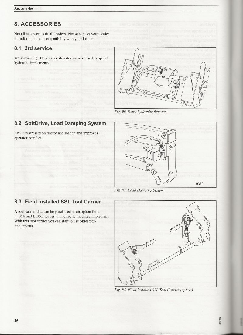

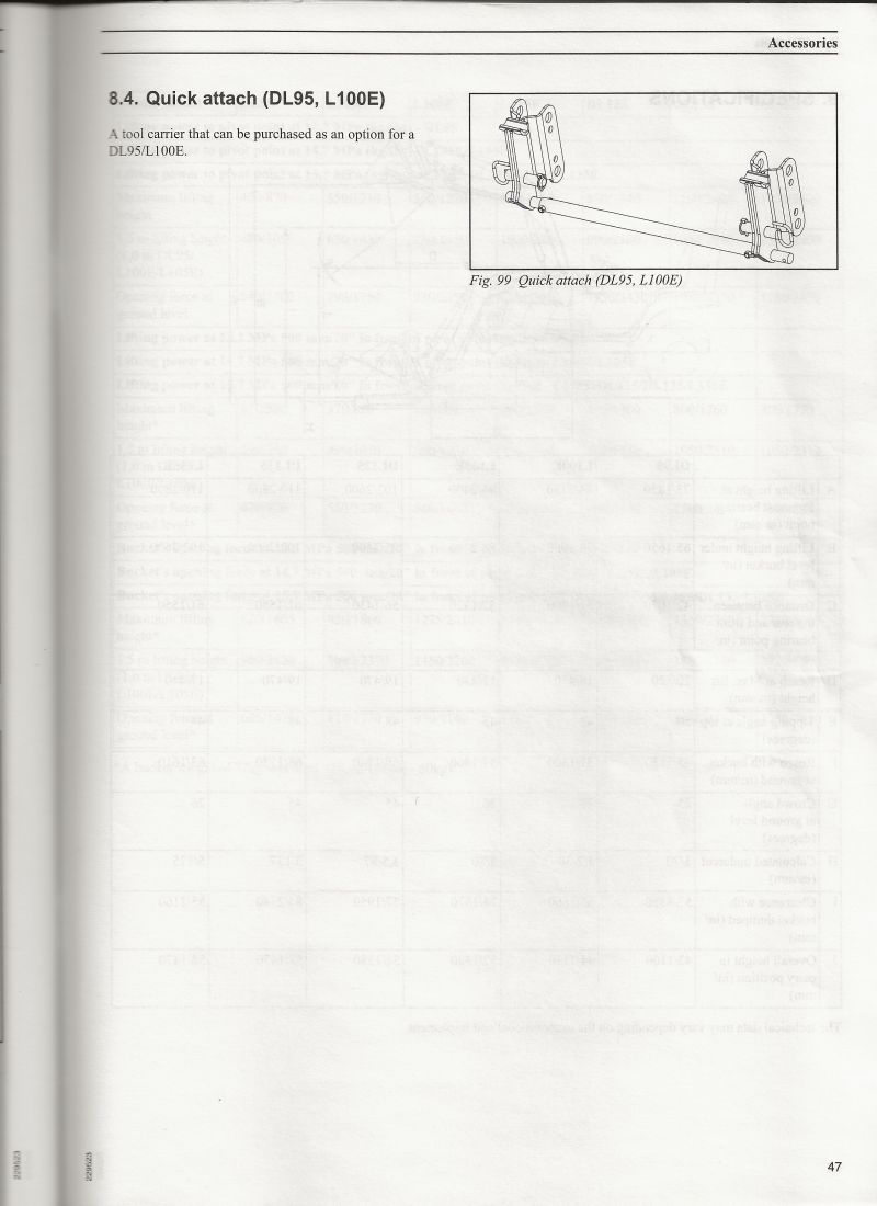

IF you have a DL 95 FEL on tractor and IF you have manual for FEL it suggest the dealers have a "quick connect" system available for loader...

I have a DL 100

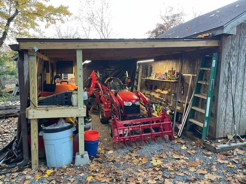

I had the dealer put a Gabble on my Massey GC 1723. CID unit 48 inch. I love it so handy it was not cheep 2833.00 installed
