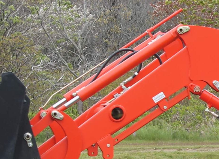

I can see mine fairly well.. Do you have a bucket level indicator rod on your tractor?View attachment 414059
No I don't have one of those and have thought about adding one but on uneven ground I would really like to see the tines. How are you able to see yours? Where do you look?
   / Grapple --- 1 Lid or 2 #129
Why do you want to see the precise location of the tines? Can you see the precise location of your standard bucket edge? I too wish I could see the exact positioning better but I have been able to function quite effectively without that sort of precision.

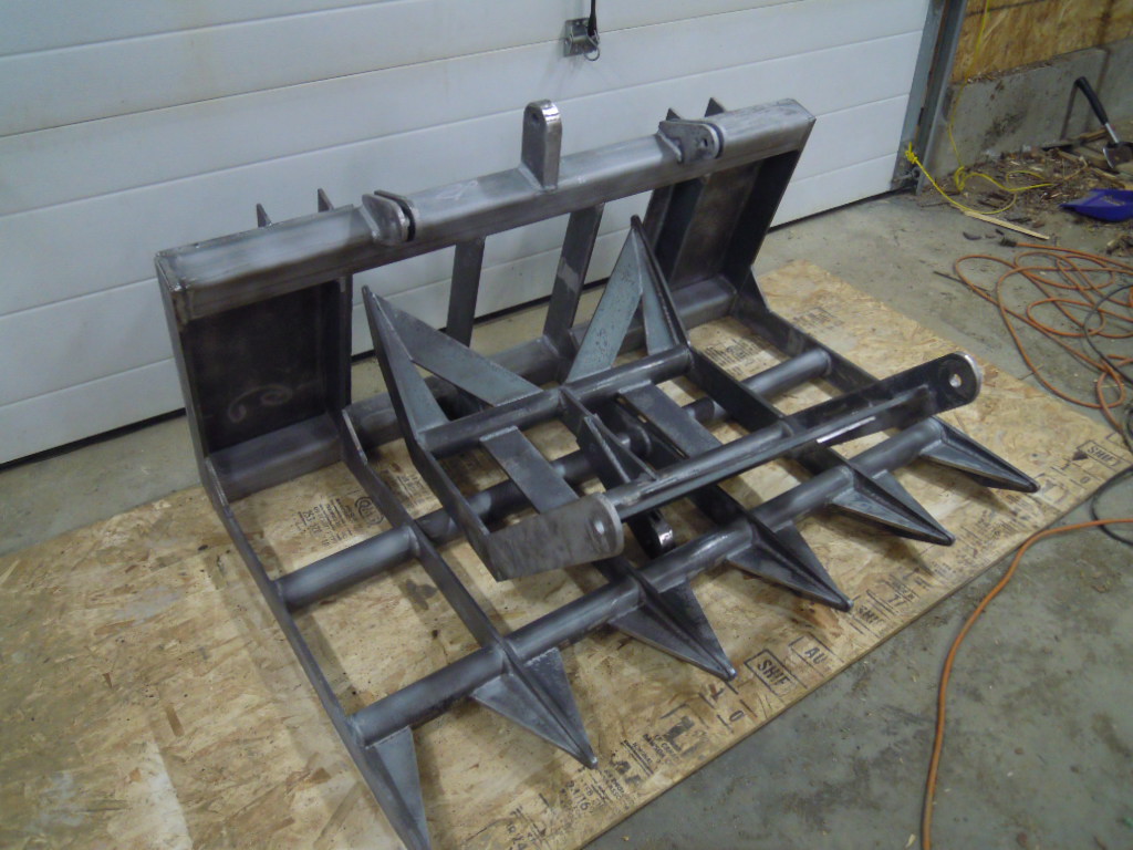

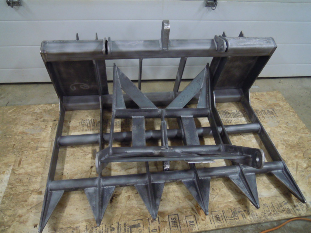

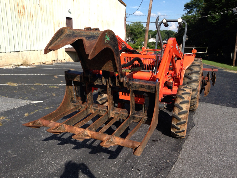

That is an amazing project! I'm impressed. I would offer three suggestions. I would add a "V" shaped plate between the top two teeth to add a center grip and in case you pick up a tree by the trunk parallel to the tractor. I do this very frequently. I have also use it in a similar fashion to pick up a long post and transport it or to stand it up in a pre dug hole ( as in building a pole barn". But my point is, I often pick up things longitudinally, not crosswise.
I would also add a protective plate, or mesh in the rear to keep limbs from poking through to the front of your tractor.
And perhaps spacers midway between the main bottom tines to keep debris from falling out, for instance when picking up smaller stuff or rocks.
But overall, that's a piece of art! Great job.
Thanks for the compliments.
I did add some more bracing on the lid and between the front and rear of the lower tines. I don't think I will need the additional tines like you have, since I don't expect to be picking up rocks with my grapple. I hope not because it will be much harder to add the tines now that I have welded in the extra cross tubes. I forgot about the mesh at the rear of the grapple and don't have any so I may just wait until I go to the City again or add the mesh to the front guard on the tractor.
I got the grapple sand blasted today and ready to paint but it is still pretty cold out so I will wait for a sunny day to actually paint it.
Here is a pic of the pieces all blasted, showing the additional bracing. Note the lid is laying upside down on the lower tines.
I like the camera idea too but may give the mirror a try first, since I have one of those already. Got to wait until I get it painted though.
