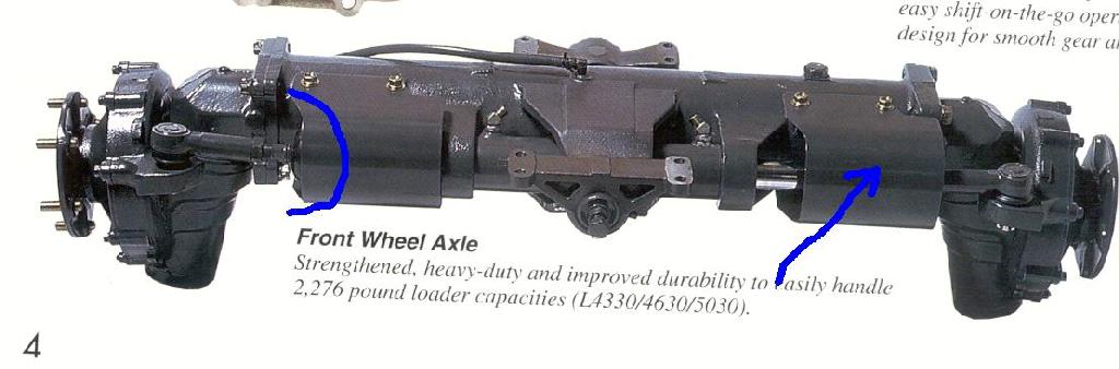

Here is a picture of the front axle with shields out of the catalog. The dealer was saying that they need to cut the shields as outlined in blue. Take note that the right shield is installed incorrectly for the catalog picture ... oops. /forums/images/graemlins/blush.gif

I happen to be a Kubota guy but I must say that offering a MMM option and not testing the fit with turfs or loader is a bit weak. I don't believe I would be happy with the loader support bracket cut to allow the mower to work. The front shields I might could live with. In this case I would look at different brands if I was set on a MMM.

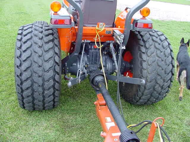

We have an L4610 equiped with what I call "Super Turfs" These are not same tire as the Galaxy Turf,but I believe they are the same size.
The rear tires have a deeper lug,a little over 1",they will still get a good bite,but are wide enough the distribute the tractors weight better than a standard size Turf Tire.
The rears are a Firestone 6-ply,"Turf & Field" 21.5 x 16.1
The fronts tires are a Goodyear 29 x 12.50-NHS. The front axle on the new L-Series is "similar" to the axle on our 4610,but the shields do appear to be a different.
I've never had a problem with the front tires making contact with the shields...See attachments...Good luck on your tractor buying experience...I have researched more on a tractor purchase than I have when buying a house /forums/images/graemlins/crazy.gif
