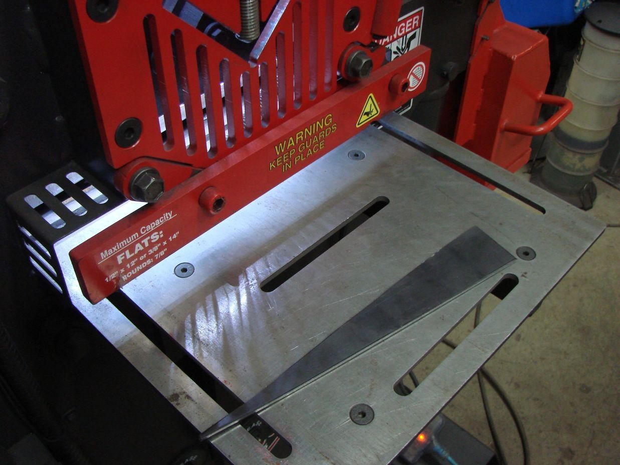

The seat that DDT used is considered a fork lift seat. It's a much lower profile than the seat I went with. The seat I used was the closest to the orginal I could find after doing many hours of research. The new seat is the same height as the original but the problem is the grand l floor pan. The floor pan is on a sloap and the seat requires a level base so that's why I designed,fabricated and modified the floor pan. If you were to use the same seat I used and just plate over the floor pan and lay that seat on it you would be hitting your head on the ceiling.
So choices are.
Low profile seat = plate over floor pan
Seat like I used that closely matches the original = modifying floor pan.
I did the video to show how its done. It's not hard to do.

The orginal seat plate is over $300. according to our local dealer so to buy one and modify it would be expensive but if someone were to send me their existing seat pan I could do the modifacation and send it back painted and ready to install. The turnaround would be fast because id do the modification the same day the seat pan arrived and ship it out the next day. The only thing left to do would be to drill four holes and bolt your new seat in.

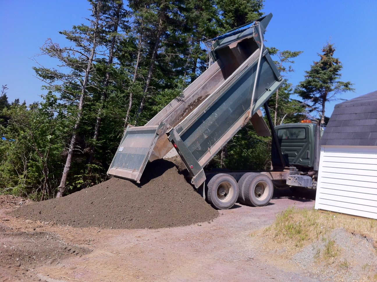

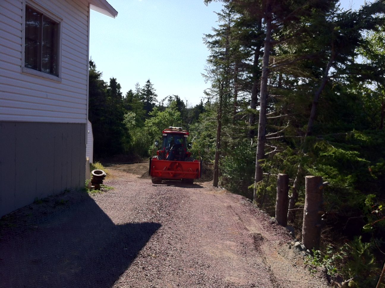

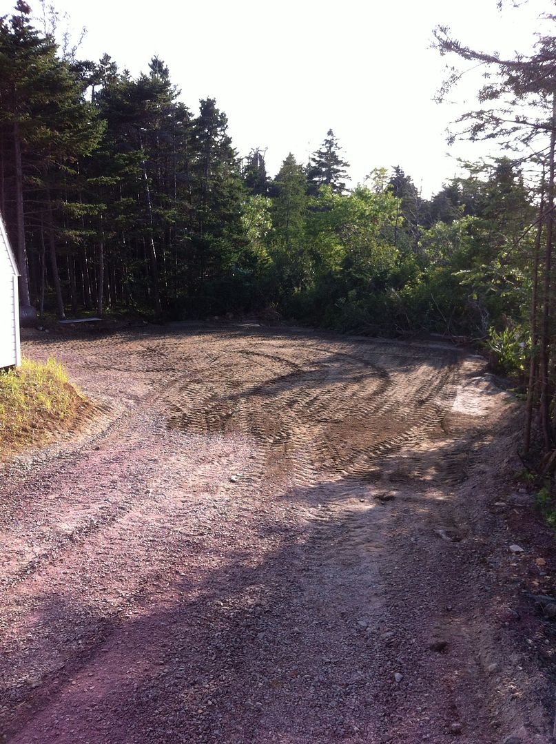

Driving around with that snow blower on may give people the wrong impression about how cold it is up north. :laughing:
/ Grand L seat replacement #14
:laughing: to tell the truth it was only 8 c here yesterday but it was a welcomed cold considering the heat we are after having. I'm planning on using the snow blower to spread the crushed stone today ;)
