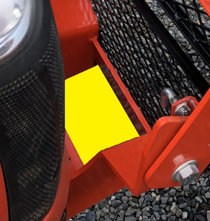

I am getting ready to add expanded metal to the grill guard on my Grand L 5460. I have done some searching on TBN but have not found any photos where another member has done this on the Grand L with the folding grill guard. Photos and suggestions will be greatly appreciated.

Just put 2 pieces of metal ..Should be pretty easy..
/ Grand L grill guard #4

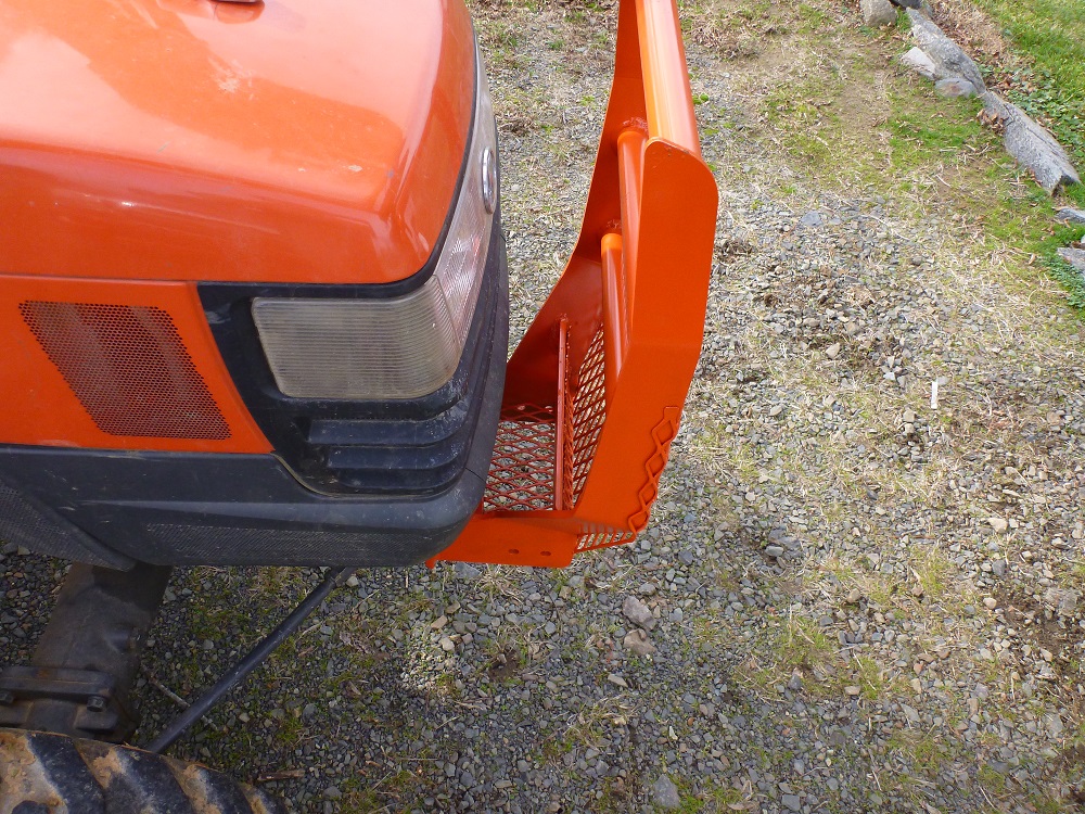

This is someone else's photo - you can see the 2 parts... The yellow was where I show him to add more mesh to keep sticks from come up through there (next photo shows mine with the "basket")
Mine does NOT have mesh in front of my headlights... I didn't have a problem up there but did with the lower section. Some of it actually has 2 layers of mesh...

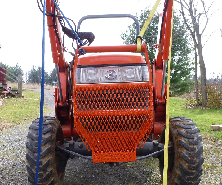

FYI... I used ratchet straps to hold my grill guard up so I can bolt it back on easier...

Hope you are propping that loader up with all that ratchet straps going on.
Blocking that lower space is important like you say. Does tend to catch debris. On the B26 used a inverted V 3x5” angle iron and is self cleaning mostly. On the M59 didn’t really have that option because wanted a front tube bumper to better protect front axle and steering arms. Easy enough to blow out.
Triple S steel supply in Knoxville TN has 2x4’ cut sections of expanded metal and perforated sheet in their showroom. To support the BBQ businesses I guess as they have the weld on hinges, handles, temperature gauges too. The 3/8 x 3x6 x23.5” tube bumper was a drop from there that didn’t have to be cut.

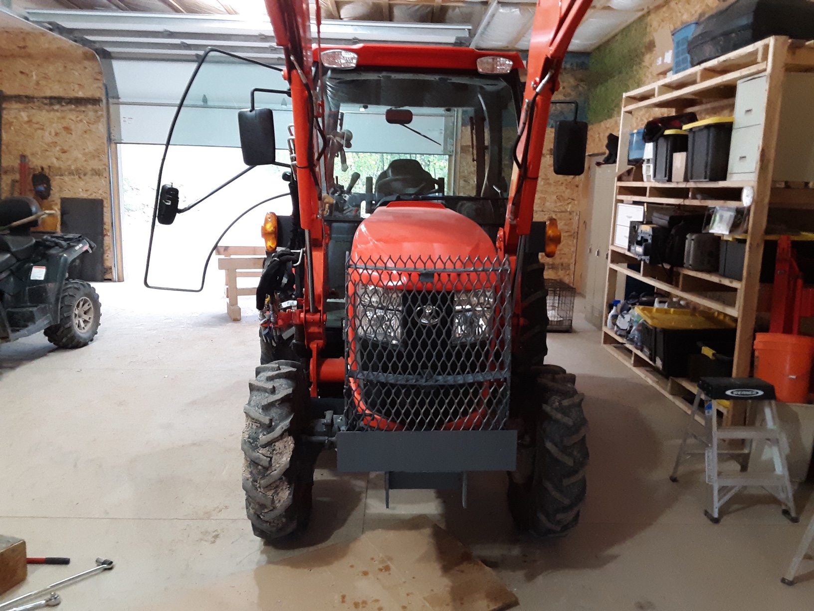

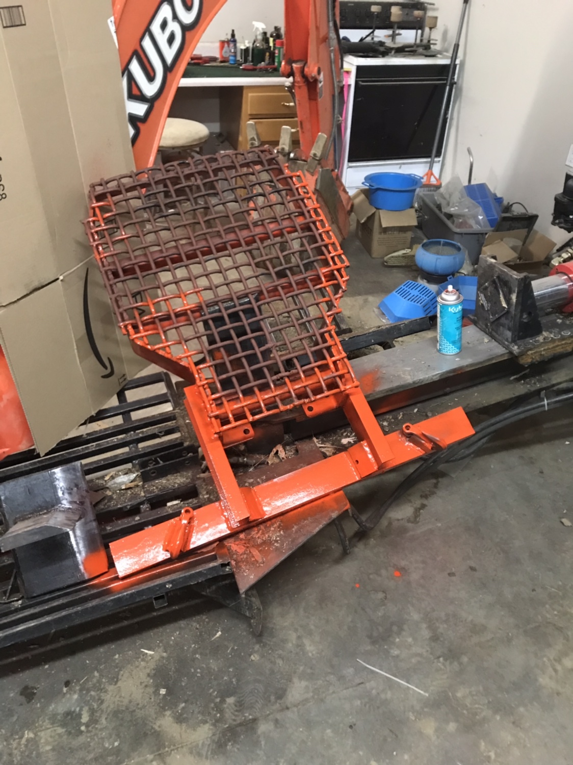

/ Grand L grill guard #17
What is that mesh? Looks like it would hold up well and can take abuse.
I don’t know, I found it in a junkyard but it’s heavy duty.
/ Grand L grill guard #20
Quarry screen is some tough stuff and comes in different mesh size. Much stronger than expanded metal. Found my piece at the scrapyard too. Grapple lots of brush and trees.
