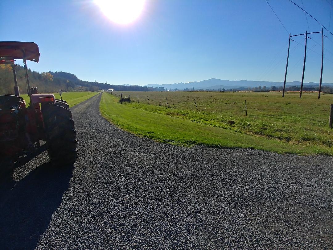

I put in 300' of driveway on expansive clay soil when I built my house 15 years ago. Drainage is especially important with clay soil, I built up the driveway with the clay topsoil, graded it so it would drain. then added 4" of crushed rock road base. After a few rains and compaction from traffic I added another 4" of road base. It is now a solid surface that doesn't require much maintenance.

Since I don't have clay but instead sandy loam with a lot of clay mixed in my situation may be similar. About 15 years ago when we first put in our drive I used a bush hog and my Ford 9N to blaze a trail through the woods. Then the dozer came and made a road. On the advice of the guy, who was also a neighbor, who would be bringing in the gravel and actually making the road I put down about 6" of railroad ballast. This stuff was left in place until the house was done. Then 3/4" minus, about 4" worth, was spread over the ballast rock. Since the original road went in we have had to add gravel twice. The first time, about 5 years ago, the wrong gravel was put down by a shyster gravel company here on the island. The stuff was too small and the wrong shape, so it ended up sinking down and shifting some. Two years ago we had a trustworthy fellow bring in the correct gravel, 3/4" minus with fines. He laid this gravel down and re-crowned our roads, and compacted it all. The drive now drains properly and not only looks great it drains great. I'm pretty sure the roads on our place will now last a very long time. I'm not sure why I had to add gravel the first time because there was so much stuff already in place but I think it is because the sandy loam and clay mix let everything just sink in. I have wondered, since I read about geotextile fabric here on TBN a few years ago, if that stuff would have prevented my roads from sinking. In any case it all seems stable now.
