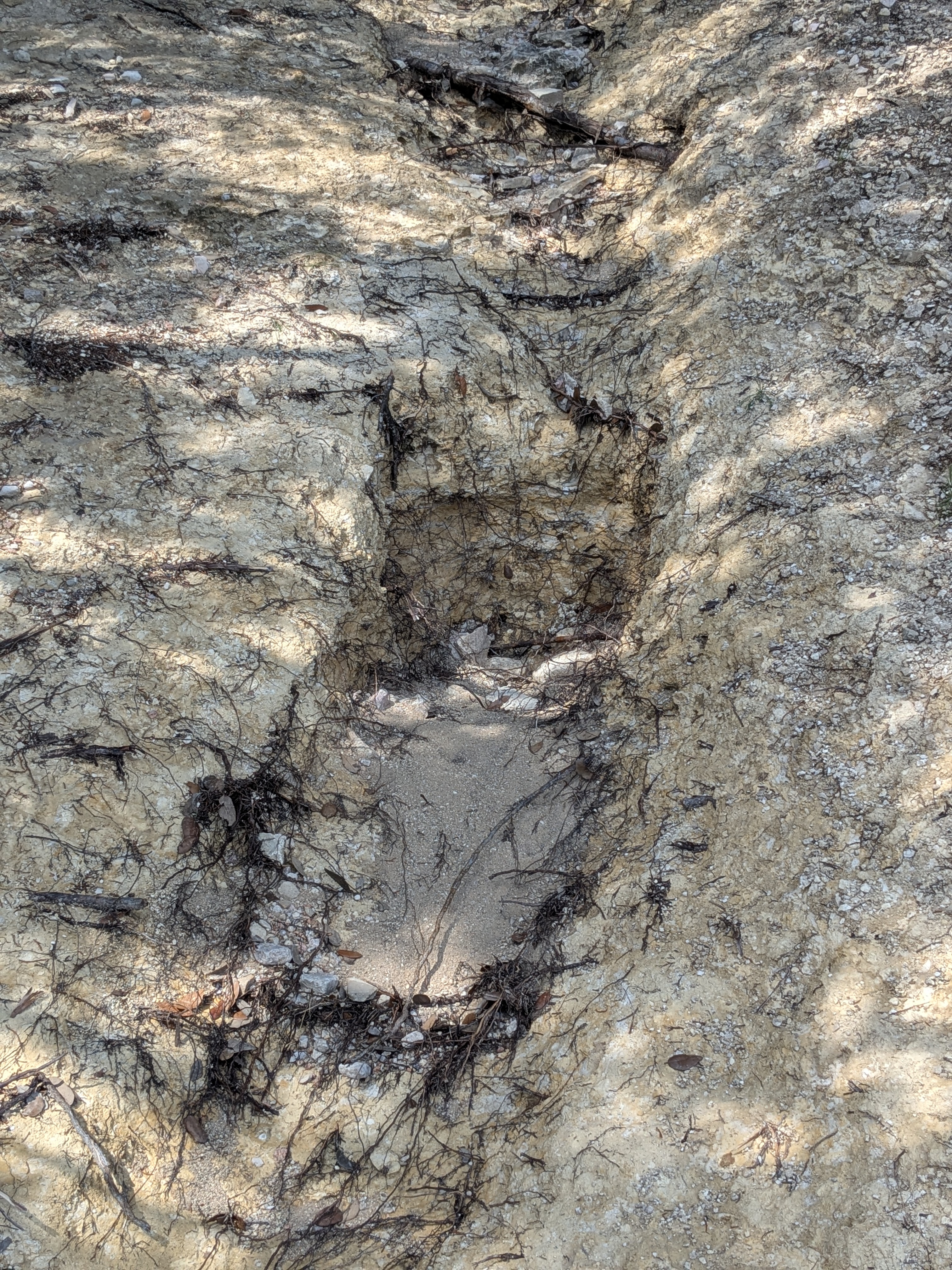

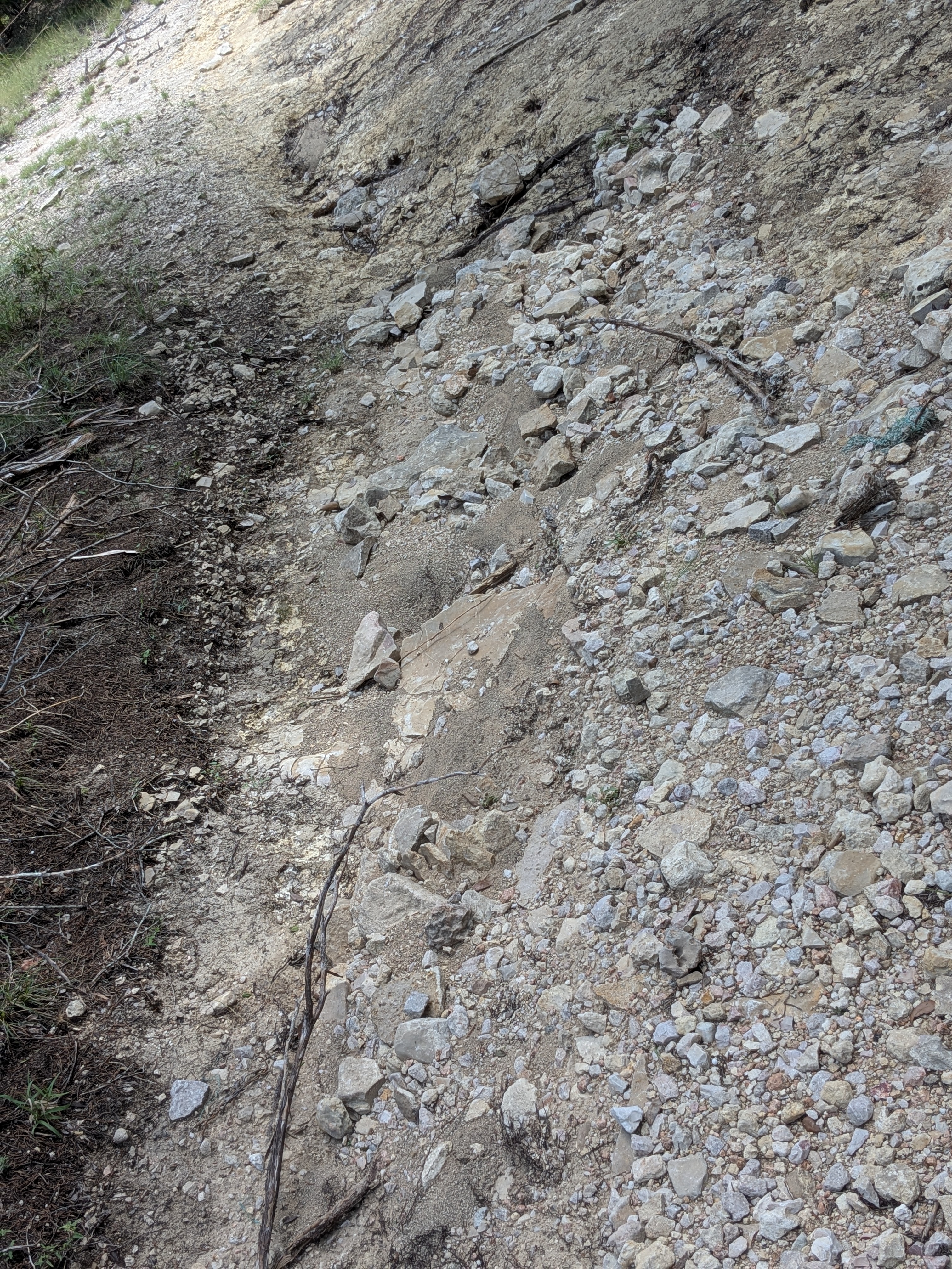

Hello. Is boxblade the right implement to fix deep ruts, potholes and erosion on a trail that is pretty much bare limestone? I have 'inherited' a JD5400 in more or less running condition and a box blade.
Unfortunately, I do a very different thing for a living but I'm willing to learnView attachment 3810861View attachment 3810862. All I know is that mini-excavators have no trouble digging through it.
I don't think a box blade will do it. Get a D4 in and have it leveled first.

True. Unfortunately, this is the path that water takes in heavy rains. I'm not sure what kind of drainage is right for this since it's not a driveway, just a trail/occasionally used road through the property that I want to keep passable but it's not worth investing heavily
You just need to high center the road/trail so the water runs down the sides and not down the middle. Some tractors have the capability to angle the box scraper side to side along with from to back. That would allow the box scraper to dig deeper on the edges.
