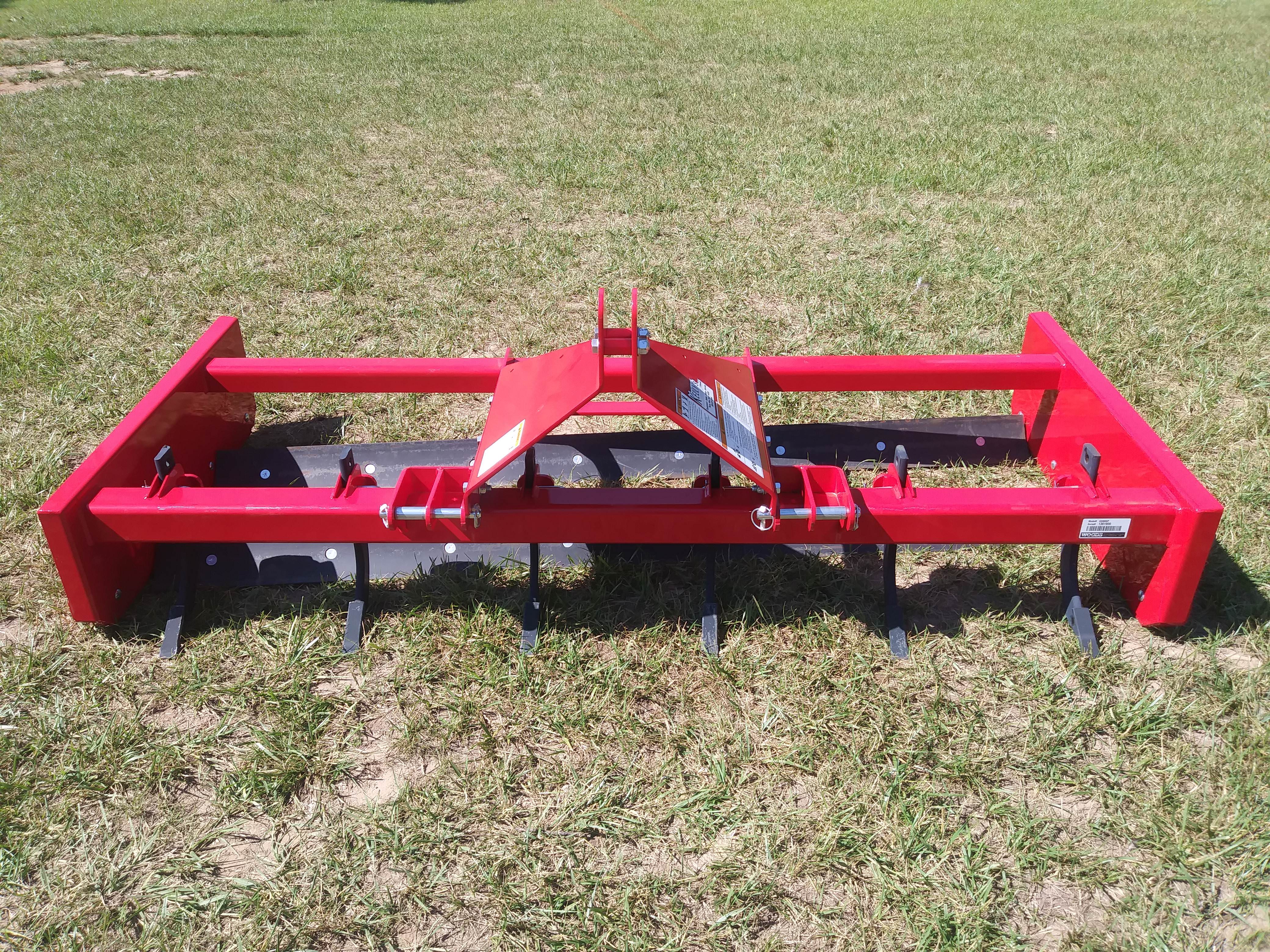

I'm in the market for a grader scraper for building and maintaining a crusher run driveway. Ultimately I'll have about 1700 ft of stone driveway to maintain.
I have been looking at all different brands of grader scrapers (I've read a ton of forum threads on the subject), and it seems most dealers nearest me carry Woods. I'm thinking I want a 7ft wide model to use with my Ford 4610 SU (with front weights). The model I have gravitated to is a Woods GSM84, the local dealer wants $1962.00 + tax. I do want one with scarifiers. They have GSS72P in stock that I could probably get for about $1800.00 total, but I think that unit is too light for my tractor and the work I want to do with it.
This dealership is notorious for price gouging, however I'm so close I can drive my tractor there to hook up etc, so that's convenient.
Just wondering what people have paid for these recently, most forum threads on the subject are a few years old. I'm looking at about $2134 total for the local dealer Woods unit, about ~$250 more than if I were to order a scraper from Everything Attachments. (However they say on their website that their cutting edge hieght is adjustable, but I'm not seeing that from the pictures/videos).

OK - Woods makes excellent implements. The price you were quoted for the GSM84 sound pretty competitive. Your tractor should be adequate to handle that land plane grading scraper.
The LPGS is perhaps the easiest implement to learn. More or less - hook it up and go. The major adjustment will be with the top link.
Properly adjusted it will do the job you want with the substrate.

My 84" LPGS pulls easily. Think about it - my two "blades" are set 1/2" below the side panels. So at the maximum the unit is scraping off a half inch of whatever - soil, gravel, etc. Now when I lower the scarifiers - it can become a harder pull. However - my tractor is 4WD and even with the scarifies at their lowest setting I've never felt it was a difficult pull.
If the scarifiers find my basaltic lava bedrock - well, that's an all different story. I've, so far, never damaged or bruised anything but I'm always on "high alert" when I go with the scarifiers down.
I don't think you will have any difficulty pulling an eight foot LPGS with your 4610SU. You will be working with substrate - which the unit should handle easily and you don't have to worry about large boulders or bedrock.

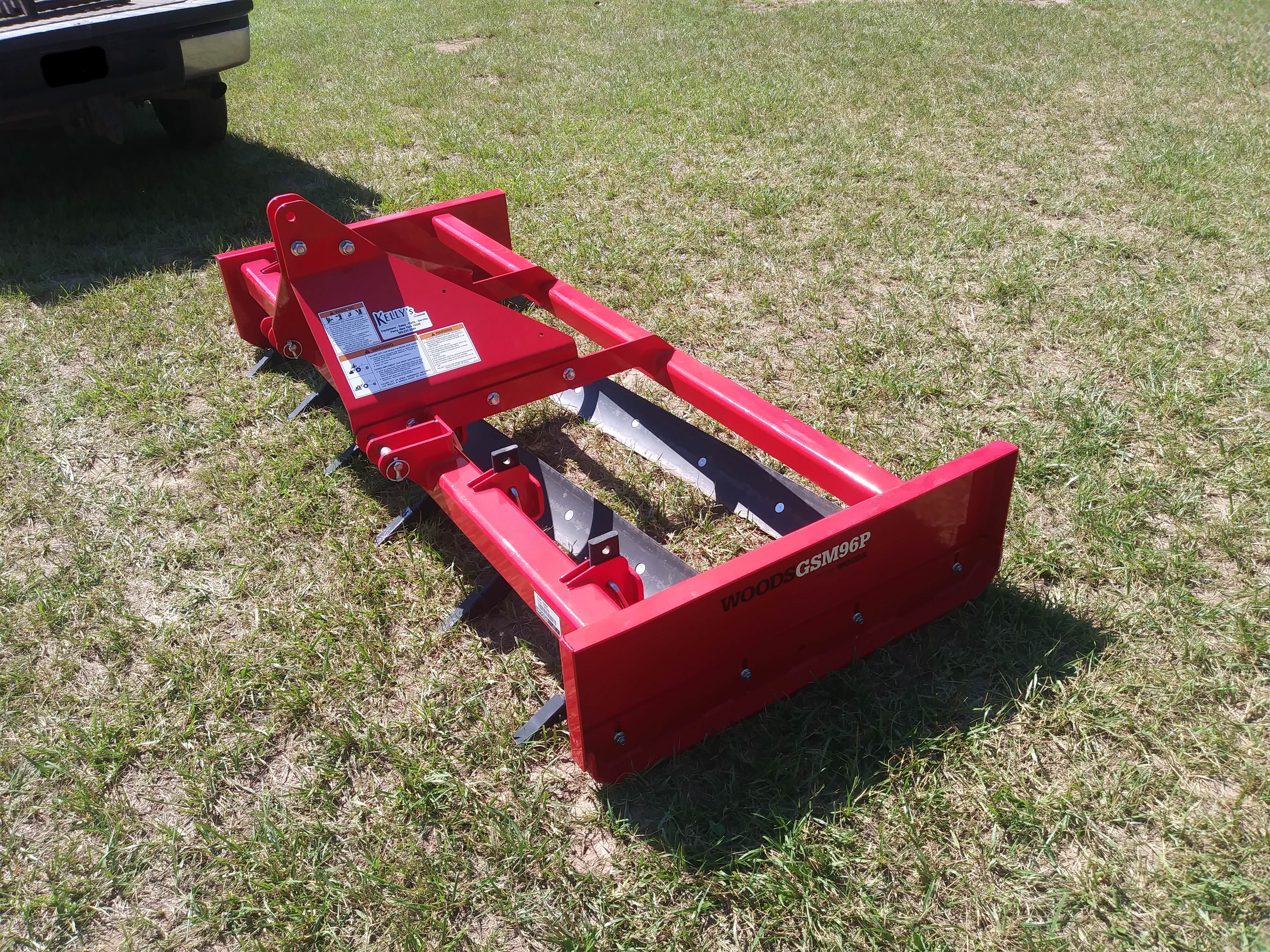

Well, I have decided to go with the Woods GSM96P for $1650 + tax. Much better deal than I would have gotten from my local dealer, plus I get to pick it up today as opposed to waiting 4-5 weeks.

I got a chance to try it out this weekend, here are some pics: Woods GSM96P - Album on Imgur
I think I got the hang of it pretty quickly, most annoying part is all the rocks in the substrate, after each pass have to go pick them up.
My 4610SU pulls the unit without any problems. One thing I didn't expect is that the leveler pulls more dirt than I expected, I can somewhat move dirt around like I do with my box blade.

Nice pics. Just wait until you get the hydraulic top link installed again. Even as useful as that is now, it will be twice or more as useful with hydraulics.
