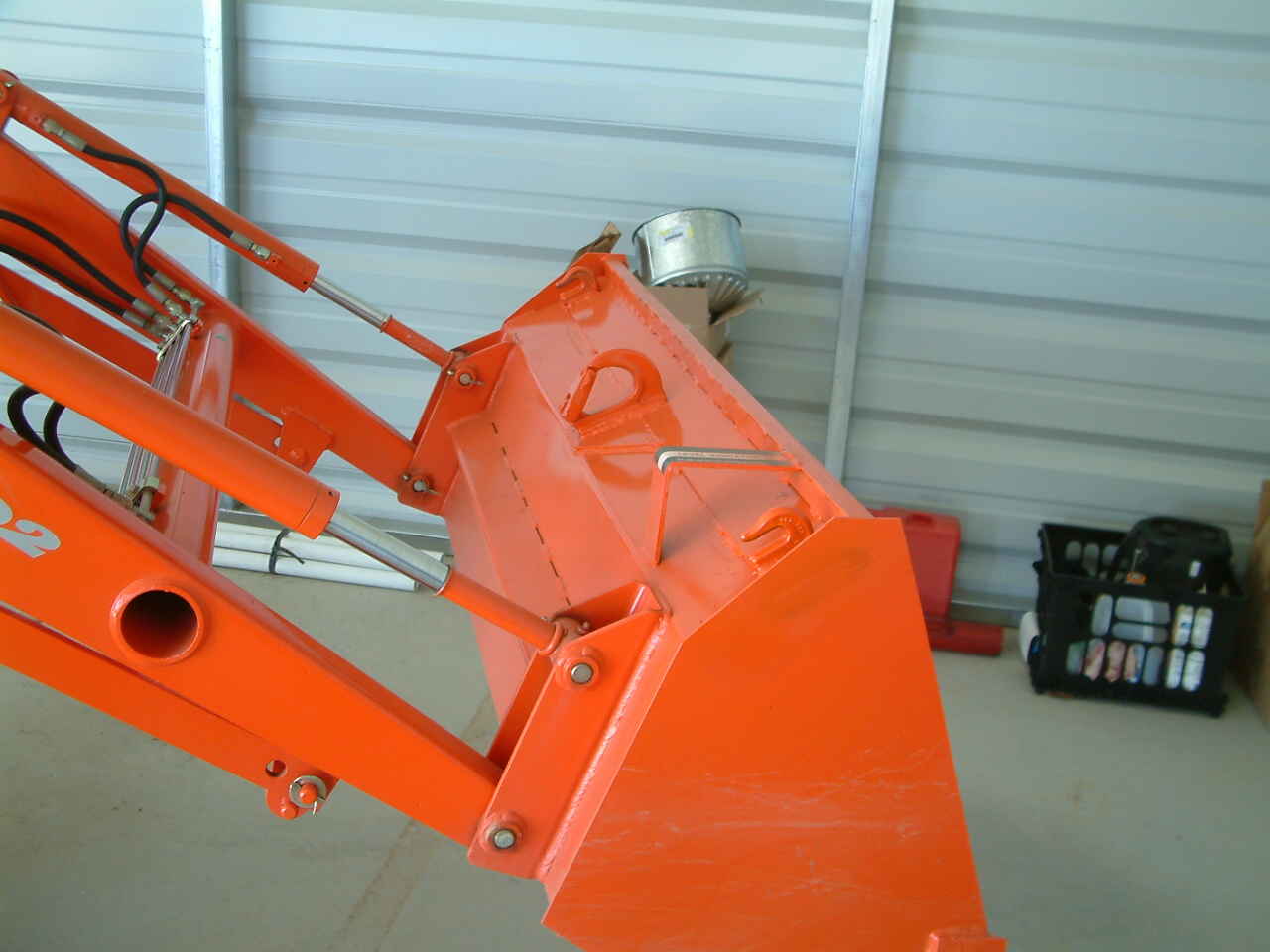

If you look close you can see the hooks on each end of this bucket. We also installed them on the factory bucket as well.

Redneck Randy you have slip hooks not grab hooks mounted on your bucket. Some people prefer slip hooks, some prefer grab hooks. Some people will mount grab hooks on the sides and a slip hook in the very center of the top lip of the bucket.
My personal opinion is that hooks should not be mounted on the bucket corners because if you are pulling with only one hook you can bend/tweak your loader out of square so that your loader arms are not parallel. :eek: Once that happens the loader arms will never be bent back into square. This is probably more likely to happen on a smaller tractor (anything smaller than ~45hp)
I prefer to mount grab hooks in line with the loader arms. You can still tweak your loader out of square, but the chances are lower because you are not able to put as much lateral/twisting forces on the arm if the hook are in-line with the loader arm verses being mounted all the way out onto the bucket corners.

I have two hooks mounted in-line with the dump cylinders. Like Bob has said if you pull from only one hook with them mounted that way, there is a high likelihood that the bucket could twist. That is why I make a point of always hooking to both hooks. With two hooks you can keep things from turning, that is one of the reasons that I have them where they are.

That's good to know. I will weld the grab hooks inline with the loader arms. The slip hooks are for light lifting. I loaded a small trailer I have with a bunch of junk for the dump with things like an old striped down riding mower (no motor or tires), an old BBQ. Glad you guy's told me about warping the loader. Never even thought about that.
Thanks!
