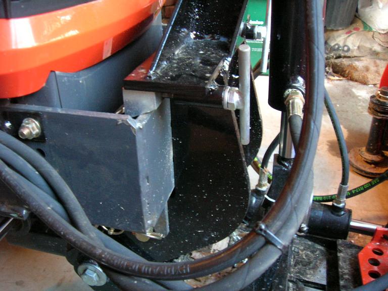

I purchased the lightly used BX2763A plow today that was on the Hartford Craig's List for $1200. The ad was circulating around here earlier this week. The seller had no instructions, so I was hoping I could get a few questions answered.
1) The plow and sub-frame came off a BX23. I assumed that it would also fit a BX24 too? (if it doesn't, I'm in "vedy, vedy deep s...")
2) Does the silver Kubota brush guard have to be removed in order to mount the sub-frame?
3) There are 2 horizontal sleeves welded (by Kubota) to either side of the sub-frame. There must be a piece of hardware goes in the sleeve, that permit the sub-frame to hang from the front of the tractor's frame until the mounting rods can be passed thru the frame holes and securely lock it in place. As it is now, there are 2 long non-standard bolts with nuts and washers in those sleeves which allow the sub-frame to hang precariously from the front of the tractor's frame until the rods secure it. What missing pieces am I looking for?

Still don't know what hardware goes in those tubular sleeves welded to the vertical section of the subframe. Could use some help there if you can.
/ Got use 2763A Plow - Have ??'s #4
Those holes are for a wedge type retainer which takes the slop out of the frame to tractor mounting. The brush guard does have to come off.
The part numbers are as below 5 digits-4 digits the code is the six digits that follow. I don't know if they are even needed
qty P/N code
(2) 70001-0763 665136 t bolt
(2) 70001-0764 665137 wedge retainer
(2) 70001-0765 665167 nylon peg (inserts in t bole for locking
(2) 1/2" lockwashers standard split washers
Here is a pic.

Thank you, sir! Picture is worth a thousand words. That's exactly what I'm referring to. I'm headed to the dealer tomorrow, and your assistance will save us a lot of time searching for the P/N's.

What is the nylon peg #70001-0765 665167. I am just unsure where that belongs.
Also if you don't mind me asking, JABRONI what did the this stuff cost you and did they have it in stock?
