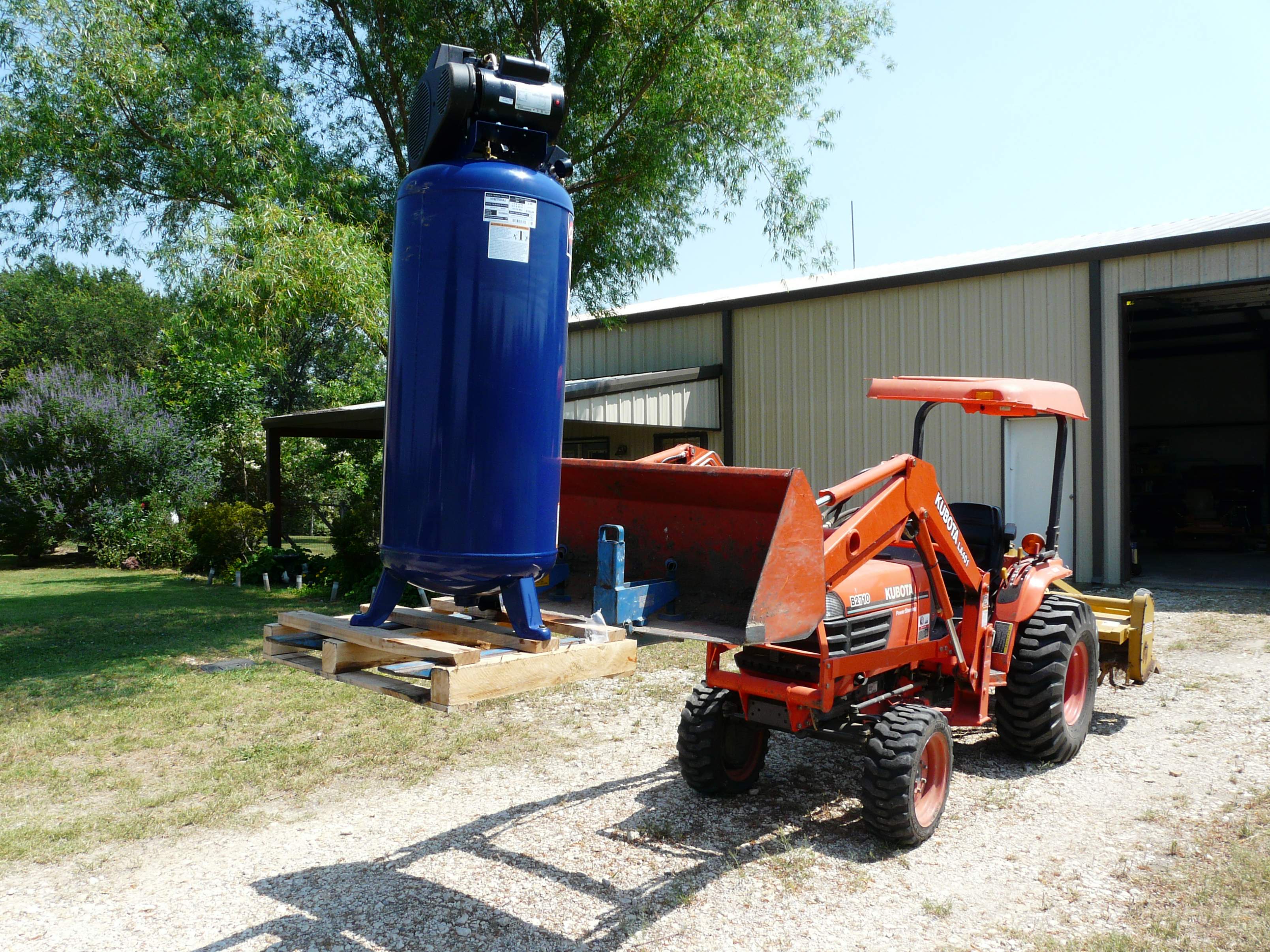

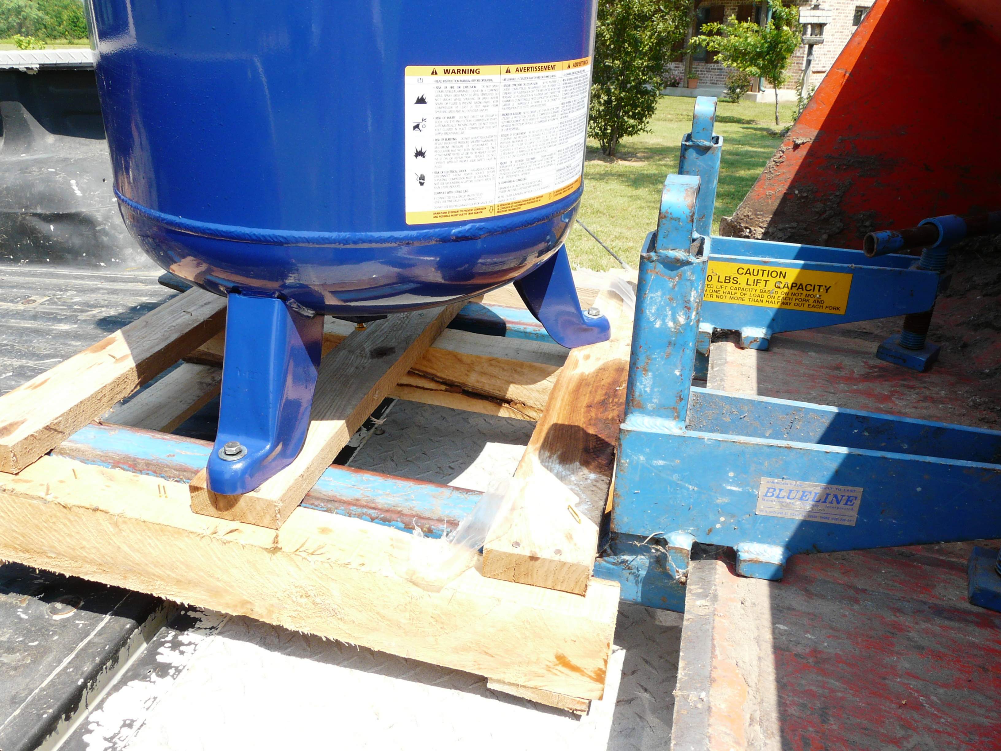

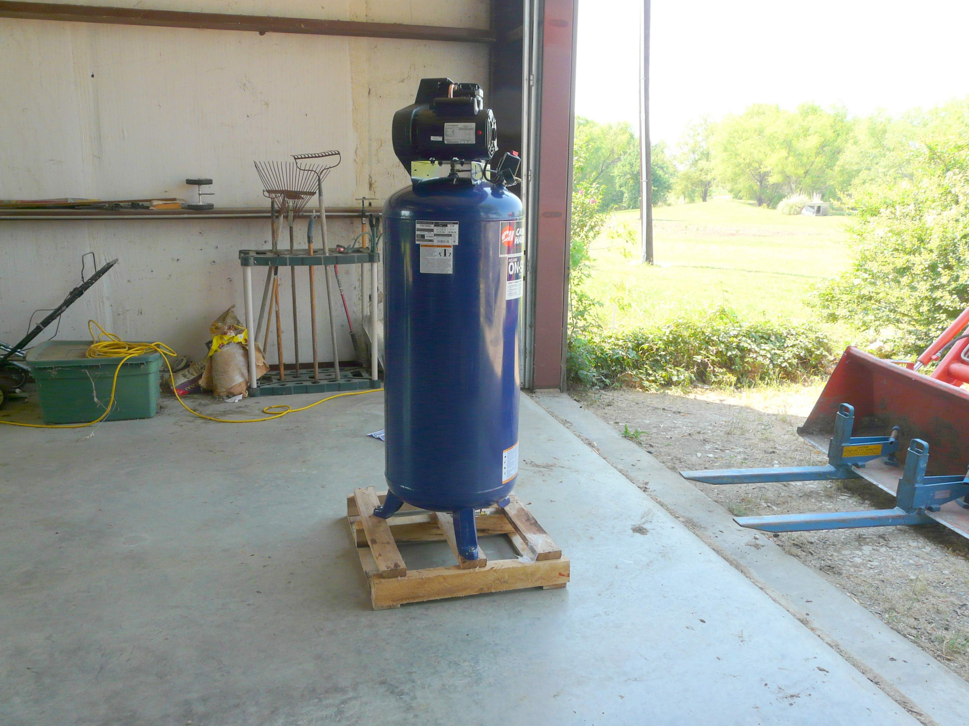

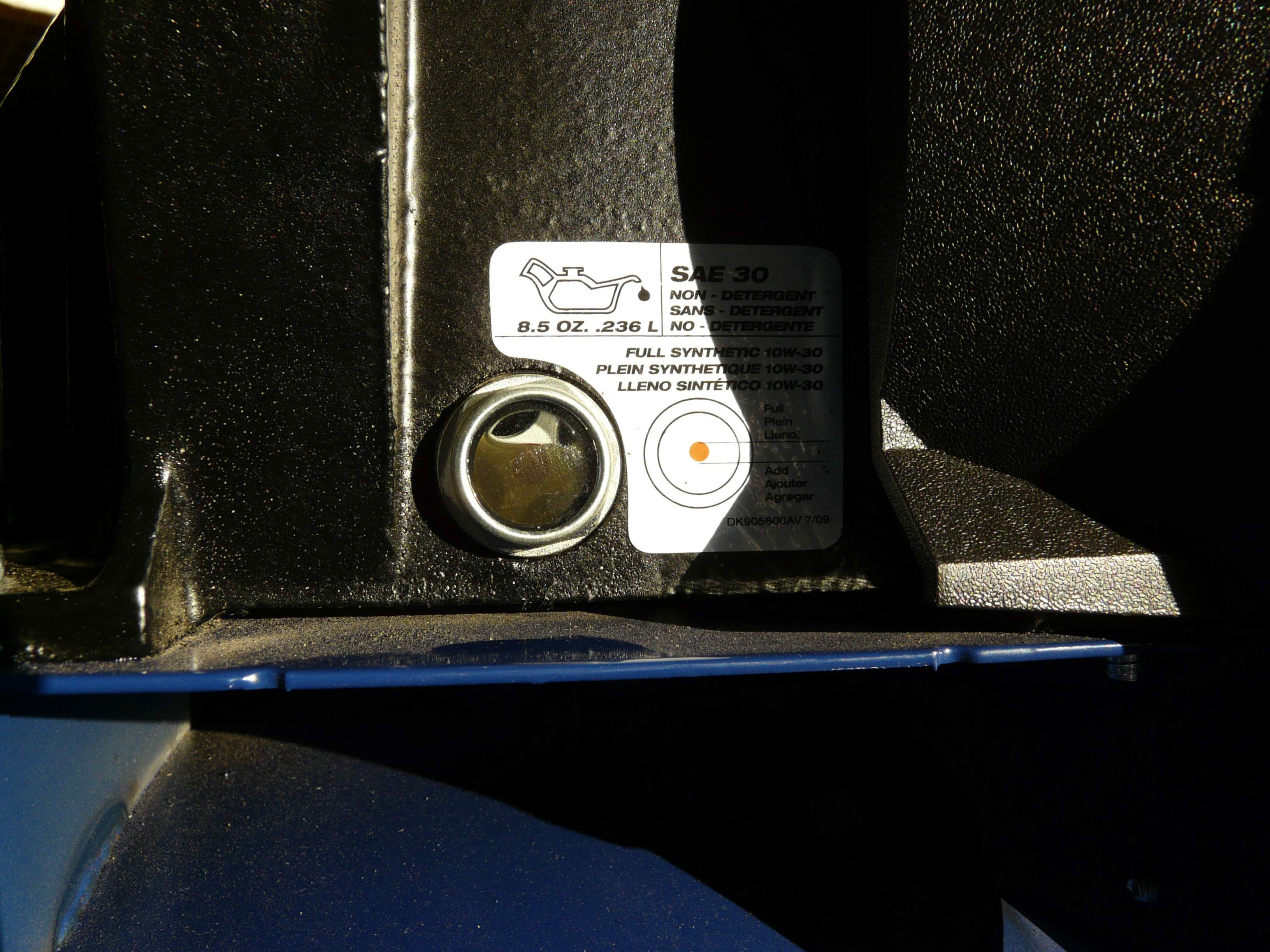

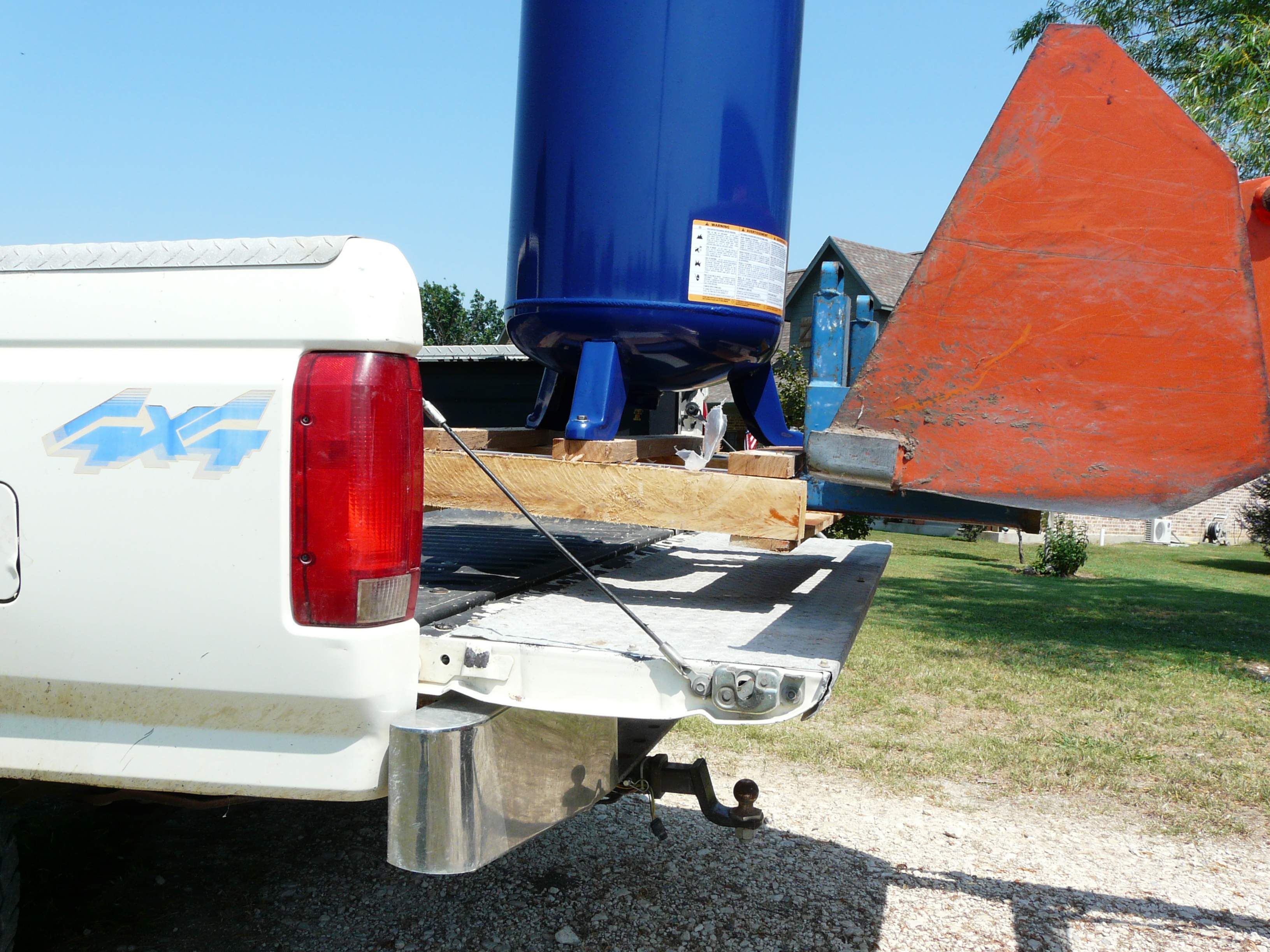

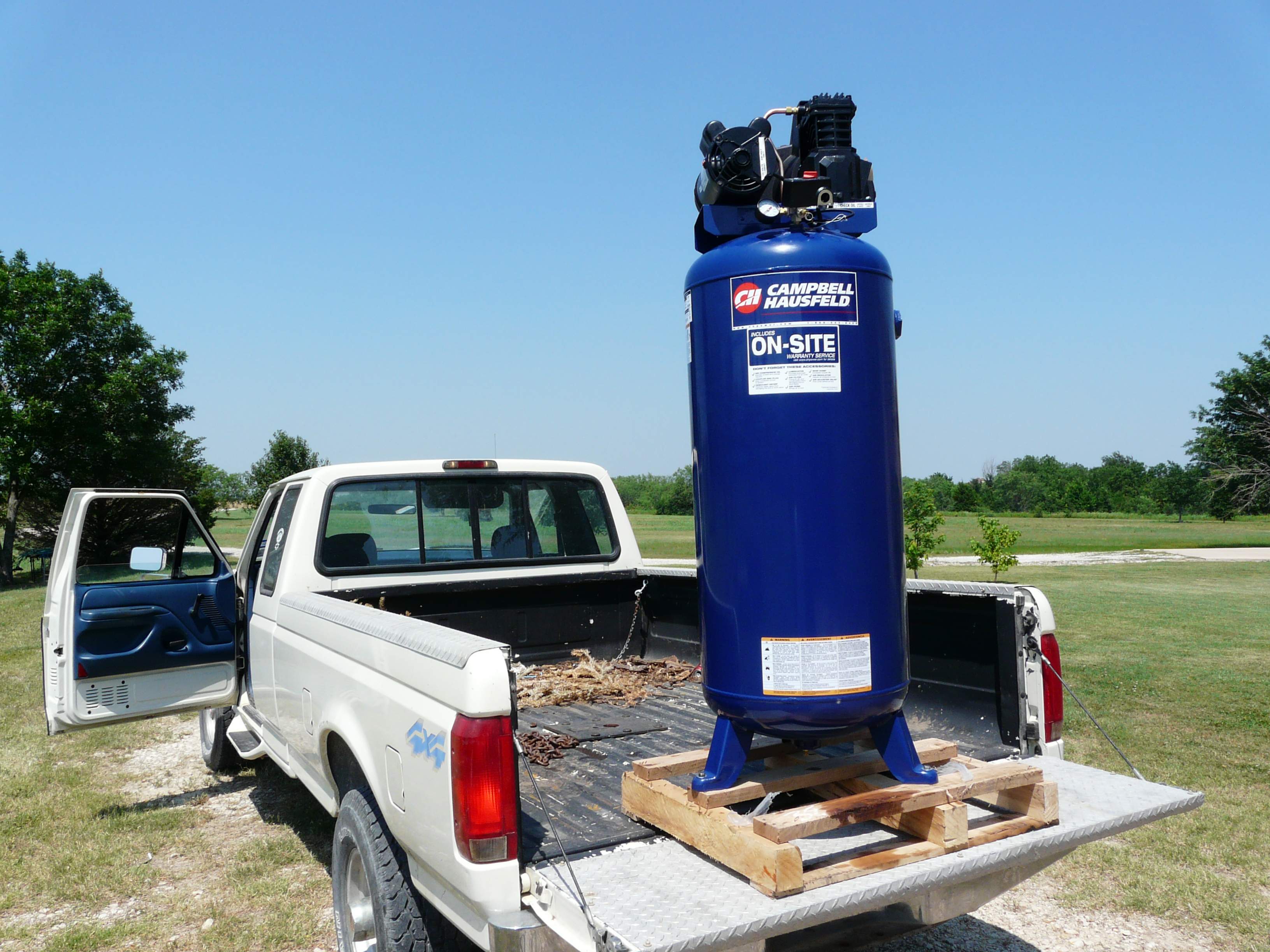

Spent the day picking the Campbell Hausfeld 60 gal compressor at Tractor Supply today. Turns out they didn't have a regulator nor any kind of wiring so I had to go around town picking up everything I needed. Got it unloaded (see pics) and set up, except that I need to figure out where I am going to mount the hose spool, as its in the shop and there are no walls I can screw into and the pearlings are pretty high and not enough vertical surface to mount the bracket.
I wanted to plug in to my 50 amp welder outlet so I went to Lowes, they had a universal plug but no 6/3 wire that I needed. Instead I got a 6' dryer plug with 6/4 wire, cut off the plug and wired to a plug that would plug into the welder outlet. In hindsight, I probably went with too large a wire as it was pretty hard to get it hooked up on the compressor side. But since the breaker is 50 amp I wanted to make sure the wire could handle it.
I had them drain the oil and we laid it on it side for transport, with pallet still attached. It was quite a strain standing it up by myself and I got it unloaded with my forks.
Seems to work great, maybe a little louder than I expected but not near as loud as my old oilless compressor, and won't run near as much anyway. The manual which is completely deficient as to hooking up the wires did at at least recommend Mobil 1 10-W30 oil - 8.5 ounces. Actually I bought a quarter of IR sythetic all temperature oil, which I figure would be about the same. However I was surprised that after the 30 minute break in and a few other cyles today the oil got dark (see pic) so dark it was hard to see the red spot indicator in the glass. Is this normal?
The other concern is that with air cutoff valve, regulator and whatnot there is about 10" or so of "stuff" sticking out the side for the air hose to hook to. Do I really need an air cutoff valve? Not sure what it accomplishess.
The first tank of compressed air had LOTS of water in it. I put a blower on and go most of it out. It was a humid day.
I got the best IR 1/2" impact wrench that Lowe's sells - $179 I think. Its listed at 600 fp. I opened it up and the lack of useful documentation is ridiculous. Virtually no information such as, how much oil to squirt in there before use, what kind of oil etc? I squirted a little 3 in one oil in there and spun it a couple of times - very quiet. There are 4 different powers, but the documentation does not mention the relative power of each setting.
All in all it seems to work great, but I will probably go ahead and put Mobil 1 oil in it at the first oil change. The manual doesn't say when to change the oil the first time, or at least I couldn't find it.

Alan,
Looks Good :thumbsup:
Kinda surprising on the regulator (not so much on the cord ... :confused2:)

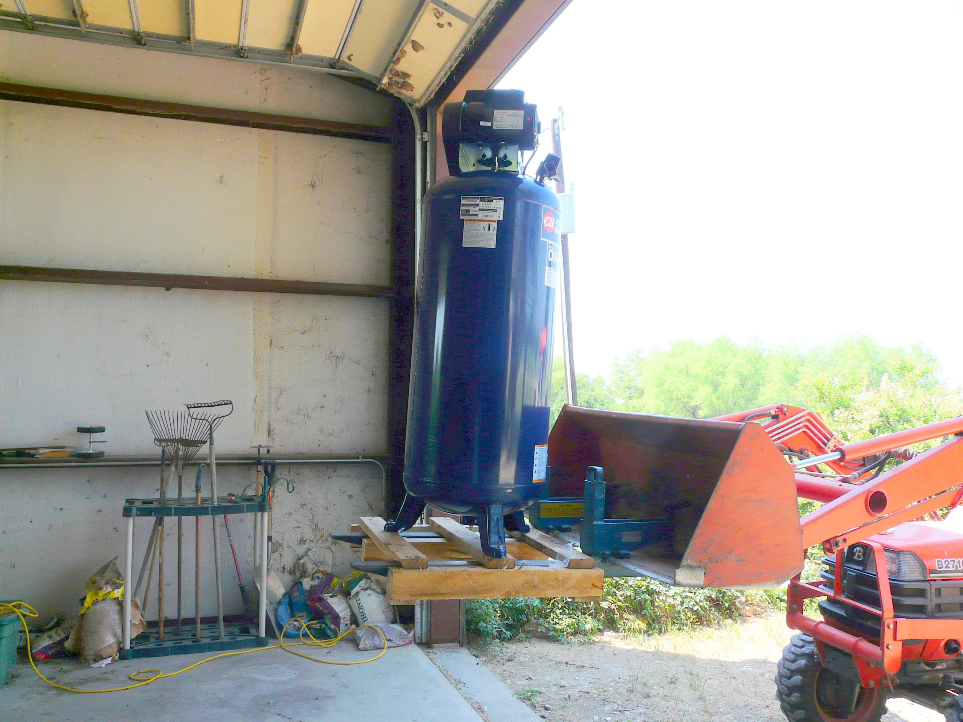

SGot it unloaded (see pics) and set up, except that I need to figure out where I am going to mount the hose spool, as its in the shop and there are no walls I can screw into and the pearlings are pretty high and not enough vertical surface to mount the bracket.
How long is the hose on the reel ?
I'd try to mount it high - and in the center of the work area.
Interesting .....
Be careful using synthetic oil ....... in doing some research on .... I think it was filter/regulators (... but could have been painting ....) some synthetic oils will attack the plastics ....
I'd change it sooner rather than later - after a little bit of run in (1 hour ?) .... particularly given the way the oil is looking.

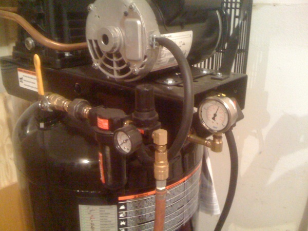

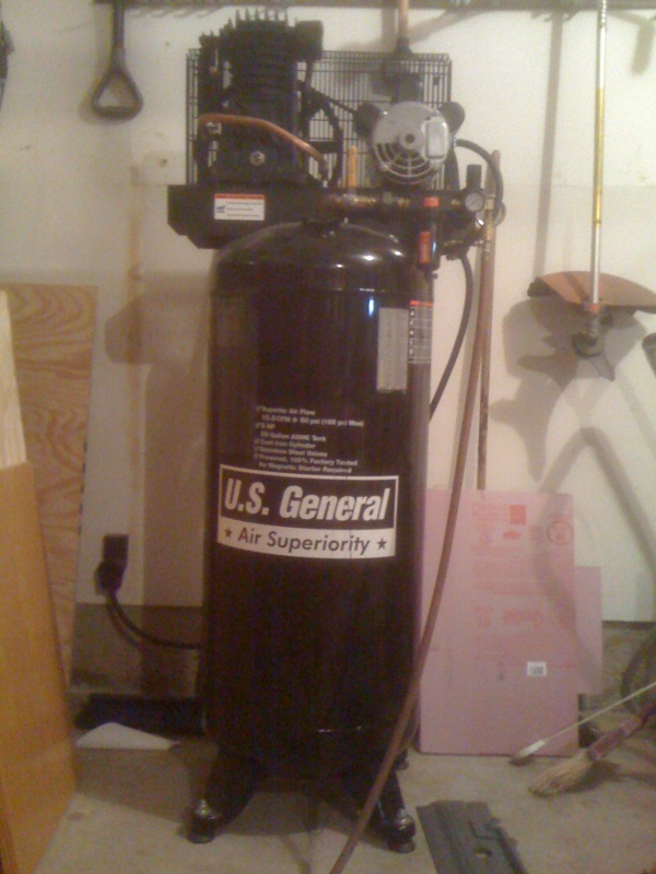

Pics of our new one attached below .... unfortunately my iPhone takes pretty crappy pics in low light :laughing:
Note the difference in the tank pressure gauge (@125 psi) and the regulator pressure gauge (@ 0 psi) - the regulator is actually set to 90 psi .... but all the plumbing (filter, regulator, quick-coupler) downstrean of the cutoff valve leaked down to 0 in about 6 or 8 hours .... (the quick-coupler is a harbor freight unit, and is particularly leaky) ..... that's why you might want an air cut off valve.
That surprises me, too. I change oil in my compressors about once a year or year and a half, but the oil I drain out usually looks just about as good as the new oil I'm putting in. And I, too, use the synthetic air-compressor oil from Northern Tool.
When I was repairing air tools, I used Marvel Air Tool Oil, but now I get Campbell-Hausfeld Air Tool Oil at Walmart. Two or three drops at a time is all you need. As far as the power settings on the impact wrench, all they do is reduce the air flow volume. Almost no one turns it down from the maximum setting. If you're loosening something, it really makes no difference and when tightening, if you need less power, you just don't hold the trigger as long. I don't know of an impact wrench manual from any company that tells you what torque the different settings provide. But I am surprised about your manual. I thought all the IR tools came with a parts list and exploded view of the parts.

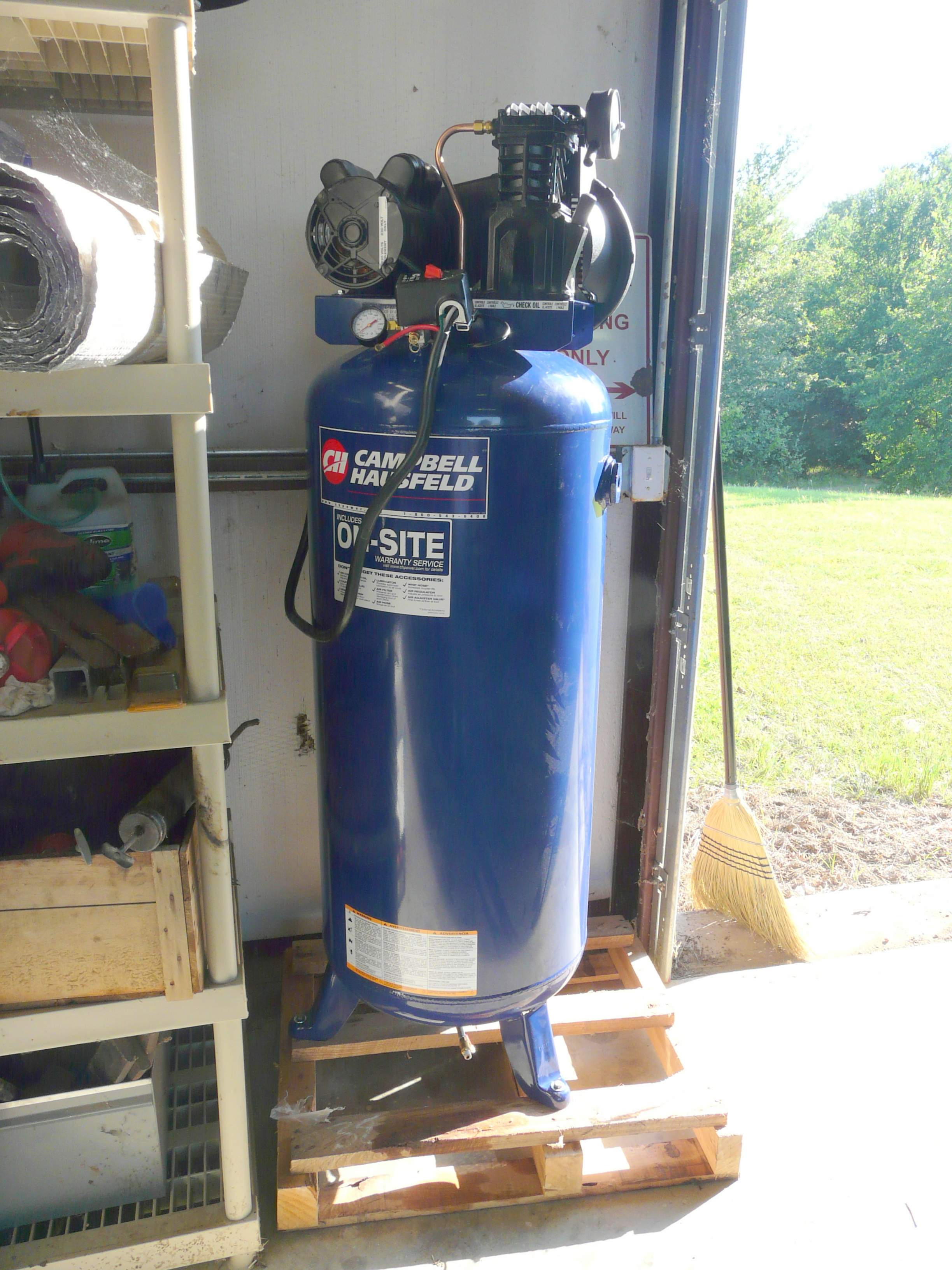

That's a very nice compressor Alan. I purchased a 30 gallon industrial Campbell Hausfeld several years ago off of Craigslist and have really enjoyed it. I really wanted the unit that you purchased and was saving my pennies but came across my current unit and it was local. I got lucky. That 60 gallon tank will give you plenty of volume for most all of your applications.
I needed a compressor that would pull my impact wrench to loosen the nuts on my 6' RFM blades. I got tired of using a breaker bar and wrench. That impact wrench and compressor were two of the best investments I have ever made.
On a side note, I really like your bucket forks. Did you fabricate them?

I would recommend draining the break in oil anyway, but especially if it turned dark. As has been said, it shouldn't do it again, it's not an engine.

The building is metal of course. but only has c-pearlings every 5 feet of height or so. The one five feet off the floor in this location has conduit mounted on it. I will need to screw a piece of plywood to it but there is only a couple of inches to screw it to so it might not be too stable. The steel is fairly thin too, but I guess I could weld a plate to it. Would be more stable if I could connect two of the pearlings, which I can't do.
