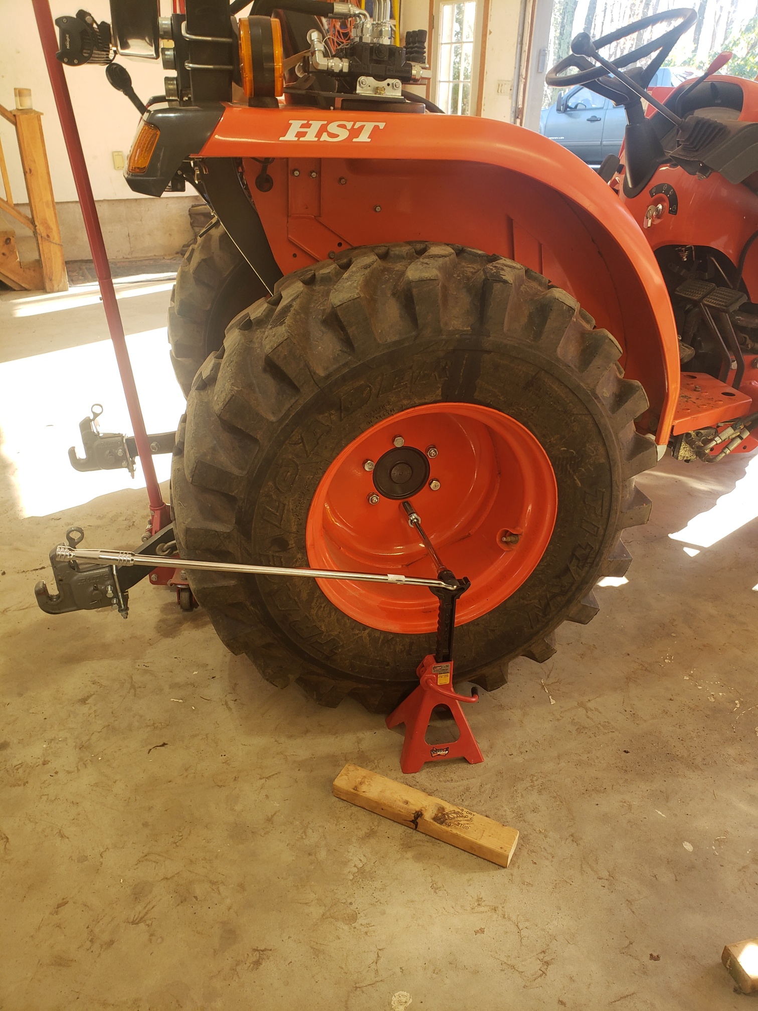

1st thanks again to Lennyzx11, the jack support under the wrench made is easy peasy both getting them off and torqueing them back on:
That jack support looks like an idea I can use with my truck lug nuts. My concern is in breaking the 1/2" breaker bar or the star wrench when out beside the road. When I do break one loose, they just pop.

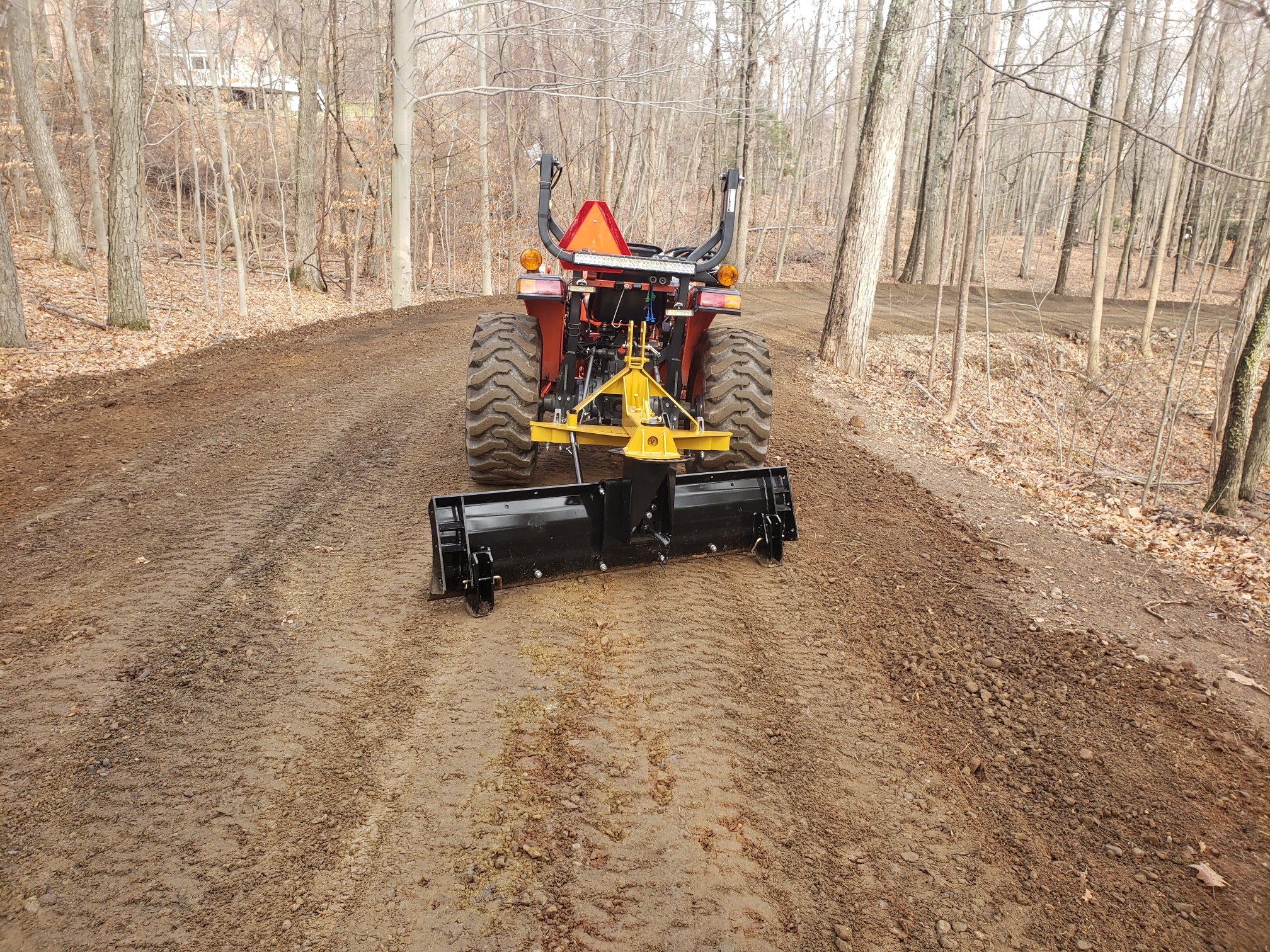

... I couldn't resist doing some finish grading of the driveway. I just put on the shoes for the back blade and its been raining the last couple of days so the driveway is thawed.
Wow! That is one nice looking blade! :thumbsup:
I just picked up an old Ford 782A blade. It still has some paint on it but not as pretty as that one. :D
I have a mods in mind for mine--A rake attachment and hydraulic angling. I'll spill a little paint on it after. ;)
I carry a 3/4 drive breaker bar, short extension an set of 6 point (impact) sockets in my truck, because I tow, and at time I stop and help stranded motorists and the tools supplied with vehicles suck....

Lots of interesting ideas. I particularly like the jack stand use.

Another option - torque multiplier
Amazon.com : torque multiplier
Not a big fan of amazon, but the Torque Multiplier is the way to go! My Dad showed me his after he changed out his flat tractor tire, and he was almost 90 years old.
I got one, used it once and now the tight nuts around here are afraid to give me too much problem because they know I have one!
Understand your opinion of the big A. torque multipliers come in various styles, the big A photos help you recognize one at better auto part stores, garage sales, pawn shops or auctions
