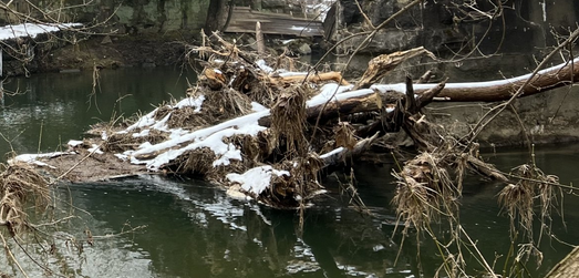

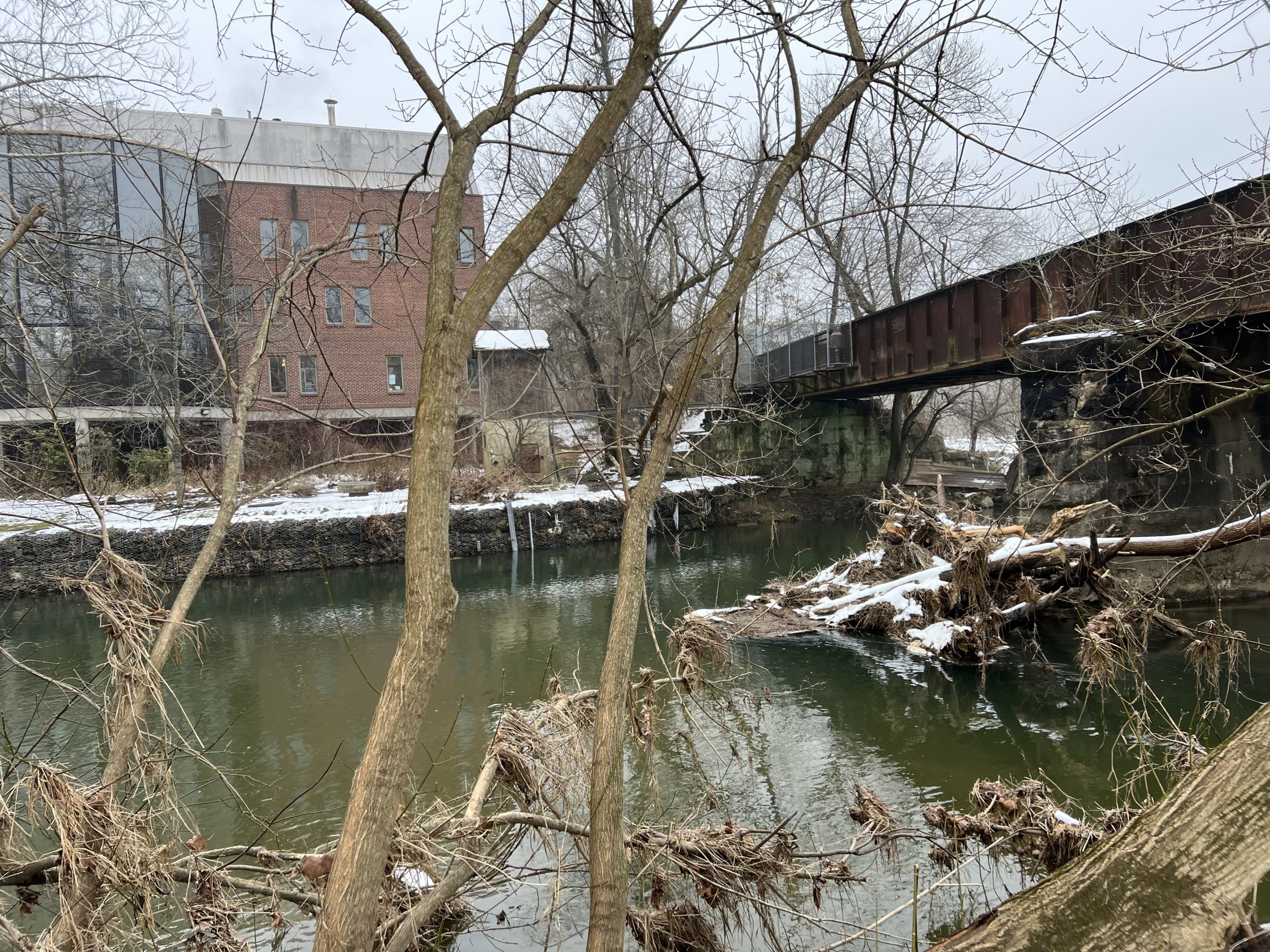

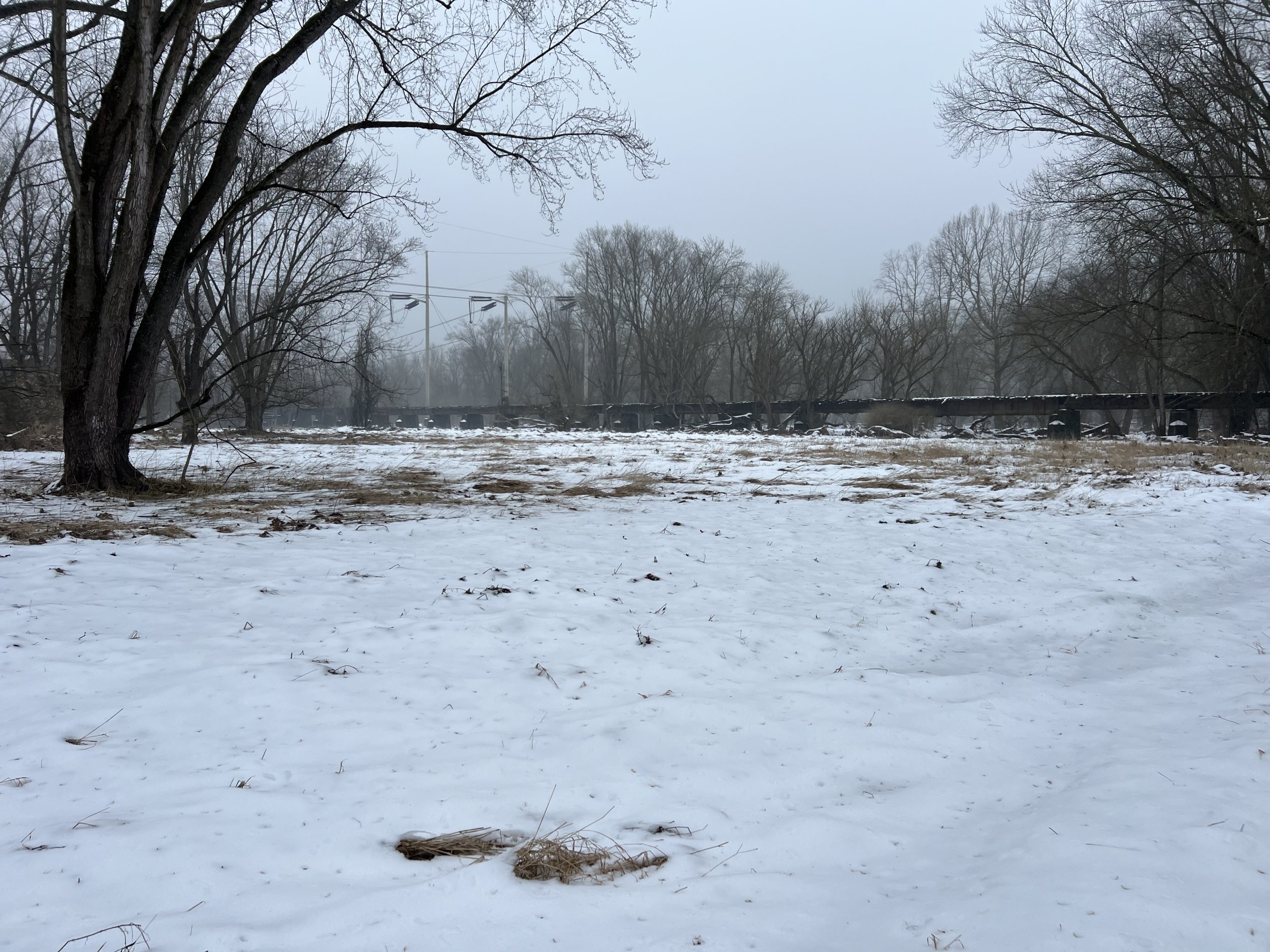

Yep, I think it has more to do with someone’s view out of the window.
So here’s the “view from someone’s window”. About 100,000 people pass by these windows each year. The museum wants to keep the flooding risk as low as possible and the people visiting probably would rather not look at this tangled mess.
This is the log jam from the other side of the river. You can see mud/silt starting to build a small peninsula in front of the log jam.

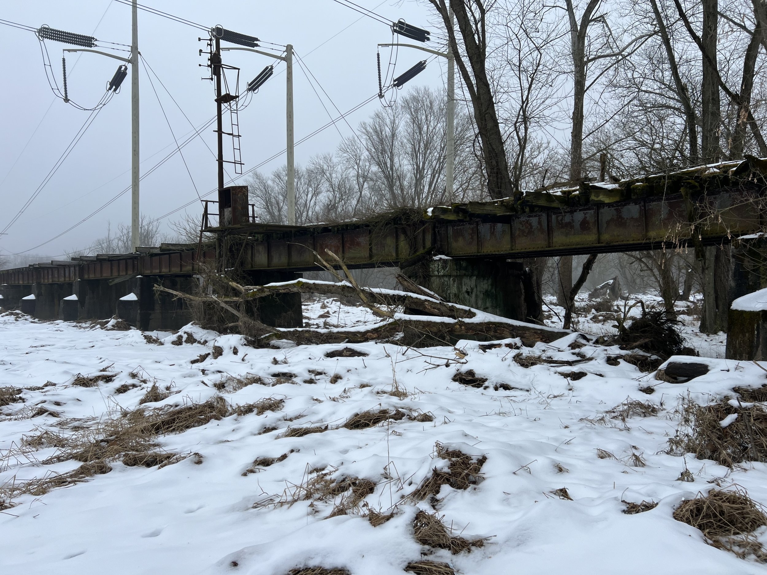

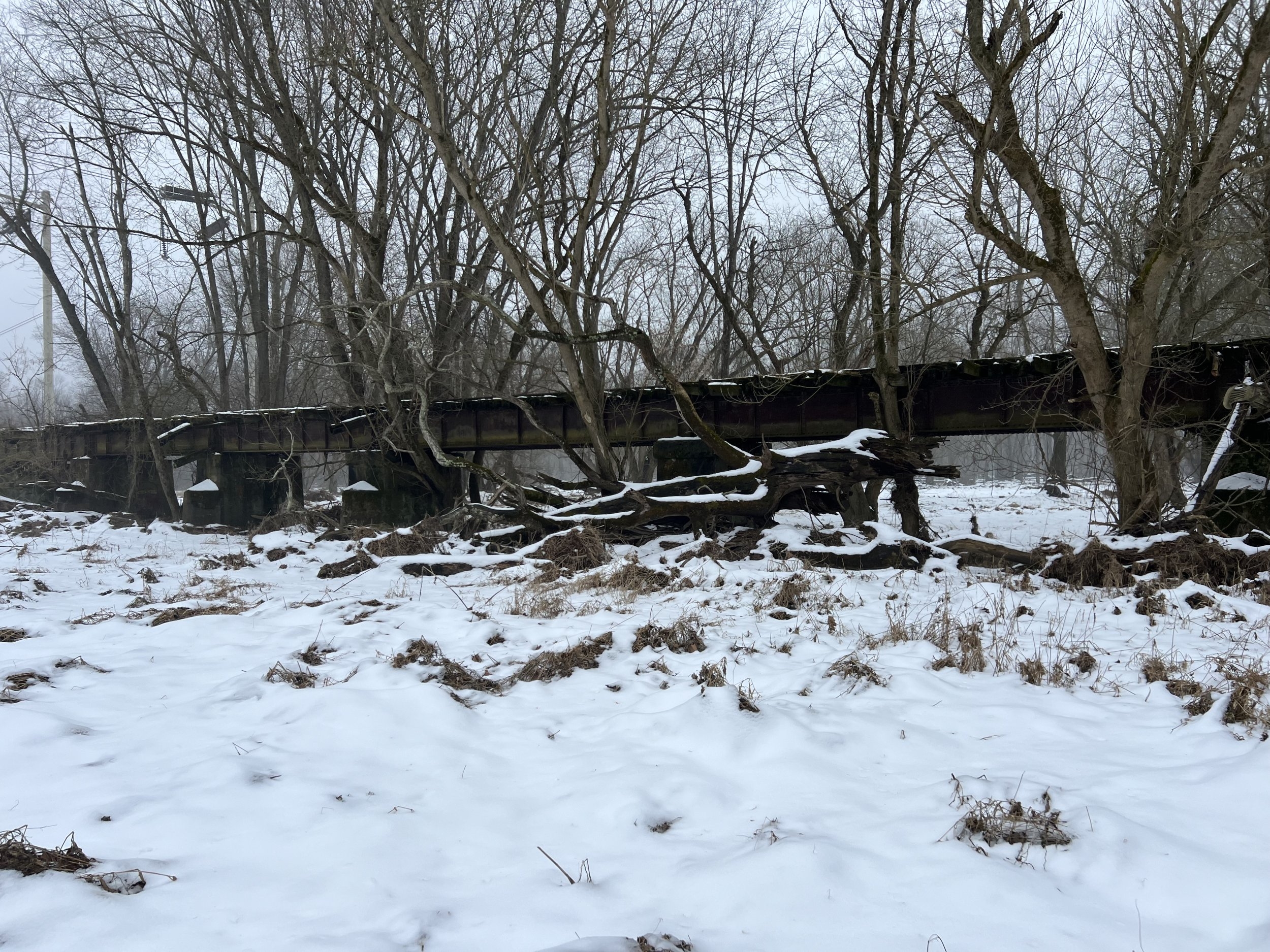

Here’s some pictures of the flood plane and more of the scope of the project. There are several rail support piers about 10-12’ tall on the flood plane. Some have large trees which catch more floating trees and branches, backing up the water and reducing flow.

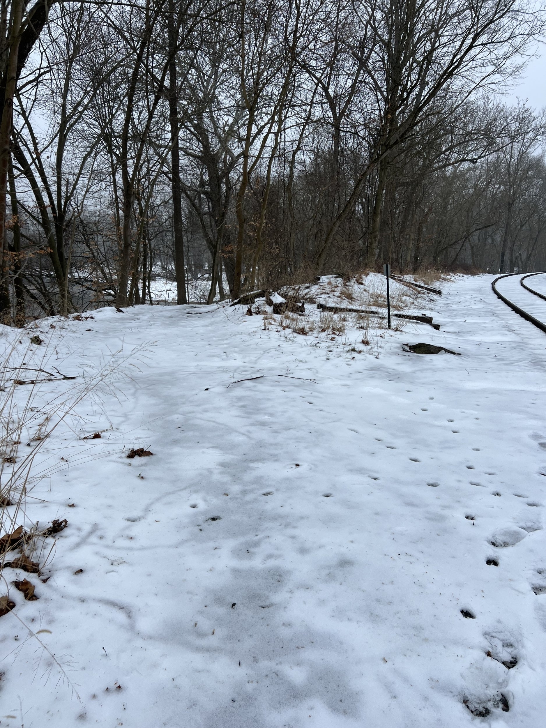

I *think* I might be able to get a wide track excavator with thumb down here to clean up this part. There IS a access road to this area. The issue is crossing the currently active East Penn Railroad tracks.
A little closer views
It was a sight to see when trains ran on this raised track. I can remember it as a little boy.
Luckily, the power lines are largely out of the way.
There is an access road. You have to cross a nearby active railroad to get down there. You can see the active rails to the right of the “ramp” trail that goes down to the flood plane.

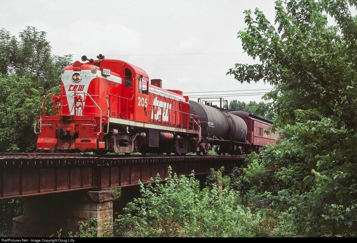

Here is a photo of the last incursion onto the rail bridge in 1987. This was a rescue mission to retrieve a couple stranded rail cars before the condition of the rails became impossible. Almost 40 years ago
Supposedly, this is a small, lightweight locomotive and they went very slowly.
There’s another picture with a guy at the front railing with a headset on communicating with the engineer about track conditions.
