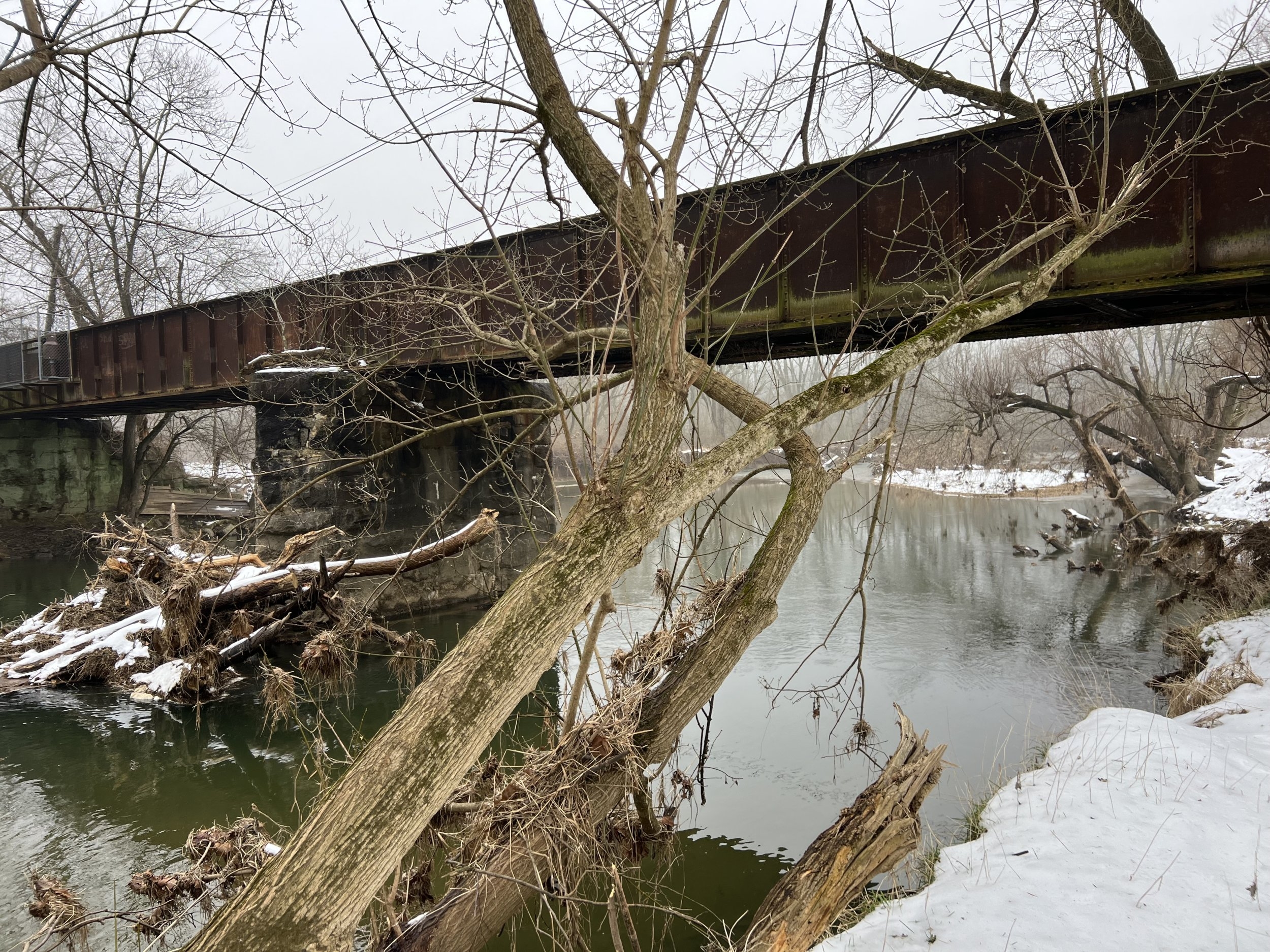

Downstream picture. The river splits into two smaller rivers to go around a large sandbar “island”. Much shallower, too.
If it's shallow and slow downstream at that split, maybe station someone or a net across the river to catch any strays that get away from you.
Just don't tie your body off to anything in moving water. You probably know that. ;)

No access with cranes, trucks, equipment.
A guy walking out there with a rope, ladder, etc they are not going to say much.
Sorry for cornfusion.
I guess it really depends on the status of the bridge. Is it even something that can safely be walked on? Are the rails and ties still there and intact?
That gets back to my earlier suggestion of a small jib crane. Just big enough to pull a grapple across the river and drop it in place, but not designed for taking any real weight. But, enough that you could have someone working the pile from above. Also a setup that you could have a safety harness on anybody that climbs on to the pile.
I'm still curious about everything around the site. There is some kind of a museum. How populated of an area?
Perhaps this is a candidate for a rails to trails project. For some reason foot bridges can be very popular.

The rails are still there but the ties are rotted. It’s unsafe for people to walk on, but it can be done.
Yes, there’s a large Museum there and care must be taken. Little to no population. It’s rural.
There is a plan in the future for a walking trail to connect this museum to a future museum in the planning stages about a mile up the tracks.
Your’s truly will be bidding that job, too.
But first, we have to get the mess cleaned up and the water flowing freely again.
