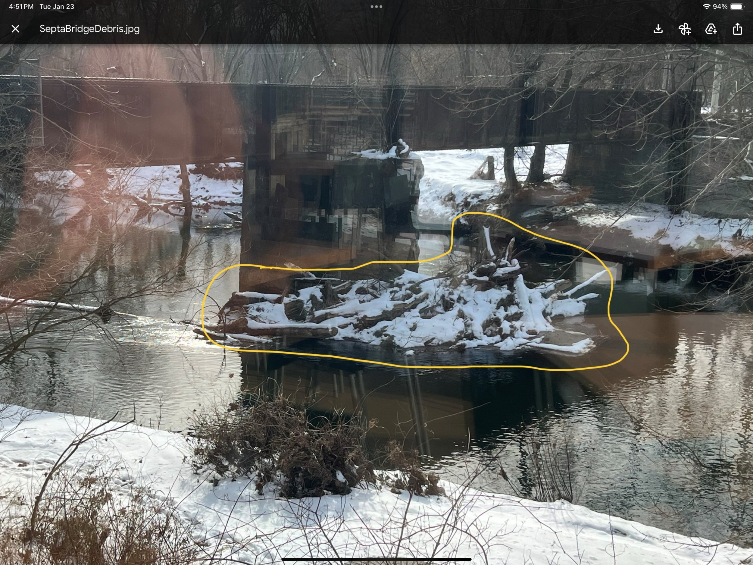

So this is a recently abandoned railway in my town. We have hundreds of them here in the rust belt. Unfortunately, with their abandonment comes a lack of maintenance. I would think they would still have to maintain this, but owner tells me they won’t.
So I have been asked to remove this log jamb.
I have my ideas, but thought some backround information would be helpful.
There is no access from the RR bridge. It is closed off and off limits, so debris cannot be removed from there.
On the right side of the picture, the land you see is mush. You cannot realistically get equipment to the edge of the river from there.
On the left side of the picture, there is a “ledge” of ground. You can get a pickup down there, but not much bigger without cutting/building an access path.
My thought was to rent a crane with a clamshell bucket and an operator and have him “grapple” the logs and swing them over into a waiting debris truck. The crane would sit where you see the foot tracks in the foreground.
Water is fairly deep and current fairly strong. The width of the water from the center of the rail bridge center support to the edge of each bank is about 50’ of water.
Thoughts?
What are the rules for working in the stream?
can you build causeway to get close to pier and use excavator with thumb to remove pile.
crane with clam shell bucket will work but be slow

So, scale of the logs doesn't come across, but are we talking 12", 24", 30+"? If a significant portion is sub 18" a pole saw, on an anchored Carolia Skiff, some ropes, and a machine on shore would do the job. The crane is still probably the single most cost effective route, But I've learned, talk to the crane guy first. Some might be willing to gamble a bit, but most crane operators I know, if they don't feel comfortable, they will flat out tell you "I ain't doing that"
None that I am aware of. Just don’t drown and don’t cut loose LARGE chunks of timber all at once.
No. The reach is over 60’ from the river bank to the pile. No commonly known excavator has that kind of reach.
I can’t be renting stuff from NASA
I’m talking to crane company tomorrow.
The thing about the crane is it’ll cost mucho denero to run.
I think I can do this from the floating platform by picking away with a chainsaw or polesaw. I have both. Know someone with a platform boat already in the river.
Do the same job cheaper so I can make a little more and not have to worry about trucking the logs.
Floating 5’ pieces one at a time in staggered manner down the stream won’t hurt anything.

Note that it isn’t required to remove the logs from the property in the river
No need to “cable” the logs to shore, unless I want to. Cabling logs in a river is a recipe for disaster. Just float them in small chunks
Now the junk under the piers in the flood plane would have to be trucked away and that’s doable with my dump truck and a wide track excavator.
The river log jam is just a small fraction of the work. I think it could be cut into small pieces and floated in a day’s work.
Only thing left to figure out is how to cut submerged logs quickly.

Causeway would be fill temporarily placed in stream to get equipment closer to pier. The closer you are , the smaller equipment needs to be to remove debris.
does water gets low enough to walk to debris with cable to hook and drag debris out

Yes, during dry times of the year. That’s when we will do it.
