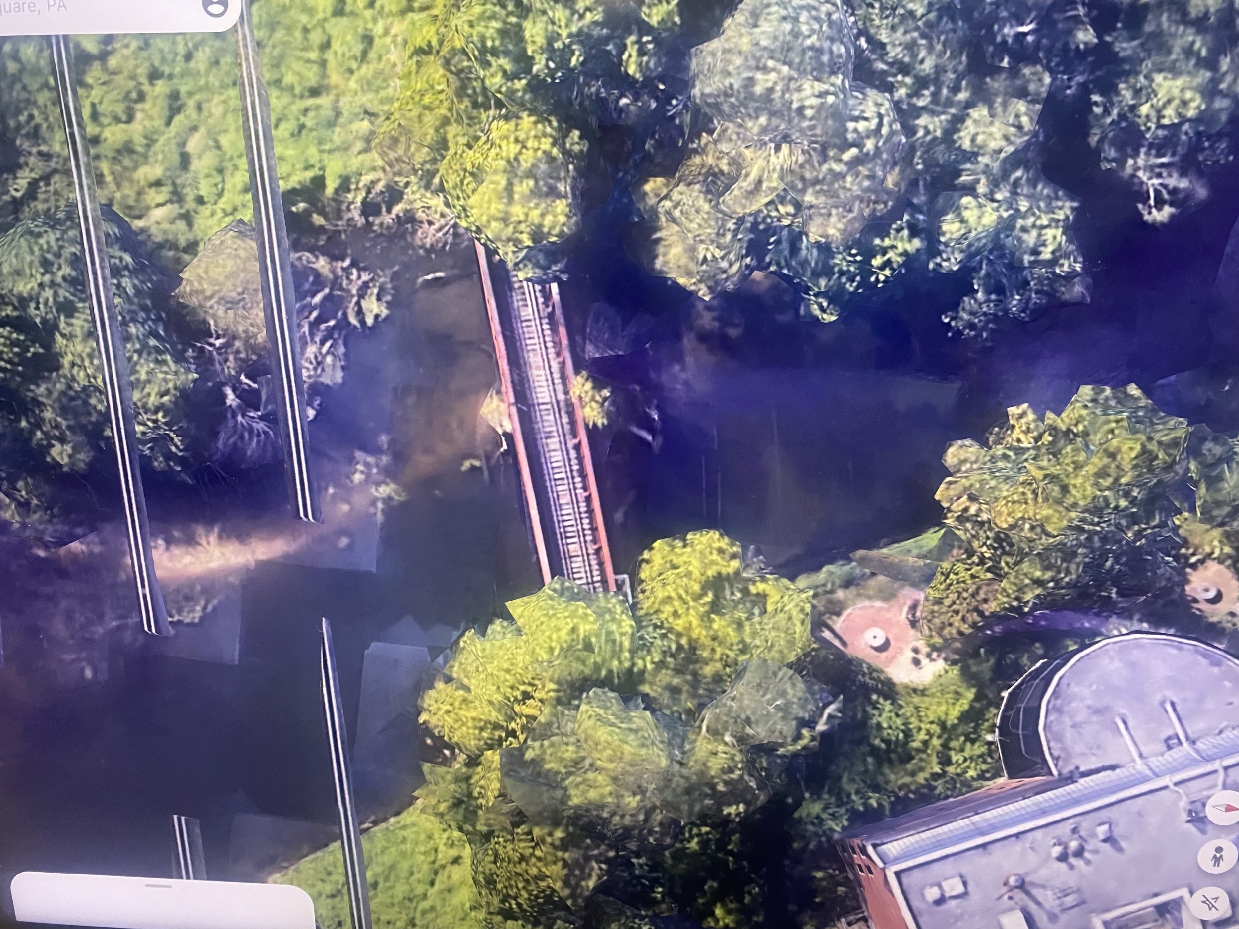

Having done surveys for bridge replacements and knowing how they design bridge heights and waterway openings I can see what’s going on now with that last group of pictures. My opinion is the log jam in the main channel isn’t the biggest part of the problem but the area you are calling the flood plain. When the river is in flood is spreads out and all the stuff in the overflow area is slowing down the flow.
From and engineering point of view for flow what does the other side of the bridge look like? It doesn’t help to do one side if the other side is just as restricted.

Is there a google maps satellite view that shows the whole area?
The other side is fairly clear of debris, but there are “junk trees” growing on the back side, and they catch floating logs, too.
Everything needs to be cleared. Downed trees and live, growing trees.
The log jam in the river is the dangerous part everyone is focusing on, but thats only a small part of the work. By drought season, the river will be 3’ deep and easier to work on. The pictures I took this week are with rain/snow runoff. So it’s deeper than usual.
