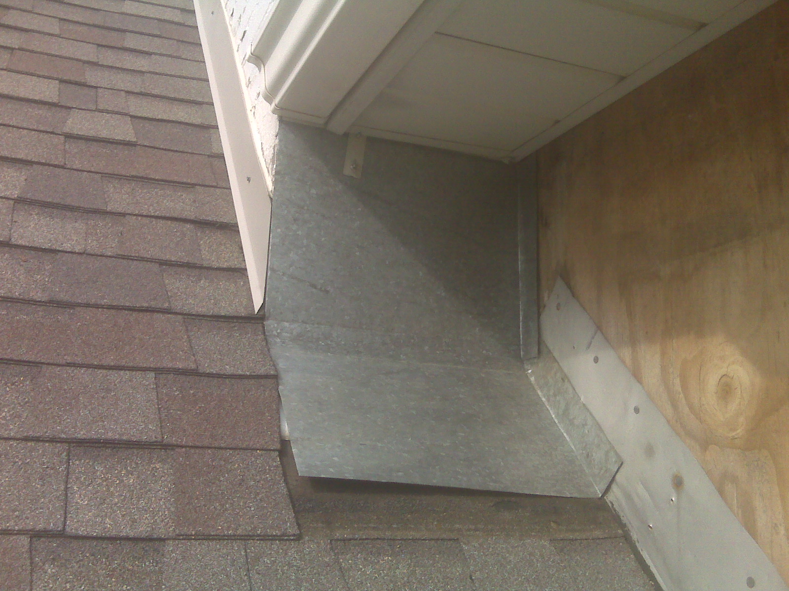

I am planning to stick a 14 inch square section of galvanized flashing to part of a brick chimney that is pretty much bare brick and mortar, only the slightest trace of faded paint, and the chimney section has been powerwashed and given ample time to dry. If I am using one 10 ounce tube:
How many of the guys here say the most effective product for the purpose will be ordinary roofing cement, and how many say PL 400 construction adhesive for decks will have a stronger bond?

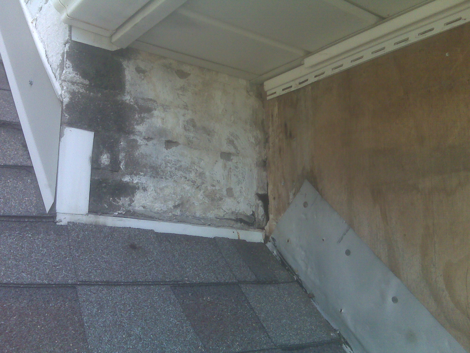

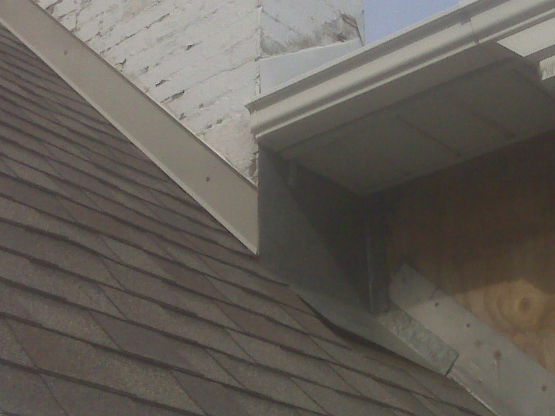

It's kind of a unique situation...maybe the pics will help illustrate my query. The section of roof the chimney is near has a layer of premium shingles only 7 years old. There is a primary roof overhead which drips some water onto the lower roof, and that water wicks lengthwise toward the house siding and sheathing, and there is often a strong wind coming from the east that blows the water onto the chimney bricks. Another picture shows the section of heavy duty galvanized metal I have cut and bent to use as flashing after removing part of two shingles and the siding. While I can nail the flanges to the 3/4" plywood sheathing, I want to stick the vertical 14 inch square of galvanized steel to the chimney bricks. The galvanizing is VERY heavy...a section of 40 year old heating return duct. As JD435Bill noted, the preferred method is to embed it in the mortar joint, but I don't really want to chip out 60 year old mortar. One picture shows the chimney area before I wirebrushed and powerwashed the bricks and removed part of the shingles.

You need to get the flashing to go around the corner and up the side of the chimney to get a good seal. Maybe something soldered up out of sheet copper? Also, the flashing going up the roofline seems to be just sitting on top of the shingles. It is providing NO protection of the joint that way.

IMHO ... metal and brick have different rates of expansion. Trying to stick one to the other is just asking for trouble. Chimney flashing is even a worse case. The building roof moves in relation to the chimney. It is better to allow the movement with step flashing covered with counter flashing. Cut a groove and bed the counter flashing to the brick.

I think the original idea of setting four anchors and screwing it in place sounds the best, especially if it ever needs to come off without taking the mortar with it.
Also, I think you may just move the problem down a few feet with that flashing, as it really needs to run all the way down to the base of the roof, otherwise you are just moving the water problem onto the seam below it. My hypothesis, at least, from to few roofs I've shingled.

Thanks guys...the pics do not show it very well but the side of the chimney is well flashed ABOVE the rain gutter and when I did leak testing using a hose, the only water that entered the house came from BELOW gutter level...meaning the leak was below the gutter. Last night I put that galvanized patch into place and tacked it onto the vertical sheathing after tucking it under the shingles an inch or so, put the hose overhead and not one drop of water entered the house. I am going to use a grinding wheel to cut a groove in the bricks horizontally just below the soffit, then duplicate the galvanized patch using aluminum, then attach that to the chimney using masonry screws and roofing cement in the groove. Danno1, thanks for the idea of the diverter...that would be an easy addition especially now that I have some shingles to replace.
