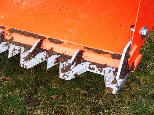

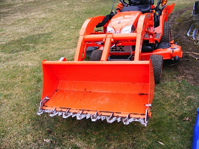

Well! Today I received my "Piranha" toothbar from BXpanded. I read about it on this forum and was impressed with what I saw and read. Since it was not yet listed on their web page, I contacted them by email inquiring about price and shipping to Pittsburgh, PA. Harry promptly answered with a price and ballpark shipping cost. I wrote back and told Harry I was ready to buy and please send payment info and an invoice. I received an invoice and PayPal button to click. I got up early Friday February 10th and---click, bam, paid for in a few minutes before leaving for work.
UPS delivered a nice heavy box this afternoon. That's only 6 days including a weekend and holiday to get my toothbar. Thanks Harry!
It took me longer to get my tools together than to install the unit. I used a 3/4" bi-metal hole saw, well oiled during the drilling process and it worked very well. All of the install hardware was included. A nice touch was the two stickers that you apply after you mark the oval slot so that you can allow for correct placement of the center punch to get your starter hole drilled.
The directions are very clear and easy to follow. Make sure that everything is tight and that the front of the toothbar is level. I raised the front end of the toothbar and pushed before marking the slots.
After installation, of course I had to give it a try. Now keep in mind, at this point I've had my BX25 for a week and a half. Bad weather and a 5 day nasty cold have given me a total of around 30 minutes of seat time so far.
I'm not sure what impressed me the most, the BX or the toothbar. Together they are awsome.
I have a bunch of 2-3" saplings along the edge of the fields that need to go. I first raised the bucket to about 24 inches and easily pushed them over. I then lowered the bucket to ground level and ripped them right out and them pushed aside. The soil is soft, but still, I was very happy. This is going to be fun!
