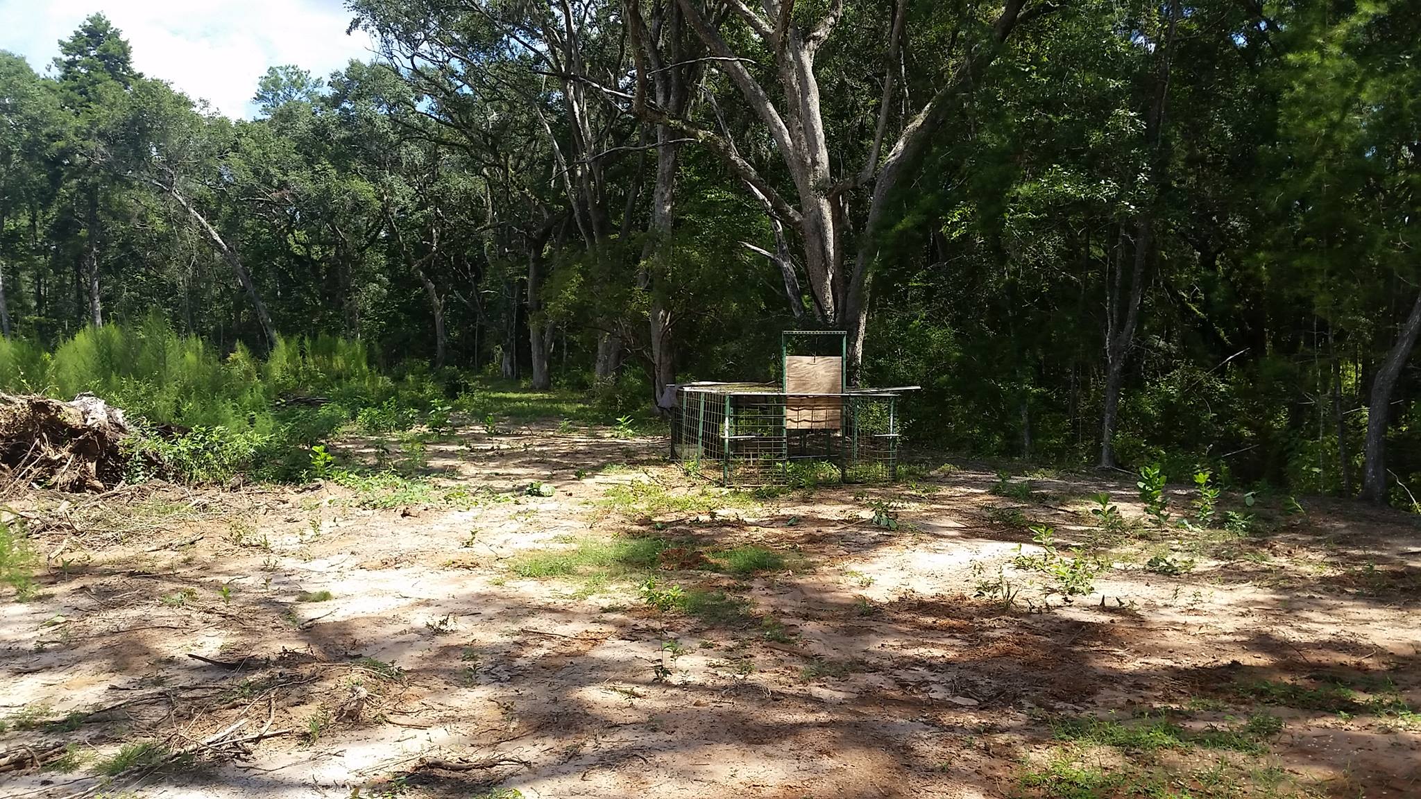

Been having a problem with hogs tearing up my back yard. A friend of mine has this homemade trap set up to try to get them. We just set the door last night but the scoundrels managed to clean the pen out without tripping the door. Hope we have better luck tonight.
This one is 16'x16'. He has it sectioned off in the back so he can isolate a few hogs when trapped and reset the door to try for the rest before getting them out.
