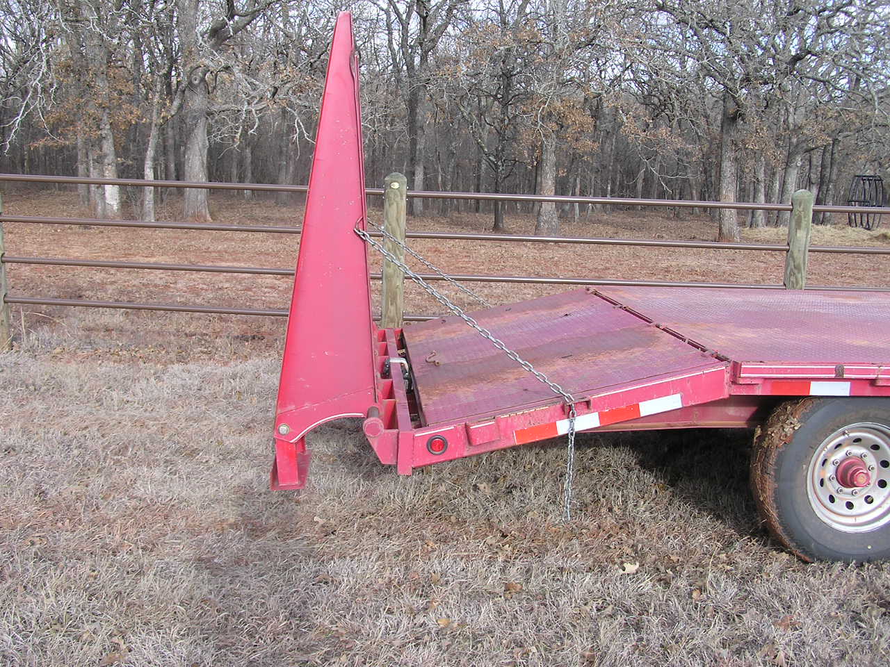

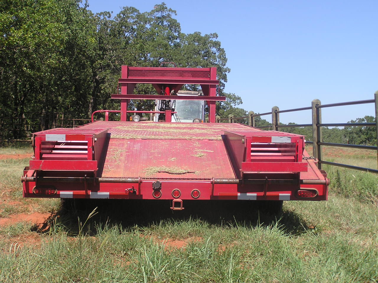

I like the deck height of my equipment style gooseneck. It has removeable fenders and the tires are just barely an inch or so taller than the deck - no problems using forks or opening car doors or driving on a wide-tracked vehicle, just drive right over the tops of the tires. My fenders only have 2 bolts each to remove them, and unplugging the clearance light harness. I have 80" between the fenders.
I built some sideboards to fit the stake pockets so I could haul loose stuff, like firewood last year. I just hauled a large red oak log to the mill on it a couple weeks ago - the small end was 30" diameter and it was 18' long, then another 20" x 9' next to it. Since that was all I had I didn't do anything for sides or pipes, just deck-screwed some 8"x8" wood wedges down to the deck on both sides of the log(s) and chained them down with boomers. I loaded the big boy with my 40 hp Mahindra - had the small end of the log resting on a small log and as I pushed the big log the end rose up to where I just backed the trailer dovetail under it and then continued to push the log onto the trailer using the upright ramps to keep the log centered on the trailer. At the last I had to let the ramps down and keep pushing to get the log all the way on. I could have never done that with a deckover trailer, would have been too high.

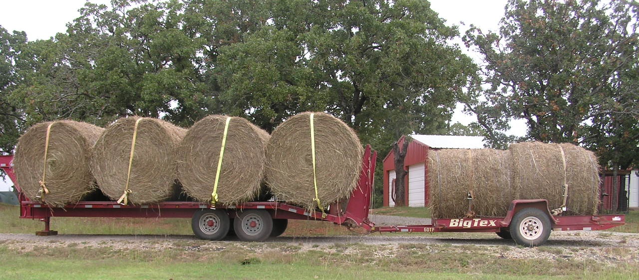

I vote for the deckover gooseneck. :thumbsup:
I worked my way up from bumper pull low decks to this 14K Delta 18' metal deck, plus 4' lift up dovetail with easily removable ramps:
It can haul 8, 5x6 round bales and pull another trailer:
Here it is back in 2006 with 12,640 pounds on the deck and 3,440 pounds on the ball:

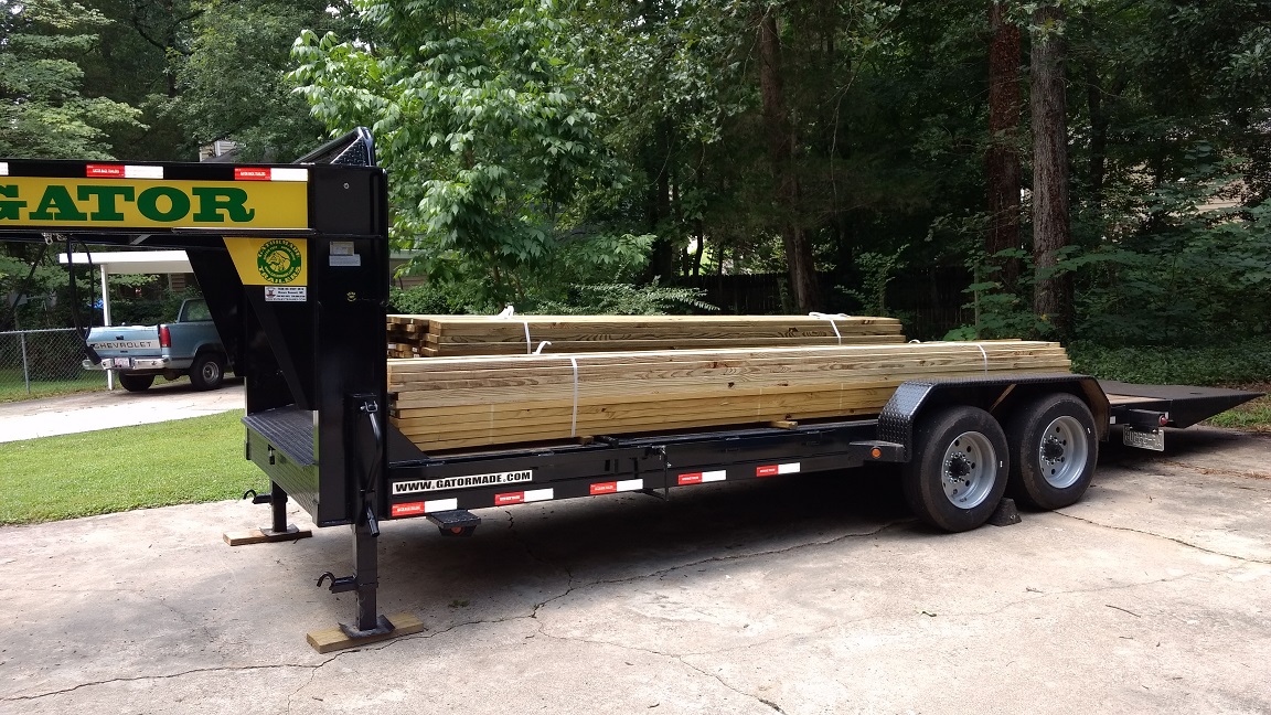

I use a 16K 20' + 4' tilt bed to haul just about anything I need. The lower deck makes life a lot easier for loading / unloading.
And the straight back edge make it easy to load things with an odd number of wheels ....
I have not run into a problem with the fenders being in the way ... Yet ....
