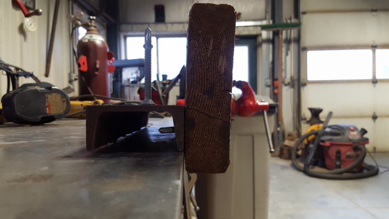

Hello again. I am just ready to start reworking my gooseneck trailer and for the 1,000th time I was rereading and studying this build (among others) and I saw something that I had not paid attention to before. It appear that the builder "doubled up" the 3" channel in 4 spots best I can tell. I am at a loss as to what their purpose is. Can anyone shed some light on the reason for them and their placement? For butting the boards?

I'll get a few pics for you tomorrow. The two places where the deck supports are fairly close are indeed where the boards meet. I did that so I had a channel to screw the ends of both boards to. Trying to but them up and screw both to one brace wasn't going to work well.

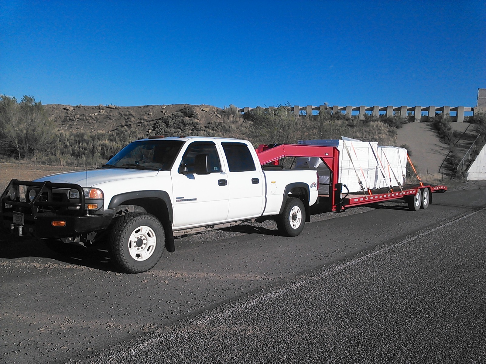

Here's one from my recent haul, right out of a Titan XD commercial... 51 sheets of 2" foam insulation and 10 8x20' sheets of 10ga remesh...
Putting a slab in my pole barn. :)
Travis, I have it tagged for 16k lbs GVWR. I rough calculated that the I-beam I used for the frame is good to more than triple this with a distributed load, so it should be fine. I used two 7k axles instead of the 8k axles under most goosenecks, but I figure I can count the tongue weight into the equation, so another 2k over the 14k the axles will handle... That is not the traditional method to set trailer GVWR, but I'm not the usual trailer manufacturer. :)
