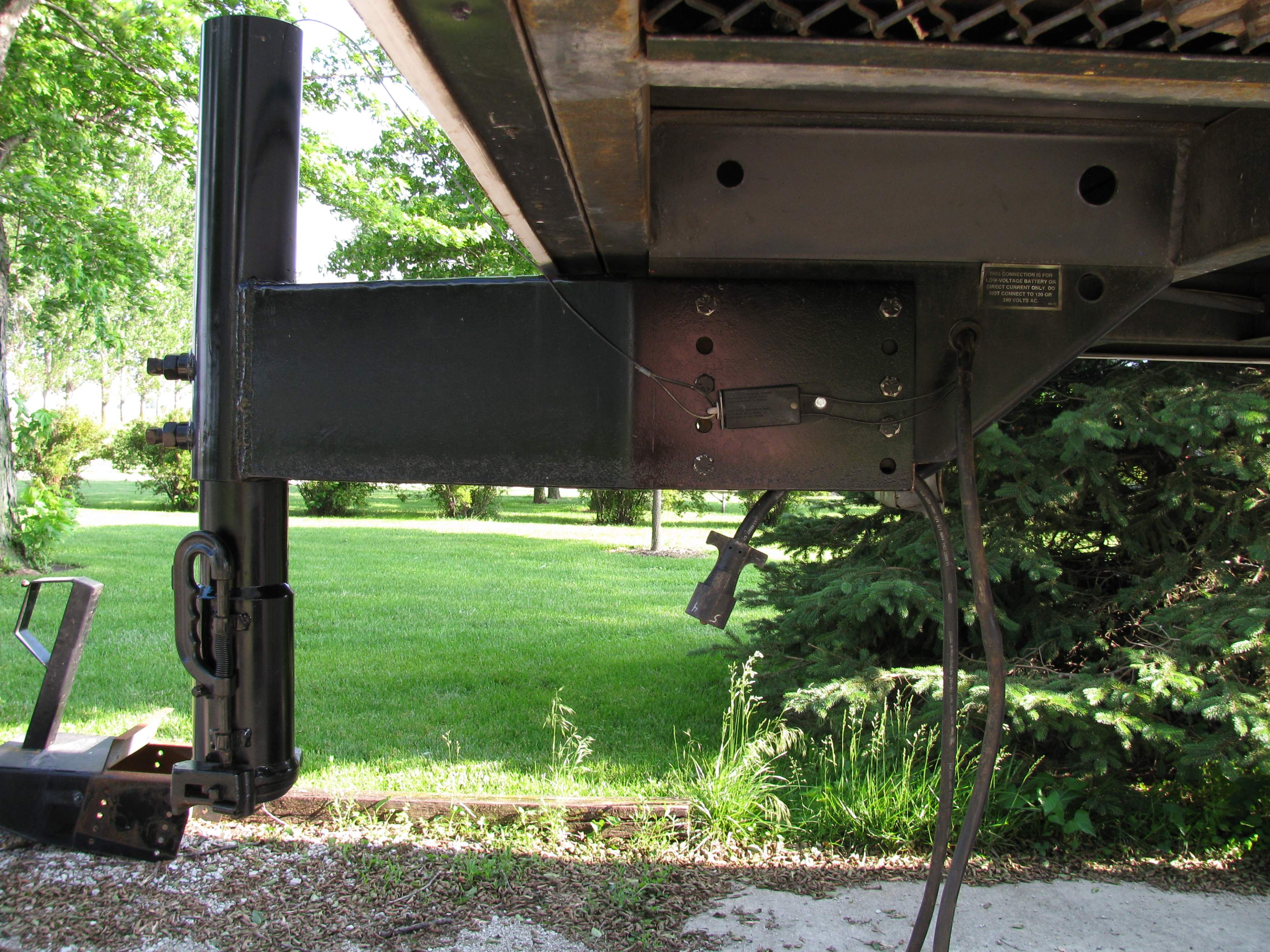

When I traded trucks I didn't want two hitches in the bed. I installed the B&W flip over ball then I changed the hitch on the camper to a Goose Neck. It is a little tougher to hook up but I can tell no difference on how it tows. I t would be nice if the camper had more weight on the nose but I have enough truck for either trailer.
Dan
