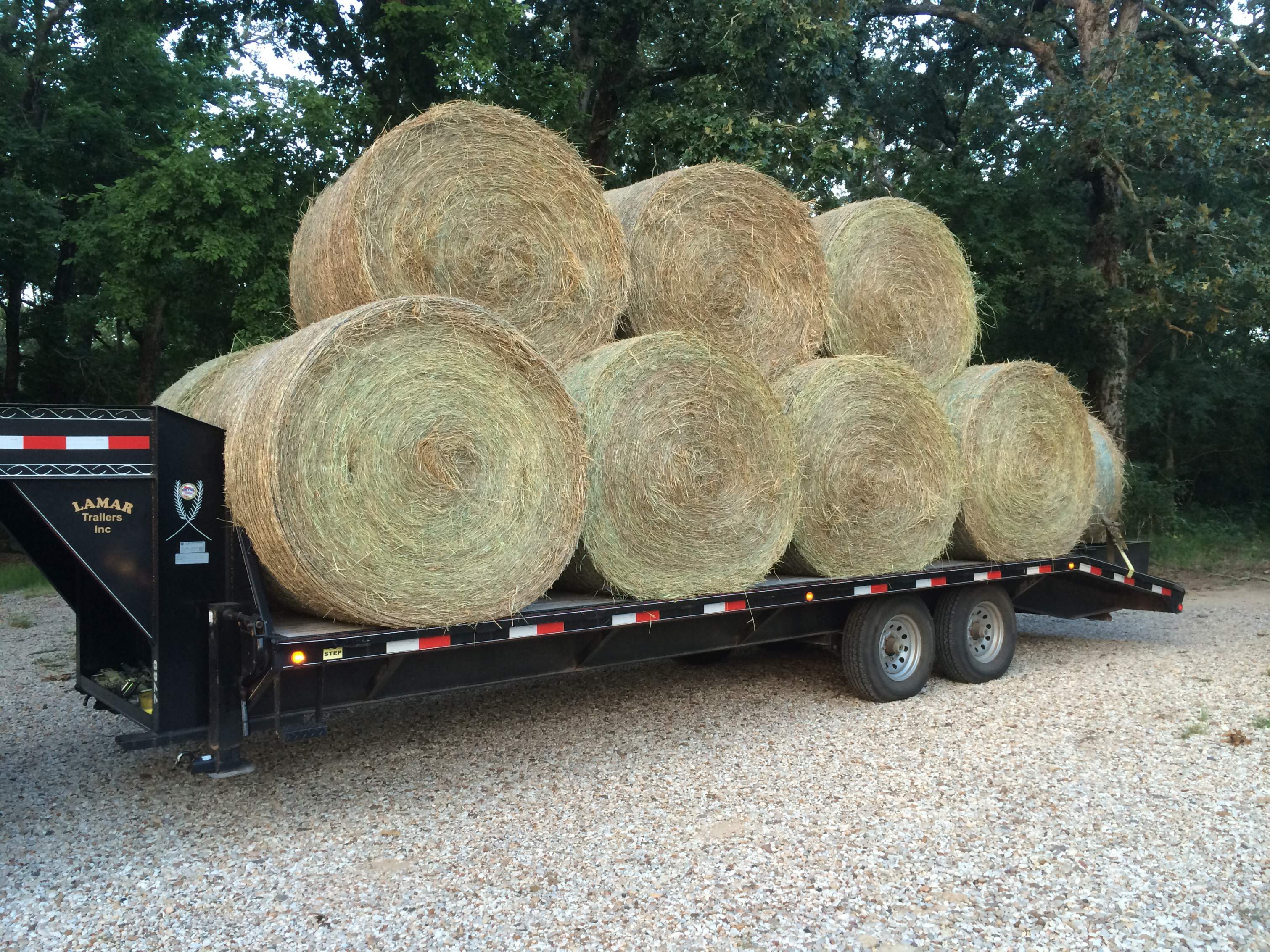

What size truck are you using to pull these? Now I am questioning my F250.
I pull my 28 GN with an 02 GMC dually with Duramax. Even with the trailblazer loaded it does a super job. I load it to 14,000 on the axles and I think the total weight for truck and trailer full was around 23,800, on my last load. I'm not sure what the truck is rated for but that had to be close to maxing it out, but maybe not. The truck is 7500 and the trailer is 6000 approx so that leaves 10,300 for weight on the trailer. That doesn't seem like much, but maybe my math is fuzzy.
