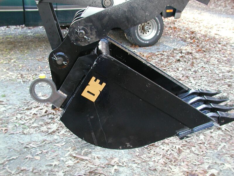

The thumb I got from D&E for the EF-5 is a little heavier than I'd have made myself, but it sure works nice. It weighs 175 pounds, and I'd prefer it weigh closer to 100, but at least I don't have to worry about breaking it. /w3tcompact/icons/smile.gif

I placed half a dozen landscape rocks ranging up to a ton in weight. One of them, a 400-500 pound one, I placed using the backhoe and thumb at full extension, because the place we wanted to put it wasn't accessible using the FEL.
