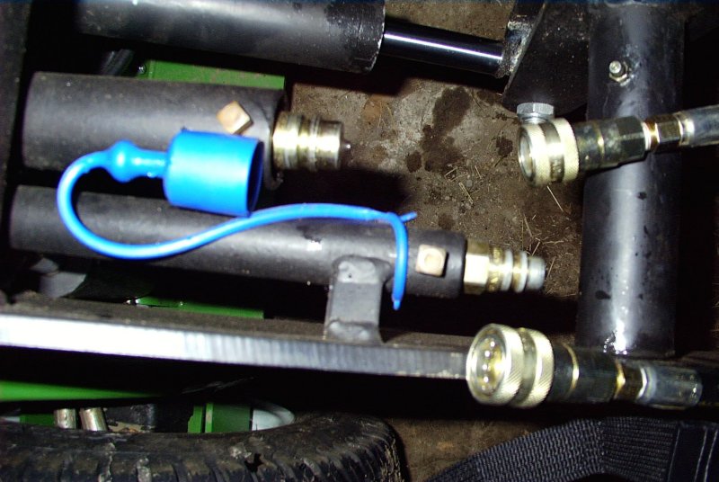

OK, I put the kids to bed, then fell asleep myself. Sorry for the delay, here you go. Attached is image 1. It shows the larger 1/2 inch male main PTO connection right next to the blue dust cover. The other male connection is the 1/4 inch aux PTO connection. I measured the diameter of the male 1/4 inch connector and it appears to be about 9/16ths across at the tip. The inside diameter of the female 1/4 inch connector appears to be about 11/16ths across which is the size of the ring on the male connector.
You can also see that the 1/4 inch connector has the same ring as the 1/2 inch connector.
