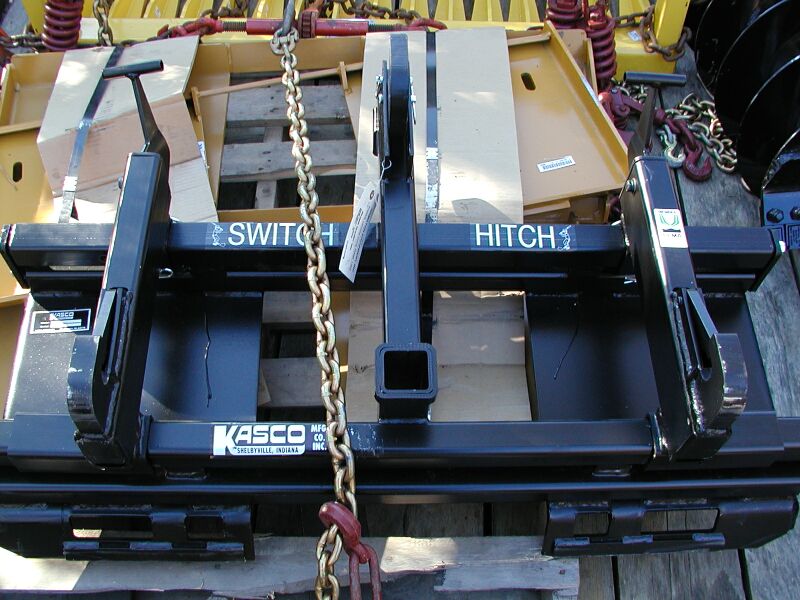

Re: More EF-5 info, pictures
MossRoad - And here's a lousy picture of the Switch Hitch. It's obviously laying on its back (with the plate the loader attaches to underneath). At the top, you can see the hook that slips under the top link attachment pin on a 3-point implement (but you're looking at it edge-on, unfortunately - I told you it was a lousy picture...). At bottom right and left are the hooks that slip under the side link pins. Above them at the top of the Switch Hitch are the handles that engage and retract the side link locking plates. In the bottom center of the picture, you see the 2" hitch receiver tube.
In the top background, the tan things are 3 quick-attach plates that will be welded onto the Brush Brute, my 6' Agric tiller, and my homemade Soil Pulverizer, which I'll be posting a picture of shortly.

The Brush Brute pic didn't post, but the rest did. Thanks. The switch hitch looks like something I've seen before, without the receiver tube(freedom hitch, maybe?). Again, thanks for the picks.
