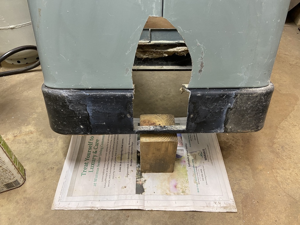

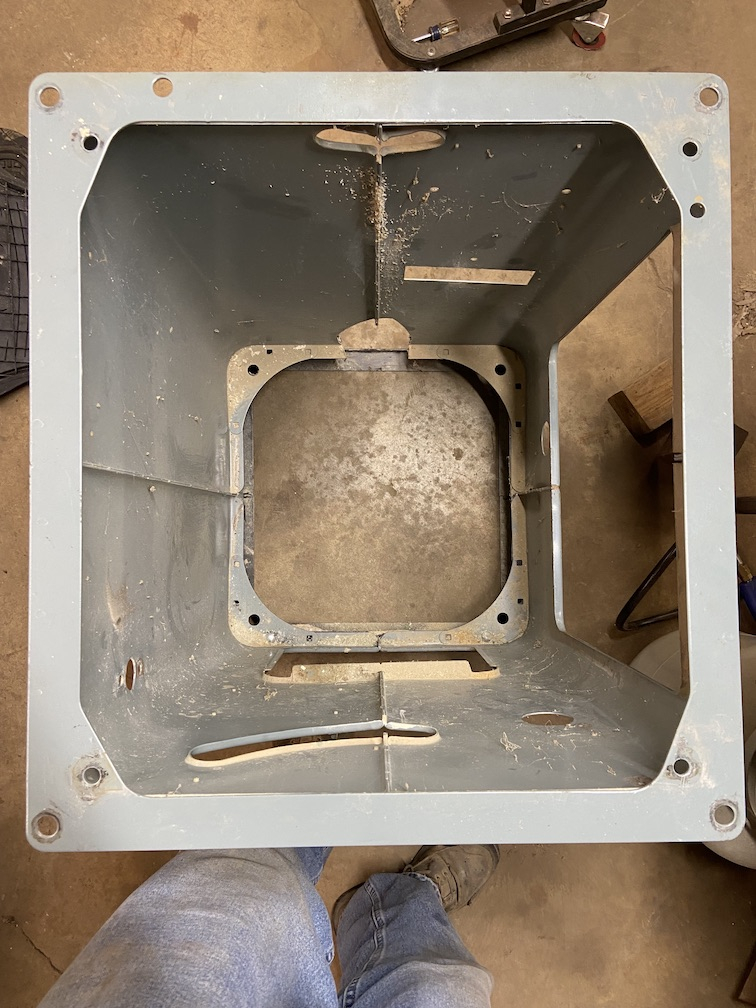

Still working on getting all the silicone rubber removed from the Unisaw cabinetry but making progress ... just a little left to go:
Taking a little closer look at the black base of the saw, it seems like there was square dust port from the factory as original equipment ... so not real clear to me why someone would feel it was necessary to hack the cabinetry.

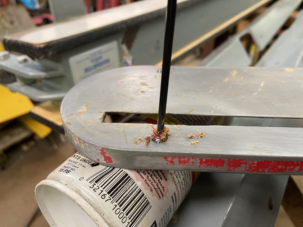

Went to clean up the throat plate and the contact cement reared its ugly head again ... all four of the set screws that allow for leveling the throat plate were full of it:
Screwed around quite a while trying to dig that out with a pick to get a hex bit in there to remove them. Finally hit it with carb cleaner and the acetone in that softened it right up. Chased the screws with a die after I got them out.

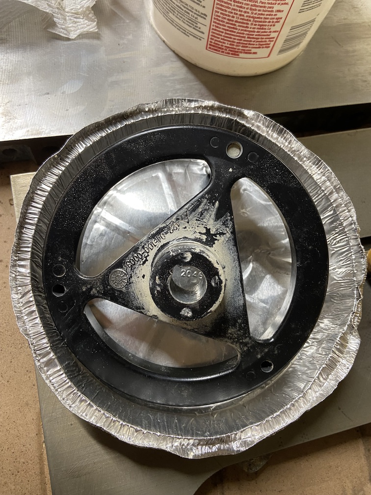

Did a little scrubbing on the hand wheels for the blade tilt and raise/lower, also cleaned out the bores with a fine stainless steel bore brush for a 12 gauge. A "before" pic:

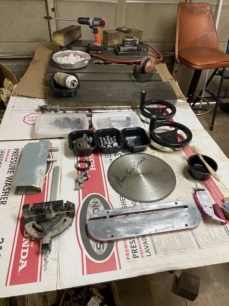

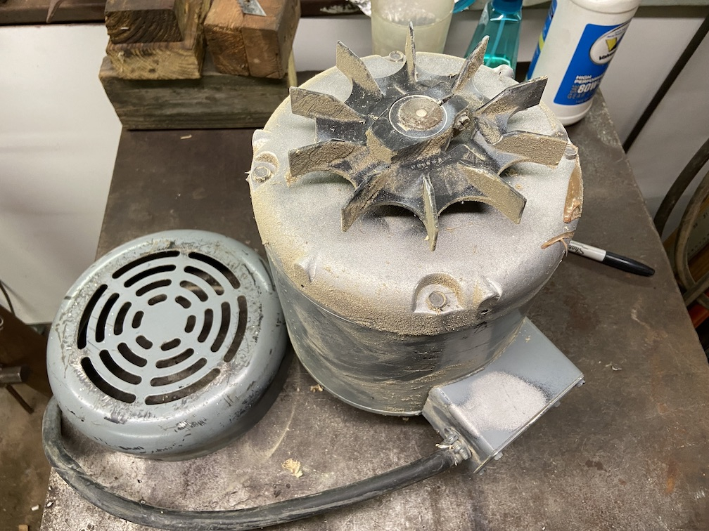

Got the little welding table cleared off and started tearing into the 3 phase motor. Will need to do some further reading on that before I go any deeper:

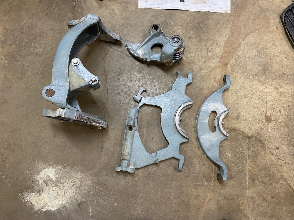

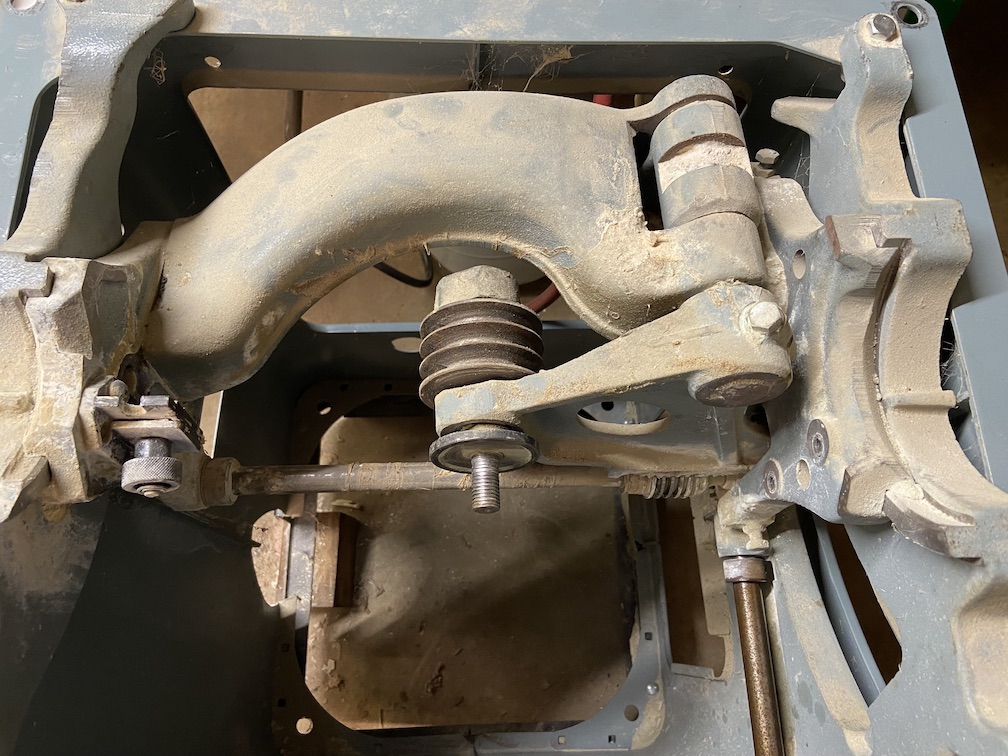

Finally bit the bullet and pulled the guts of the machine: front and rear trunnion brackets, trunnion itself, blade arbor and motor mount ... along with two worm gears and shafts:
A bit tricky for one person to do alone (wouldn't want to drop any of those castings on the concrete) but manageable with care.
These old machines aren't terribly complex and can be gone through and rehabbed without too much difficulty by someone who possesses reasonable mechanical skills. They are rather durable apparently.
