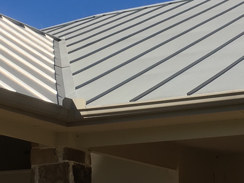

Insurance adjuster is going to help us replace the roof. Thank God. I want to upgrade to metal. Asking for advice from you wisemen. Galvalume has 20 year warranty but painted has 40 year. Shiny would look best but shine wears off after a few years. White would be best choice to lower attic temp, but forrest green would look better. I plan to blow in more insulation while some of the deck is off. Anyone have a dark colored metal roof in a hot climate? Would that be stupid? Would green last as long as white?

Here is our 7 year old galvalume roof. It weathered to look like it is painted gray. IMG_0279.JPG
The raised seams still shine because they only get about 30% of the suns rays.
This roof is called raised seam and it comes in a roll and the roofers put it trough a bending machine for the seams and cut it to the desired length.
A green would look good but what will it weather fade to? Can it be repainted?
Does the warranty cover color change. We had dark brown metal siding in Houston and it turned into a green/browninsish army color.

The darker colors will fade from sun and UV Kyle.

I have seen a flag blue roof turn to to baby blue and a red roof turn pink.:yuck:
I haven't seen what shade a dark green will weather to.

Thanks for all the roof info. Looks like white or galvalume. Green will turn chalky, I believe. They supposedly use Kynar based paint for most brands. I wonder if somebody has developed a repaint method?
RNG, my roofer recommends not to put the insulation panels directly under the metal. He says you should shoot for maximum air flow under the tin to reduce sweating and rusting.

It's the air flow that brings in the humidity and moisture that caused the sweating therefore you need airflow to dry it out. If you have a solid deck with ice and water shield under laying Grace Ice & Water Shield 36 in. x 75 ft. (225 sq. ft.) Roll Roofing Underlayment in Black-532 - The Home Depot that will stop the moisture and you can put insulation up under the roof decking for attic temperature and sound control.
The added benefit of this is when large hail hits the metal roof on a solid deck it will not ding.
