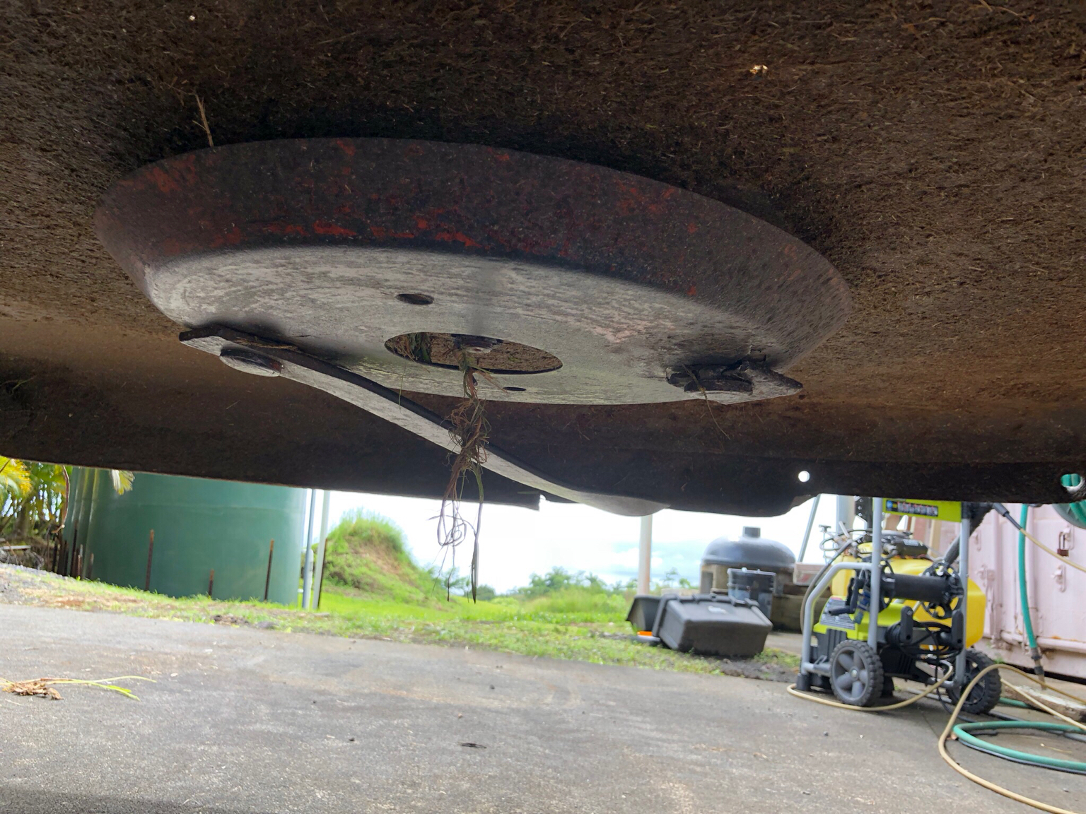

Got about 2 hours of good bushhogging done. Forced
to take a break
Anyone else ever break one of these blades? New shear bolt before I started and it didn’t break. Sadly, I don’t even know what I hit. Possibly metal fatigue at the mount point. An original blade, about 13 yo. I have a spare set, same age but never used.

Did you get the key into the slot, so that the bolt could go all the way up? I've never seen that either. WOW, where did the broken piece go?

David never broke a bush hog blade, would be interesting to see the broken edge. I would guess material fault allowed crack to start, then would not take near as much to finish it off.

I’ve never broke a blade , and I have run over concrete blocks, bricks, and a truck rim once. Made a lot of noise....

I didn’t take time to look for the rest of the blade just assume it’s where I stopped.
Break is pretty clean right at the bolt. I would blame abuse more than material fault.
As able to drop the pan assembly without too much effort, but I’ll be doggone if I’ve been able to free up the blade bolts. Of course my largest impact socket is 1 1/4, next regular socket is 1 1/2 and naturally the nut is 1 5/16. Just can’t seem to budge it with a box wrench even though the threads are clean, flooded with PB Blaster, liquid Wrench, heated... guess I’m just going to have to cut off. New bolts and nuts would be in order and I hope I can find some in town tomorrow else I’ll have to order. Likely will pick up appropriate impact socket too. Last time I had to special order Rhino wheel fork, hopefully the Kubota dealer or someone will have a suitable 7/8” alternative, seems a number of manufacturers use a keyed bolt.

David, never broke a blade but bent one once. Cut a 3 foot groove in the deck in just a couple seconds. I think I have heard of broken blades going through the rear tractor tire.

Glad you weren't hurt when that blade let loose, David. Kyle taught me that you'll need a large diameter, short, air hose and couplings to deliver the full potential of an impact wrench. I think I ended up with a 1/2" ID hose and couplings 25' long, and it made all the difference.

David, nastly break on rotary cutter. Hope you find a way to get bolt loose. I have a couple of 33 mm sockets. They fit my JD rotary cutter.
