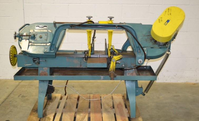

Spent half of Tuesday and most of Wednesday repairing an old Wellsaw Model 1000 at work. It is a horizontal saw with an 11' 6" blade. This is a pic from the net, not ours but pretty much the same. I had to machine on the back vise jaw to allow for one of the bolts that hold it in place to be positioned as a stop very close to 90degrees for a good perpendicular cut. Plus we took apart all the blade's alignment bearings, cleaned and re-installed. It is a bit of a learning process, to get the blade aligned on these with the way their adjustment system is setup. But they are very good, basic, common sense saws. It is sawing straight and true now.

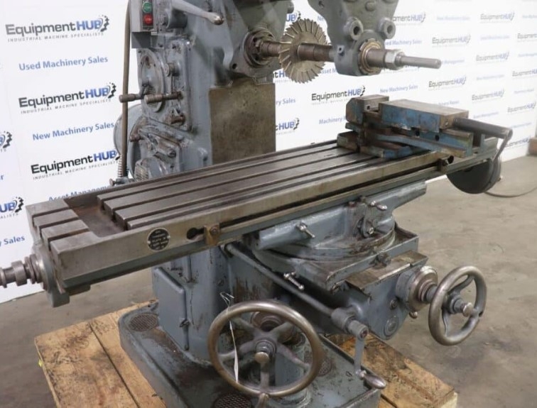

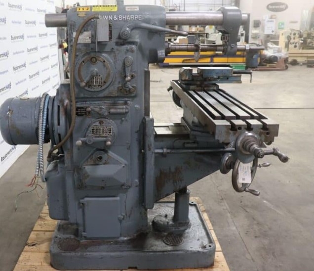

Then yesterday I researched our Brown & Sharpe No. 1 Universal lite milling machine. There don't seem to be many #1's out there. #2 is common. It is a horizontal, and a vertical head might be able to be attached, but we don't have that option.
Even though I'm an old fart machinist, I know almost nothing of these things.
Can anyone guide me to why the X axis feed is slipping? Like a clutch needs tightening? But where?
These pics are not of our machine, but ours is very close to this one.
These things are very capable, if you have the options and the knowledge (which I am lacking). I've been almost 100% CNC since after my job shop work. Spoiled I am. This thing can even rotate the whole table about the Z axis. I think we may have the indexer for it but not sure. I don't even know where the best place to buy HSS cutters is anymore.
Anyway, we make Charpy impact test coupons on it with a V cutter to put the knotch in the coupon. It has had probably ZERO maintenance. I go over it like an old locomotive engineer with an oiler and just hit it all around. Wish I had a manual.
View attachment 1112631View attachment 1112661
