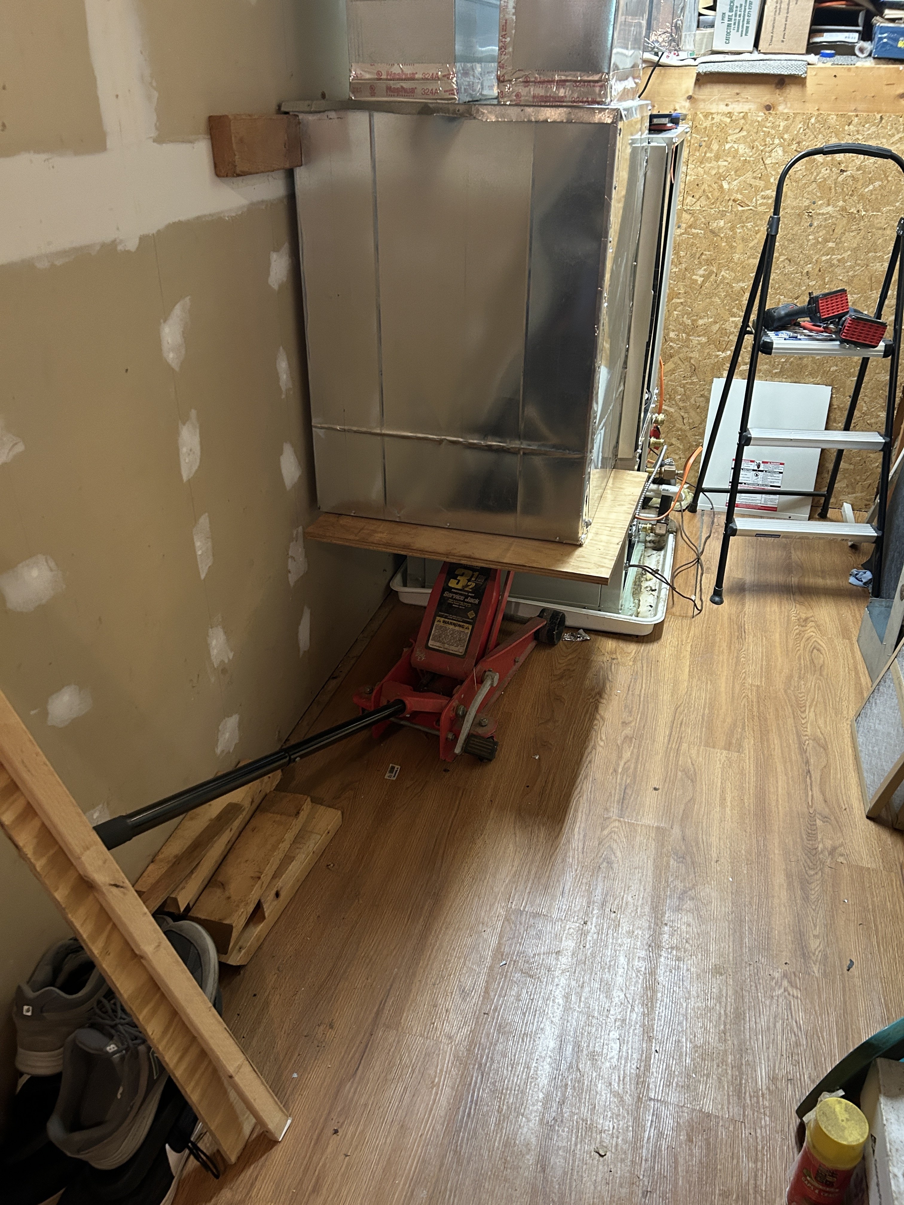

Return plenum went on easier than I figured, with the help of an improvised 3.5 ton lift table.
It’s all screwed in place and seams taped, now need to insulate the outgoing duct that I replaced yesterday, and wire up the aux heat coil, and it’s back the way it was.
