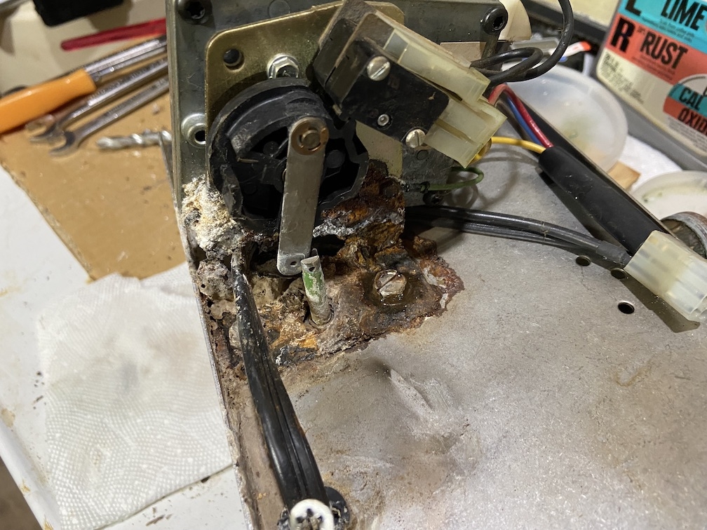

UPS delivered Cycle Stop Valve and Cycle Sensor earlier today.
Used some vinegar to soak the rusted bolts on the front panel of the softener then was able to loosen them with the B&D 20v impact and get them out and the front panel removed from the valve:
Looks pretty bad but it's still functional. Will clean it up as best I can before putting it back together.
Once I had that removed from the valve I was able to pull the piston assembly from valve:
The threads of the flow meter and output connection fitting are currently soaking, will try to separate them here in a few.
After that fashion a tool to pull the seals and spacers.

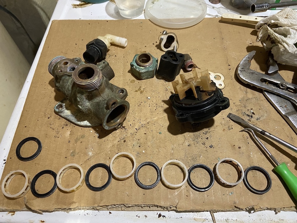

Flowmeter removed and disassembled, brass body in the vinegar bath soaking.
Got the rest of the valve body all disassembled and seals and spacers pulled too:
It's brass parts are soaking in the vinegar bath as well ... (y)
Still have to pull the orifices out of the brine injector body but I needed a bigger screwdriver than what I had down there with me.
Good progress for the day.
