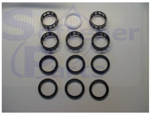

On mine, the valve is just a bunch of in and out ports, and a motor turns a plate that opens and closes different ports to make up the different cycles.
Right.
There is a gasket in there that seals them all from each other, it wears out and then ports leak across each other.
Ours has multiple seals and spacers in the valve body to isolate the various ports:

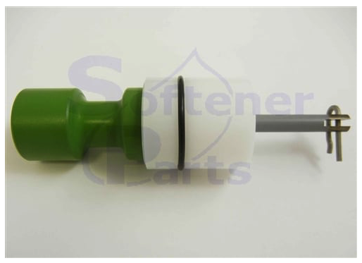

And an epoxy-coated brass piston on a rod that the motor actuates to switch from one port to another:
Think that o-ring (above) is what seals the valve to prevent water leakage.

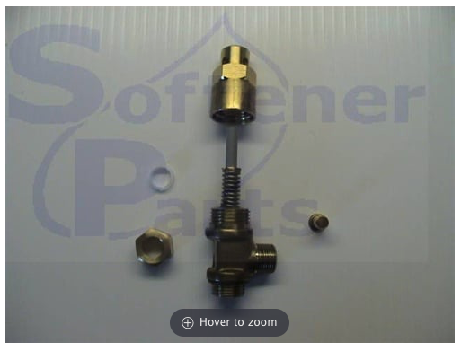

Brine valve assembly:
Usually just a new seal is all that's needed.

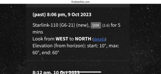

OK, all you airplane experts (those with the transponder/radar tracking apps). I just took the dog for a walk and saw something which makes me nervous.
Directly above me (Greene, IA 50636), at 8:10 central time: a line of lights (I'm assuming military planes), heading due east, spaced evenly about 2? miles apart, way up in the sky (30k + feet - hard to tell at night). No sound (but they're combines in the area, which would drown it out anyway). The lights disappeared directly overhead, and there were no red/green wing lights, or any under body flashings. I watched about 30 or more bright lights - slowly (speed is hard for me to guess) move west to east and vanish once they were overhead.
What the heck did I just see?
   / Good morning!!!! #178,536
Maybe starlink satellites, there was a launch today.
I'm hoping this is what I witnessed. Scary thoughts - like here comes a war...
