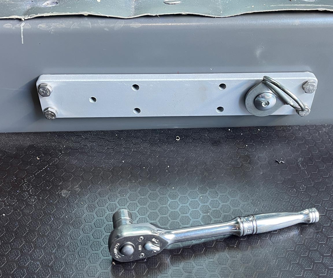

I need something for underneath the motorhome. In the event of a tornado alert while in a campground.
I've ordered some heavy duty straps and earth augers
Now I need the mounts on the vehicle
being a gas vehicle I'd prefer avoiding welding under there so
drilling the frame for a bolt is preferred.
I wonder if a magnetic drill would make this easy.
They are often too big to fit
I use a cordless impact drill to drive in the earth augers.
before I drill anything need to look under there and see if there are
any existing openings that could be used.
This is mostly to keep it from moving or tipping over.
with one on each corner, can't tip over, right?
earth augers aren't that big, so no sense sizing up everything else.
with experience in boat anchoring
I'm thinking the angle of the pull will also make a difference.
Also thinking of drilling augers into ground about one foot outside edge of rv body.
So guessing 45 degree strap angle to ground.
In boating you want it much further out than that but straps are only so large and the longer they are
pretty sure the more they stretch.
so you ME's, if you want to use four 2000# straps to hold down a motorhome, where would you put them.
lot of experience tying down a big boat for a hurricane, none with an rv.
I need to go see how far the frame reinforcement for the rear hitch goes.
looking for something as strong as possible as close to the edge of the rv as possible.

Are you worried about tornados just when you're out on the road, Drew, or at home, too?
If just out on the road, you could just get in the motor home and drive away from the storm, couldn't you?
FWIW, I made up some stakes from 3/4" diameter hot rolled steel and drove them into the ground at a 45° angle using a Harbor Freight jack hammer. Four stakes, two feet long, two pairs. One pair at the front and rear of the office trailer here. Then I ran 1/2" steel cable up over the frame rails of the trailer between each pair of stakes. There's a turnbuckle in the middle of each cable so I can put tension on the anchors. The trailer wasn't moved at all during last December's wind storm that took off the porch cover, which was only a few feet from it.
   / Good morning!!!! #176,166
Here are some photos of the tie down anchor in the van:
Looking at the photos, I might have to be satisfied by drilling two more holes in the center where there are no obstructions behind the step...

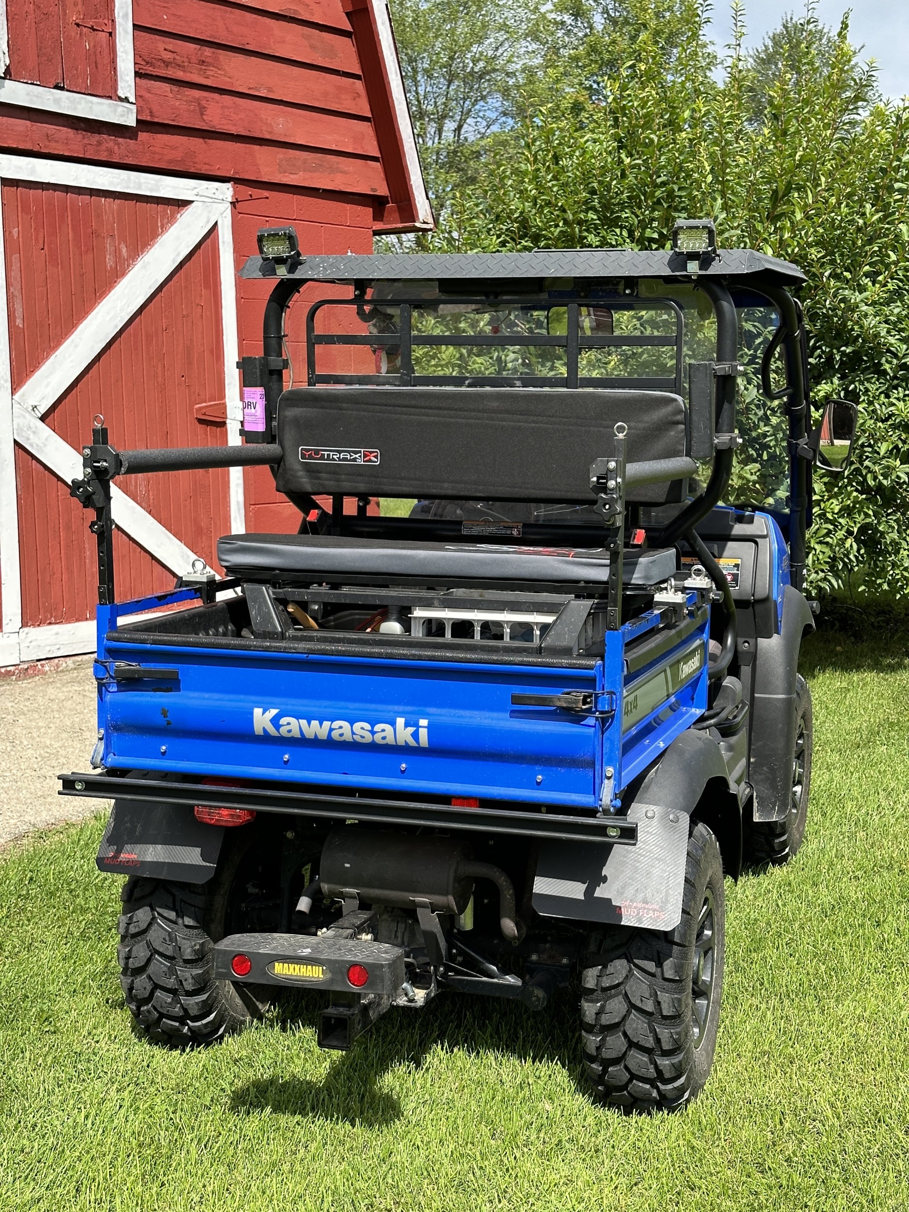

Got armrest installed. No pool noodles available this time of year in my area. So I used 1” pipe insulation. Making armrest extend to back post gives someone getting into back something to grab onto. Seat bottom lifts up for storage. Milk crates fit under with 1 1/2” spacer I put under legs. I will not be leaving seat cushions in most of the time. Easy to put them in and out when needed. Whole seat can be removed by removing four 1/4” hitch pins.
   / Good morning!!!! #176,169
