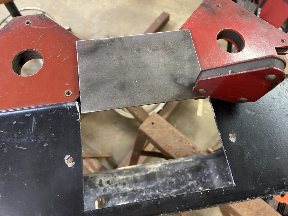

After that spent the rest of the day up in the shop working on the sheet metal repair to the saw base.
Overall, it went ok ... the end result isn't perfect ... but it turned out reasonably decent.
Probably should have started by welding at the opposite end, which would have given more purchase for the new section when it came time to heat and bend it:

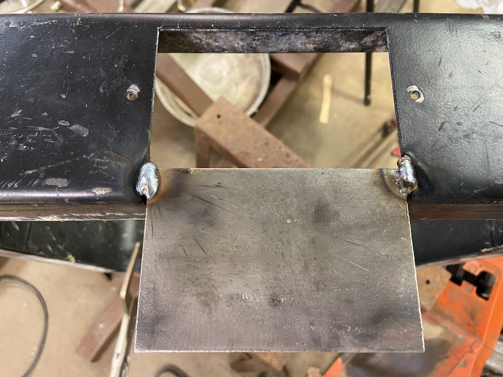

Tacked:

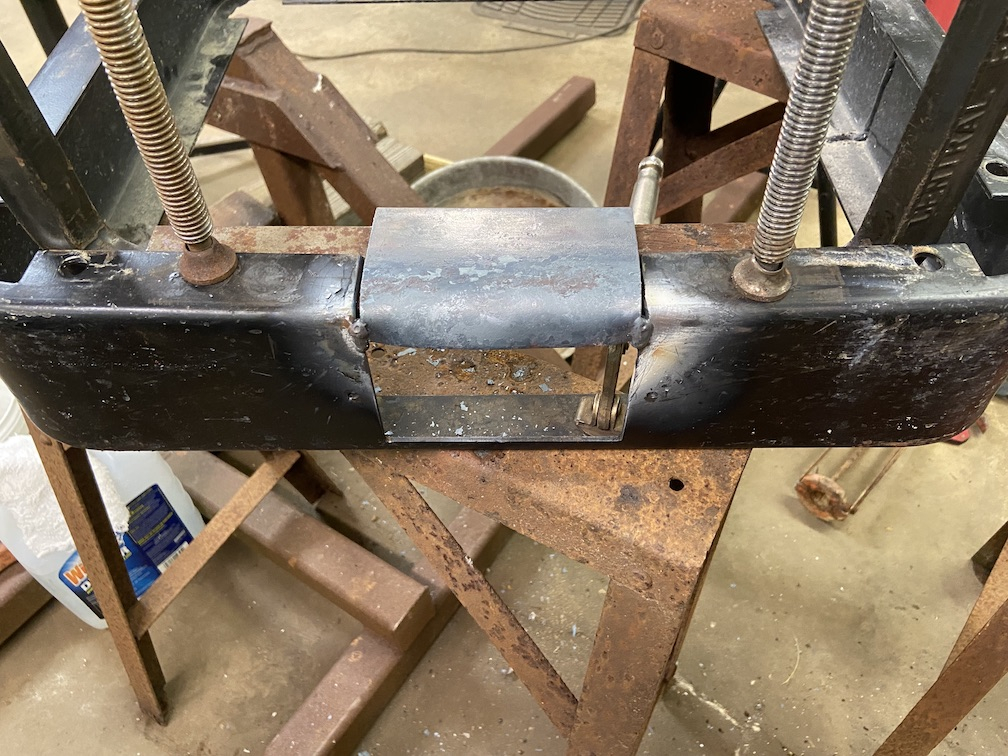

Even so, the welds held when I started to heat and bend it:

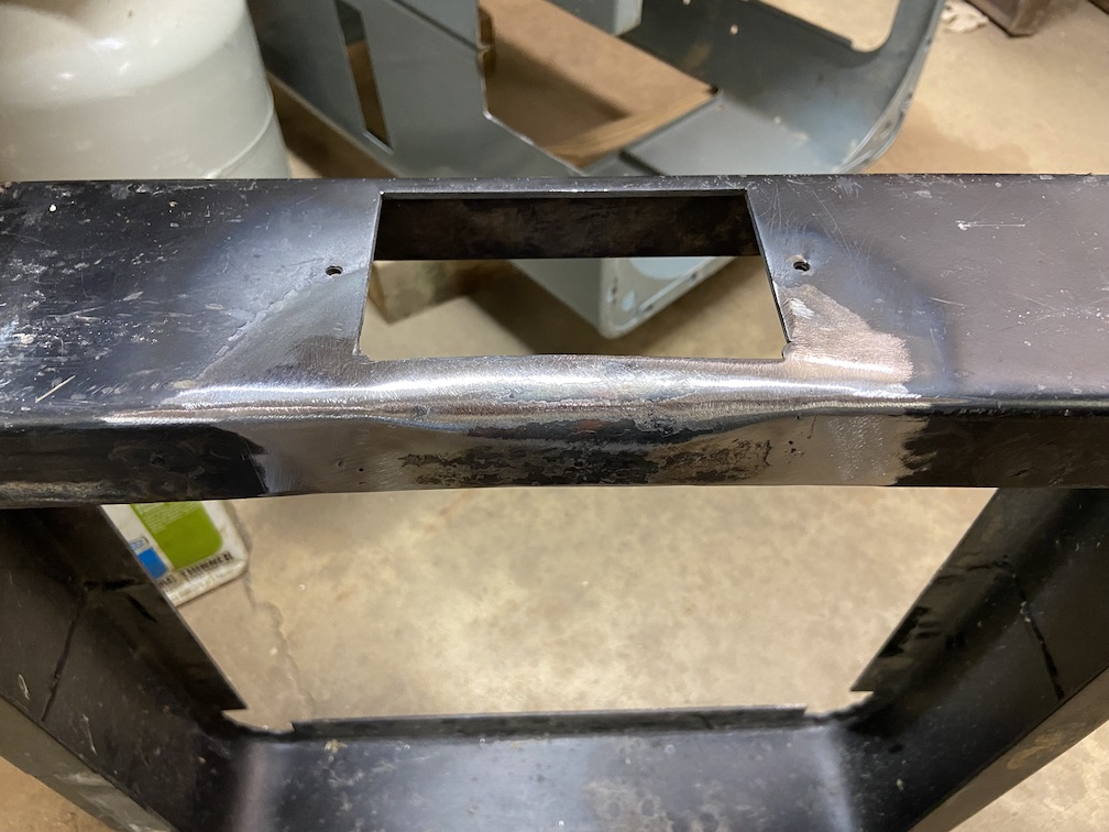

Center in the opening deformed slightly when I bent it, eventually cleaned that up with a zip disc on the angle grinder:
