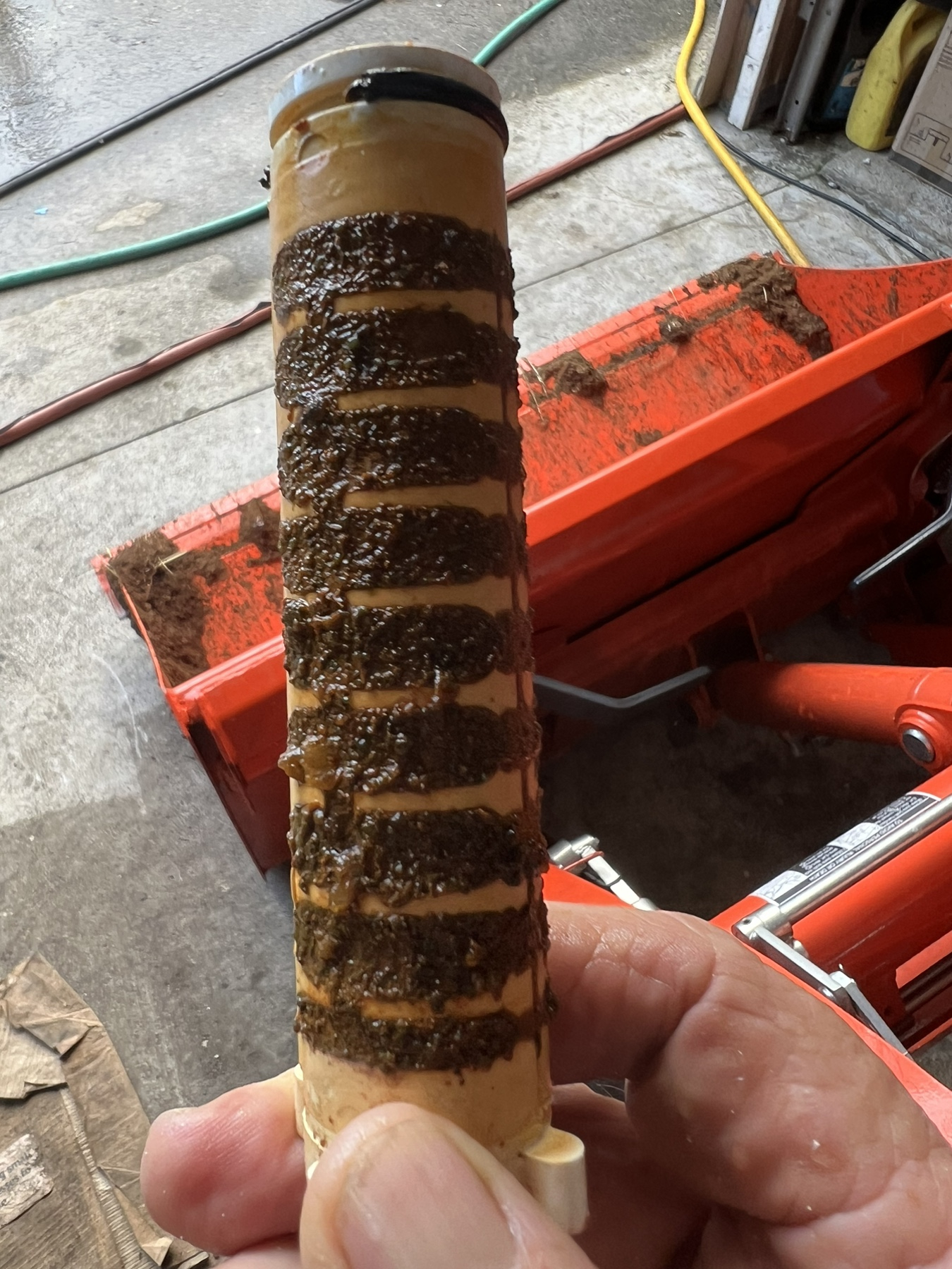

Got water/pressure back. May be victim of 2 unrelated actions.
When I replaced my sediment filters in July I replaced 1st in line with a 5 micron instead of 10 or 20. In Aug I rehabbed my pressure tank in Aug I suspect I liked loosed up 15 years of sediment
This is my spin down filter
This the 5 micron filter
Cleaned the spin down, replaced the 5 micron and carbon block filters.
Enjoyed a very nice hot shower.
Reordered a supply of filters and giving serious consideration for replacing the pump which is 10 years old. Thinking it might be wise to replace and keep the still functioning old one for emergency. Wife agrees.

David, your water filters look like mine after 3 months.

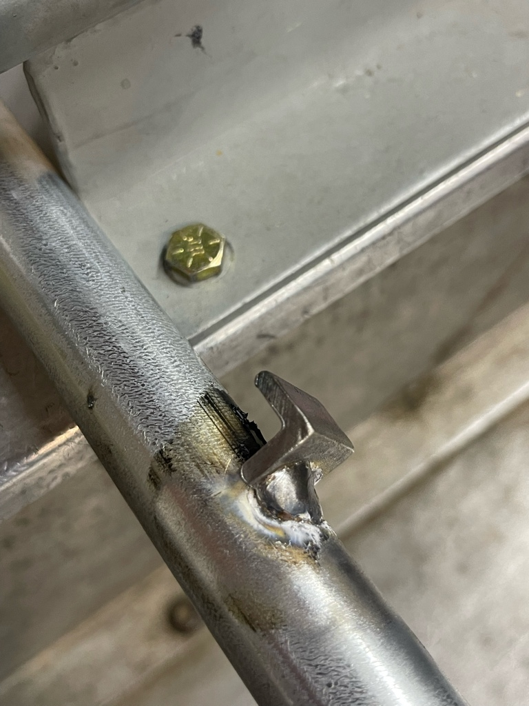

Then got back to the lighting project for her display racks. I got it all done, the uprights worked out well, the brackets that hold the light just slip over the top of the EMT. They were made out of aluminum because that was the material that I had laying around
