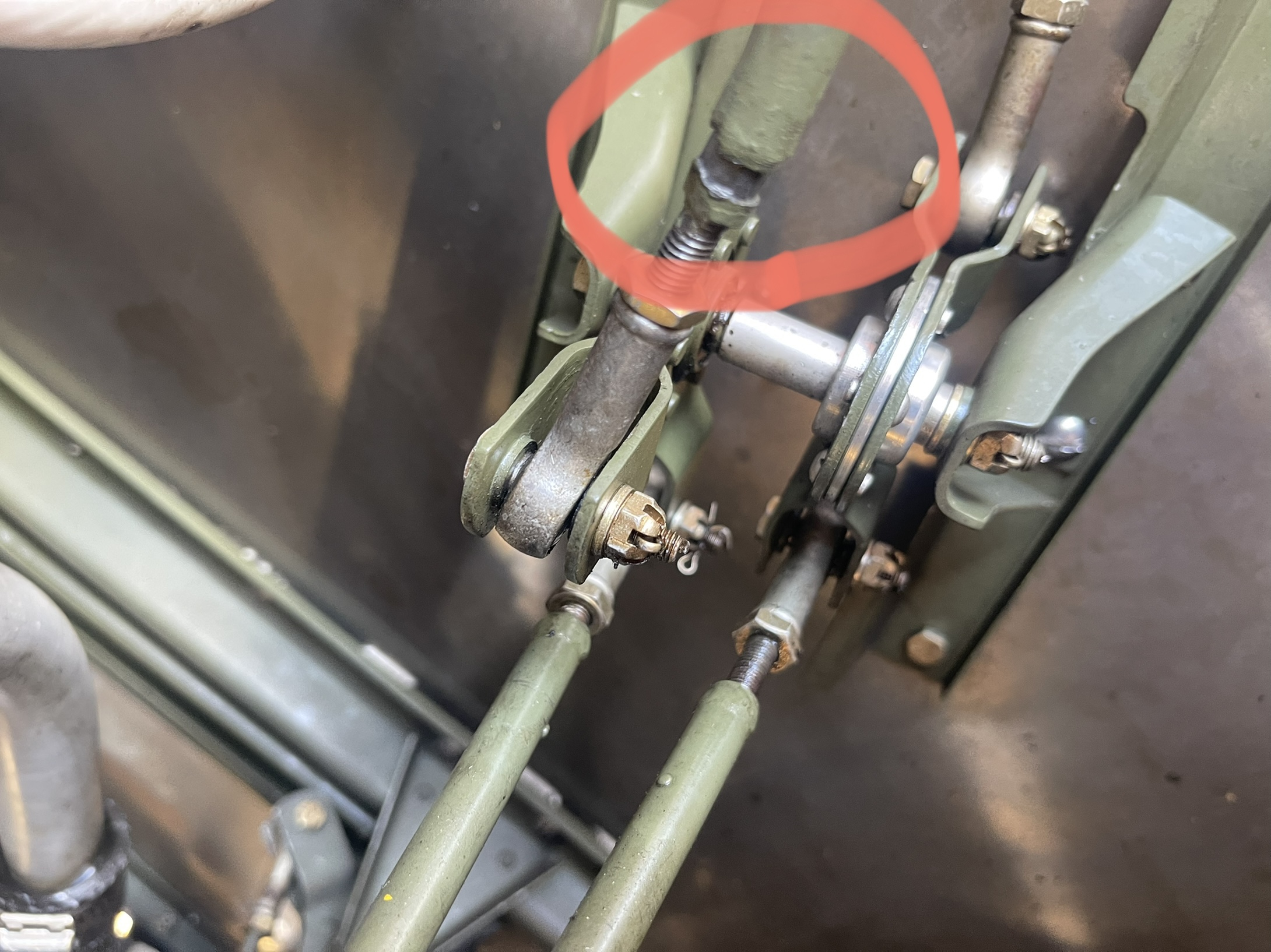

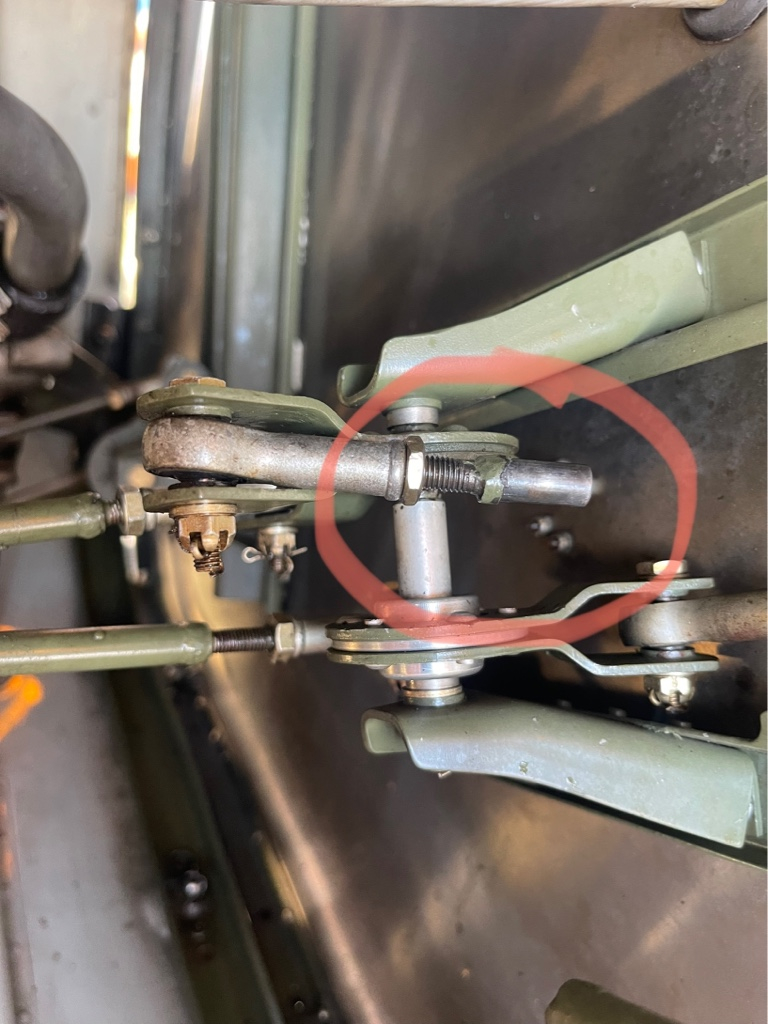

There was a Stearman that came in that had now throttle control, a quick look determined the cause, a weld failed and the end pulled out of a pushrod. The first picture is how I found it, the second was just put back together but slightly pulled out.
It was a quick repair to put it back together and weld it and send him on his way after talking about how lucky he was that it pulled apart while he was taxiing
