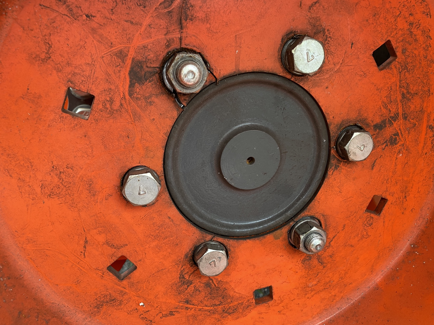

Meant to post this one, every lug nut hole has a crack, but one is cracked bad.
Now .2” rain
Little over several years ago friend Kubota M4800 did the same thing both front rims,he had cracks welded but only lasted couple years,he than had 1/4" plates made and bolt holes and hub mill than weld to rim and stronger bolts yet to have problem.

that wheel looks bad, I wouldn't stress it too much until you get it fixed.
Metal used in steel wheels should be tougher than that.
Sure shows why you need to examine your lug nuts carefully.

Dennis while some bolt and some nuts, the one does look bad.
RS sorry mowing interrupted, hope you get some serious rain.
Thomas took 1/4 inch plates to fix, wow.
Now .2” rain
I wouldn’t delay repairing that. You could cut out a disc of 1/4” plate, and layout and drill the bolt circle, and ideally a fairly precise bore for the hub. Then weld it in place.
