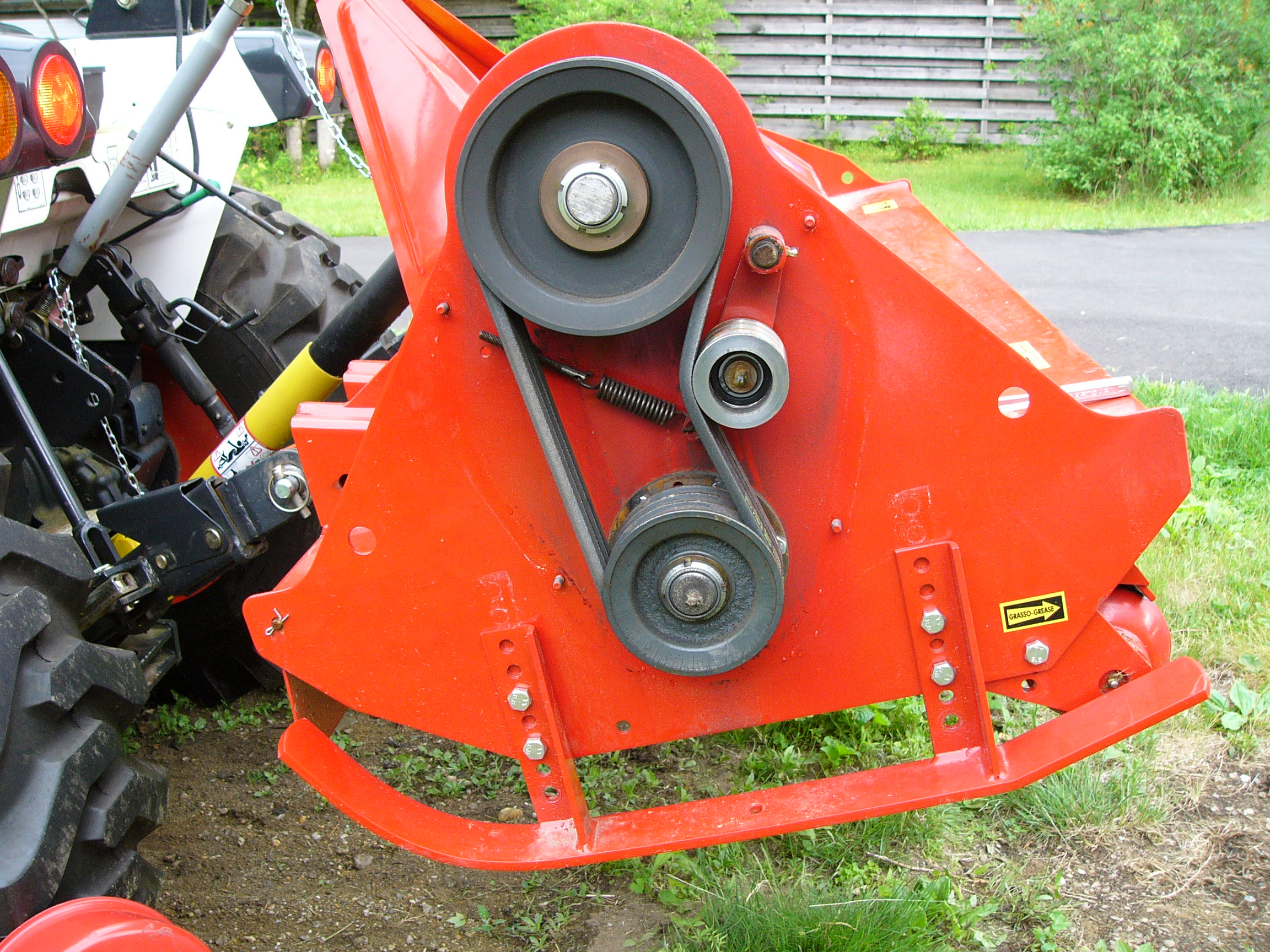

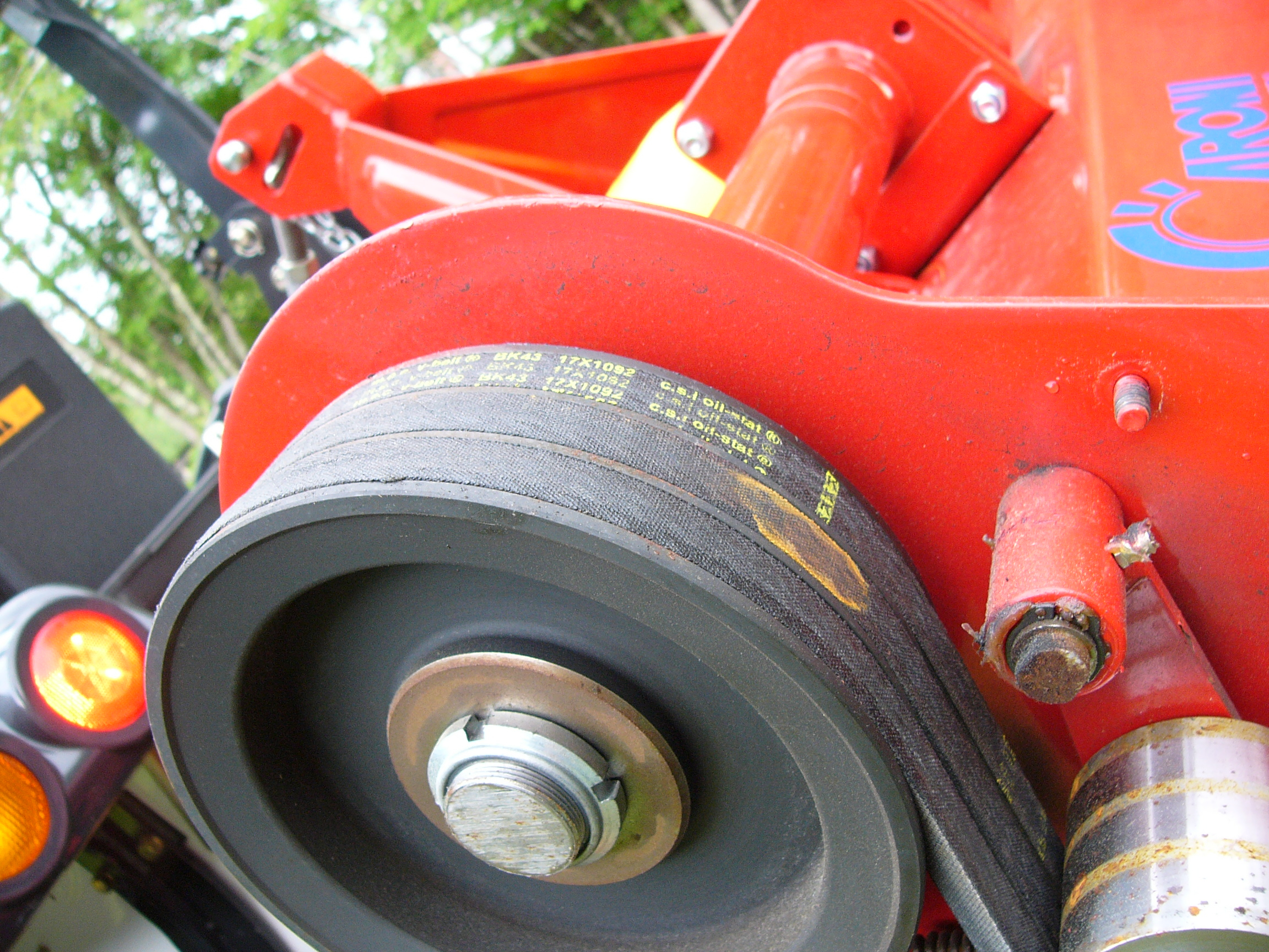

Finally got that belt housing off the flail mower using the impact wrench and a 13mm socket. Was pretty easy once I got a good bearing on the nut flats. I'll probably replace the nuts. The stud threads had paint on them...I'll use anti-seize or something like that
Anyway, both belts were trashed big time. My guess is one let go and jammed the other since the rotor and dive pulley both rotate easily.
No markings on the belts such as PN's, but a bit of research indicates they're BP43 belts. I've ordered 2 at a local auto parts store and they should be in first thing tomorrow
However, any of you guys that have a Caroni TM 1900 flail mower and have replaced the belts, let me know what belt you used.

Roy; My TM1900 uses BK43 belts (3 of them).
