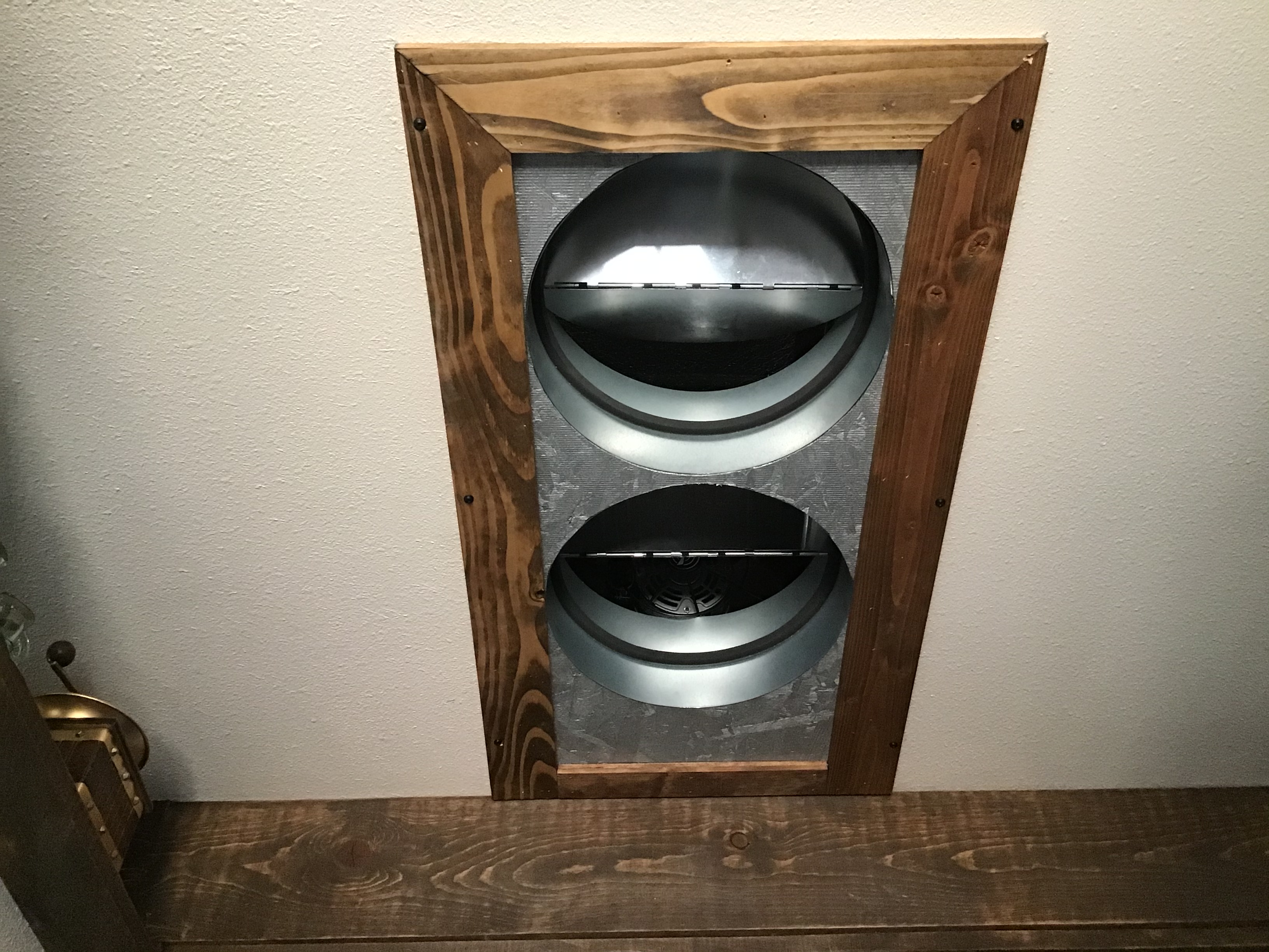

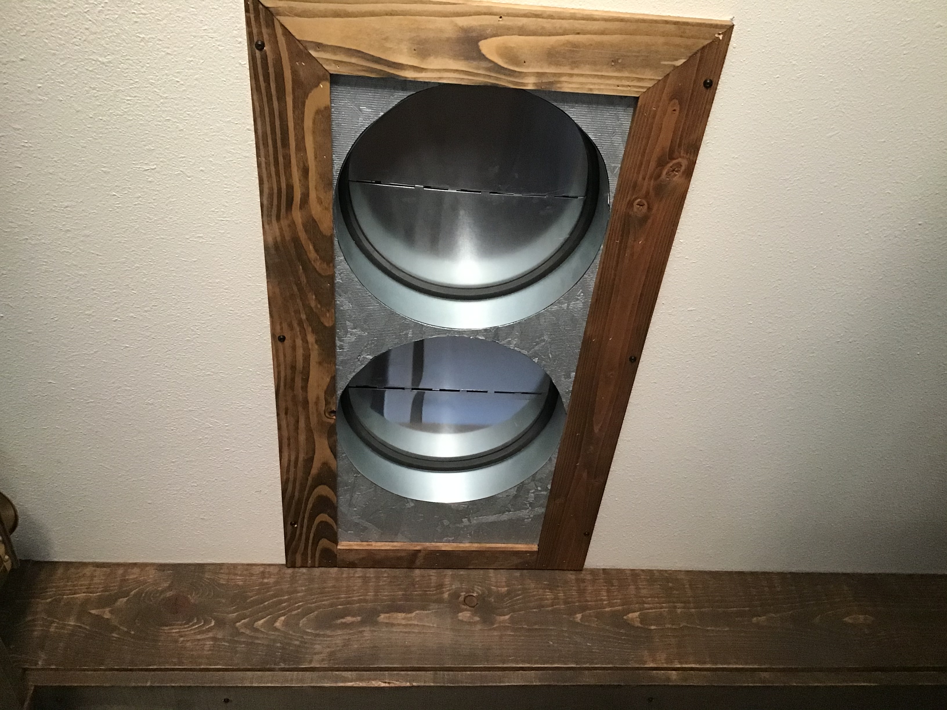

The dampers are 12.4" round self closing baffles. There is a rubber gasket that they close against. I am using 2 of them. They are mounted in a piece of OSB that will fit on the bottom of the plenum. On the ceiling side, I was originally going to make a wood shutter, but that would be very labor intensive. The new plan is to trim the opening with 1x4 stained pine, then use a standard 16x30" steel return air grille from HD. I am going to paint it black to match the black hardware used on the pine beams throughout the house. It will screw into the ceiling joists, for easy removal if need be.
Here is a pic of the dampers I used: https://www.ecomfort.com/products-image/600/19774-165156-thickbox.jpg
I will post a pic of the dampers installed later this afternoon.
And yes, the attic fan is the same as what they use on the whole house fan setup, less the ductwork and ceiling damper. I searched and searched for just the damper .... they don't list it as a separate part, and there are no other similar.... so made my own!

Well, almost afternoon, but I got the dampers installed! WOW, what a difference in noise level. On low, we cannot hear the fan at all unless standing underneath it. On high, it now has the noise of being on low without the dampers. We can easily hear the TV or radio without turning them up (that's a good thing because I can barely hear them anyway). Now I just need to get the grill, paint it, and install.
At first try, I thought "oh no!", the dampers would barely open..... then it hit me.... the house is closed up tight with the A/C on.... opened the back door and WALAAA! They opened up as planned. WHEW!
