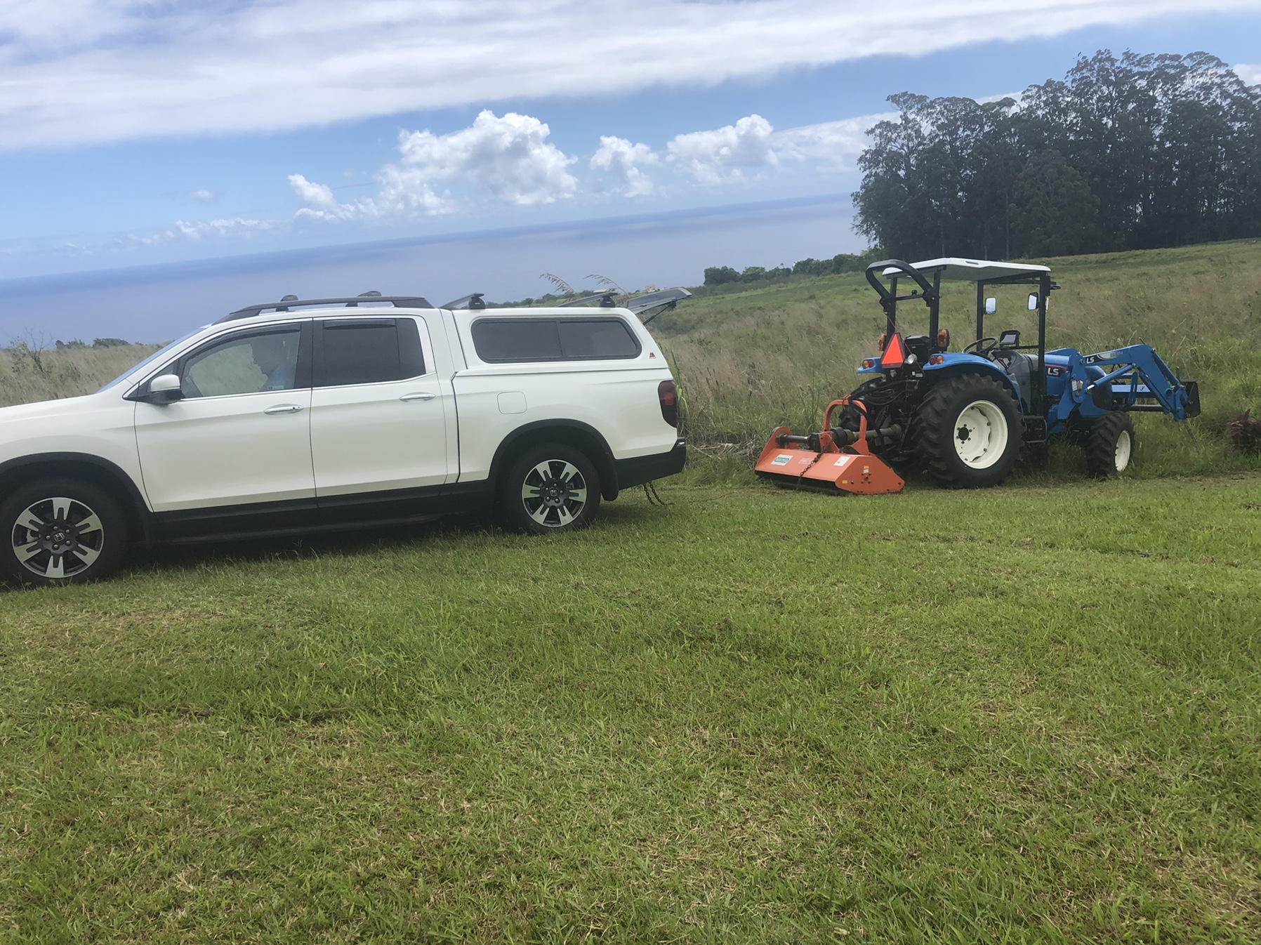

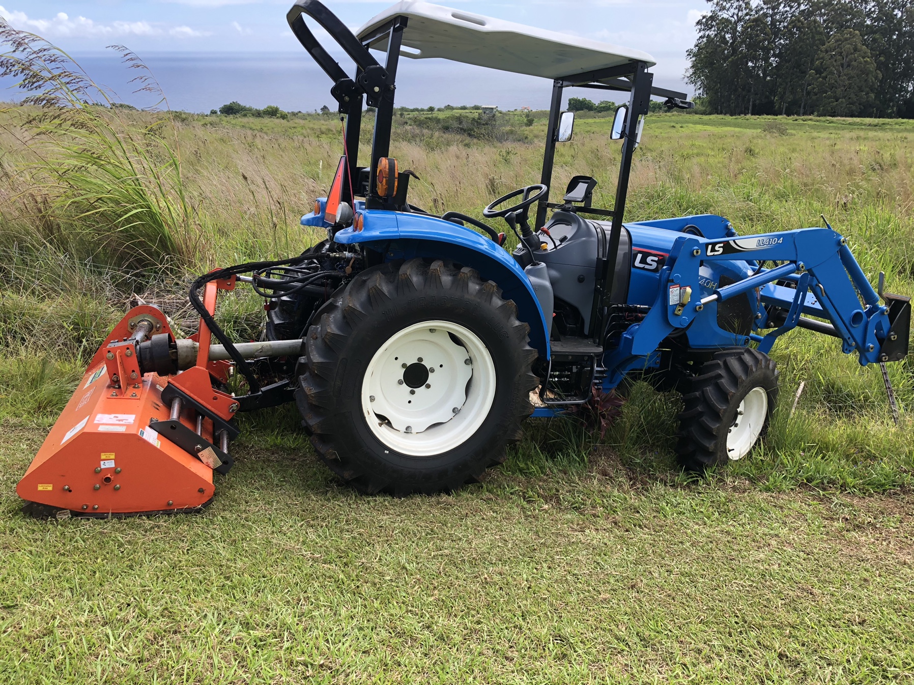

Only got about 4 rounds on the flail.
As I was coming into a turn point I noticed and commented to self about the wet grass, not recalling that it had been that wet. Looked back as I completed turn only to find flail covered in oil. Looked under tractor and hydro fluid is spewing like a garden sprayer. Naturally, I’m at far point from tractorshed but decide to head there. Got maybe 50 ft and lost steering etal, tractor coasting downslope into the fence. Trudged up to the house, got wife, chain, and Ridgeline. At least needed to get tractor where I could get under it.
Chained Ridgeline to flail and attempted to pull. Only minor gains before I’d lose traction. Headed upslope of course. Got it clear of fence when John came down and offered his assistance. Trick was to gain a little, hold that gain by braking tractor while repositioning Ridgeline.
View attachment 658777View attachment 658778
Once in a clear area, able to disconnect the flail and reposition to front with hopes of getting it turned toward the house. Success, me in Ridgeline, John on tractor for the brakes, got it up to the driveway.

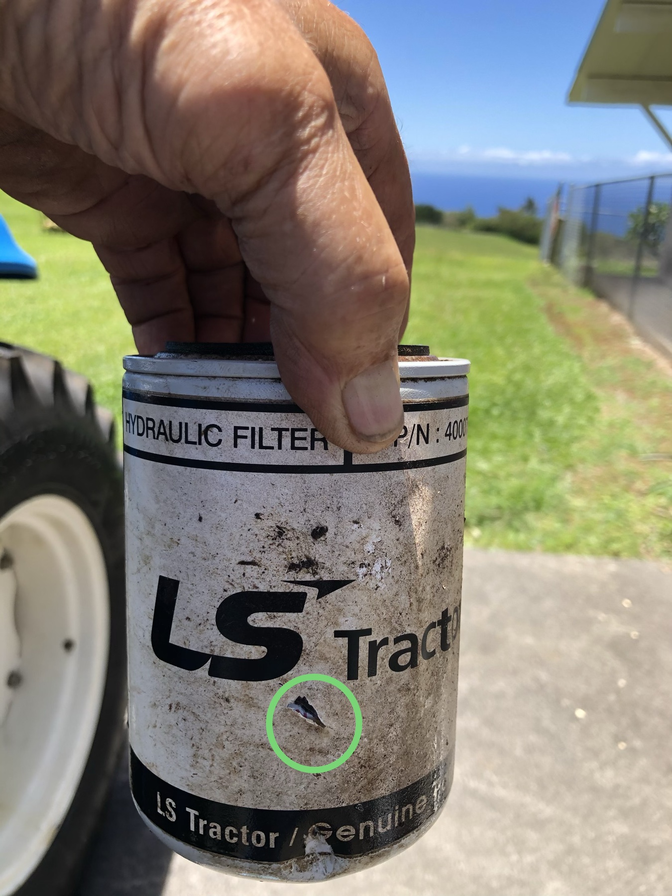

Crawled under and found the problem - the hydro filer. Not unusual that I hit the loose gravel, but I do remember hearing an unusual clink. Must have been a rock hitting the filter.
Only 1115, time to get to my dealer before he closes at 1200.
Half way there by time I learn none in stock. Couldn’t cross reference at NAPA either.
Came home, ordered online, done for day.

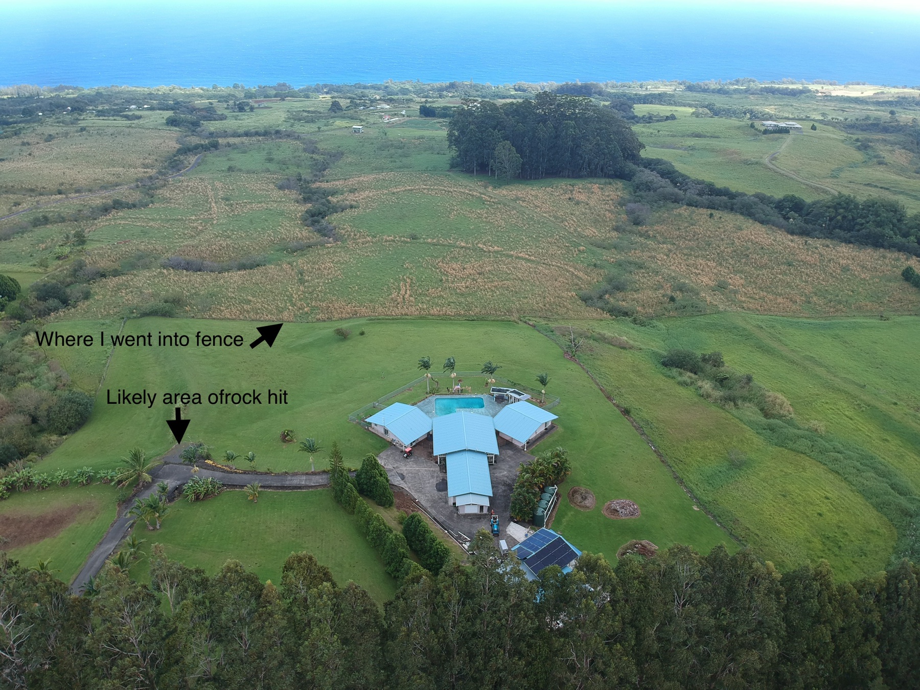

Wow! Is the loose gravel in the grass or the driveway? You won't have to spray roundup where ever the oil sprayed. Sorry for your troubles. I was able to buy 5 gallons of Deere compatible hydraulic/gear oil 2 weeks ago for only $35. I should go back and get another bucket while it's cheap.

Kyle, gravel is in a strange area, sorta transition area. My drive is on an old sugarcane road, quite solid. I’ve dumped rock there over the years to spread elsewhere, 2 years ago we let a friend park his 40 ft container there a bit. Probably mowed over it 100 times over the years. Might have had mower a tad lower today.
This is an older pic, more rock than now

And...it looks like a great place for an expensive golf course between you and the ocean. Do you own anything past the manicured area?

No, that fence is our line, can’t see the lines left and right, the trees near bottom almost the line.
