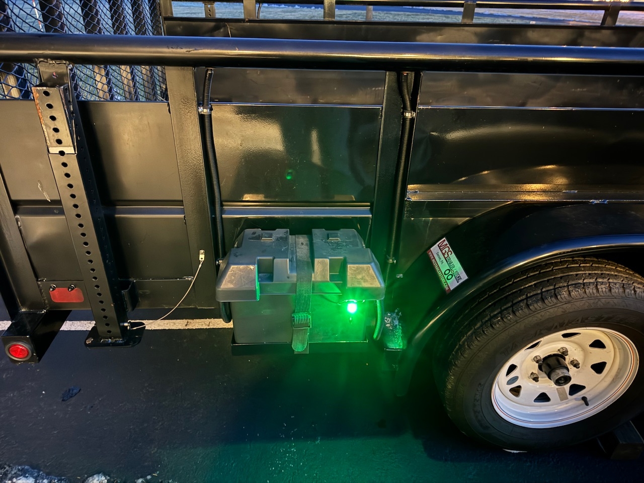

Batteries were relocated from tongue to aft of axles, for better tongue weight balance:

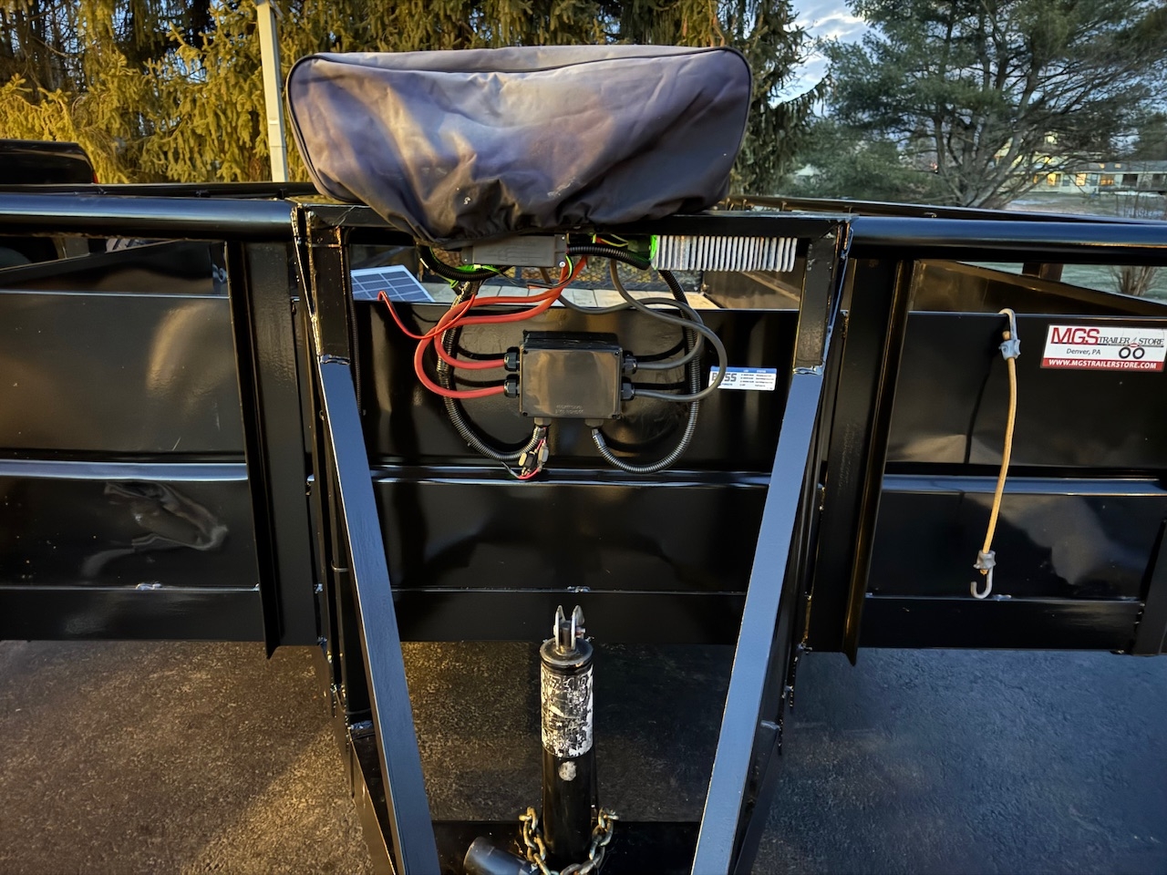

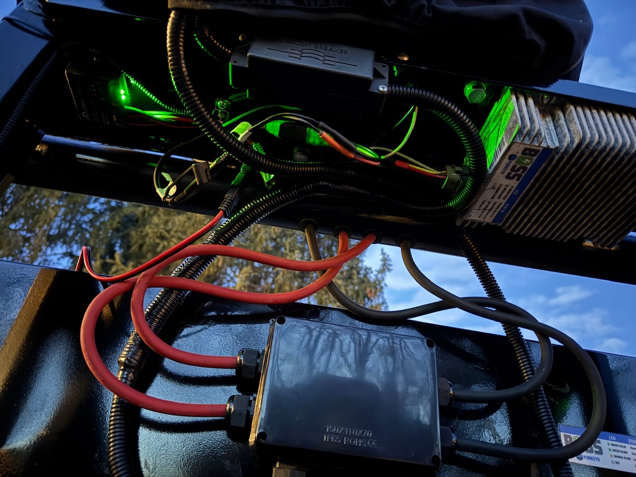

AWG-2 from each battery forward to junction box at winch stand:

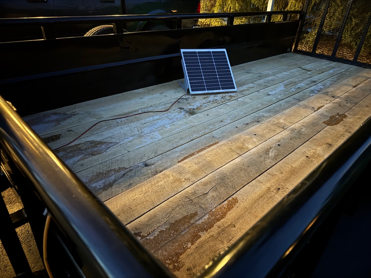

Solar maintainer and battery charger powered from tow vehicle re-wired:

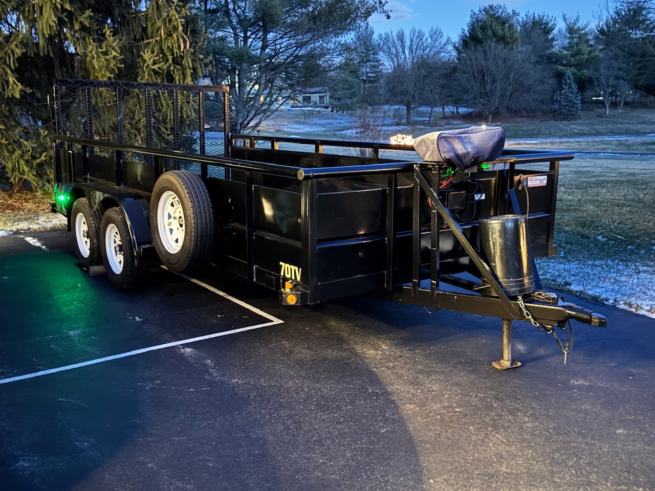

All done, ready to move out of my driveway for now:

@WinterDeere Congratulations! That looks like a great trailer to have around.
Can you recommend a brand of solar panels to use as a maintainer? With our limited sunshine here, I couldn't keep two batteries maintained with a 20W panel during the winter, and had to go to 2x20W. I suspect it is more the panel, than the solar illumination.

Yep, it is a great trailer. I've been using it to haul logs and tractors the last 10 years, now it's refreshed for 10 more!
Like everything, if I could start over from scratch, I'd have configured it a little differently from the factory. But overall, I'm very happy with it.
I can definitely recommend staying far away from Battery Tender brand, I burned out 3 of theirs before switching brands.
I've been using the model linked below the last 2 years, which is about a year longer than any Battery Tender brand ever lasted, and it does a great job of keeping my pair of rather large batteries charged all year. I do adjust the solar panel inclination a few times during the year, but probably don't even need to bother with that, I'd suspect.
